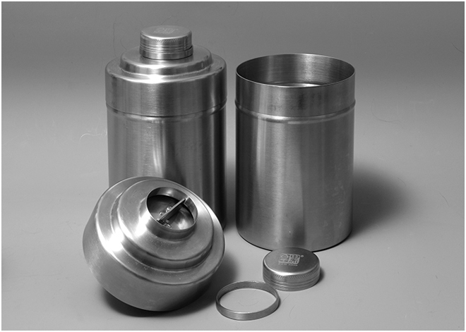

There is also the B/W King stainless steel tank and reel, similar to the vintage Nikor setup.
I used one for a while, and subsequently changed to the Stearman Press SP-810 tray setup, (3 of them!), since I have been shooting more 8x10, and they do triple duty...4x5, 5x7 & 8x10.

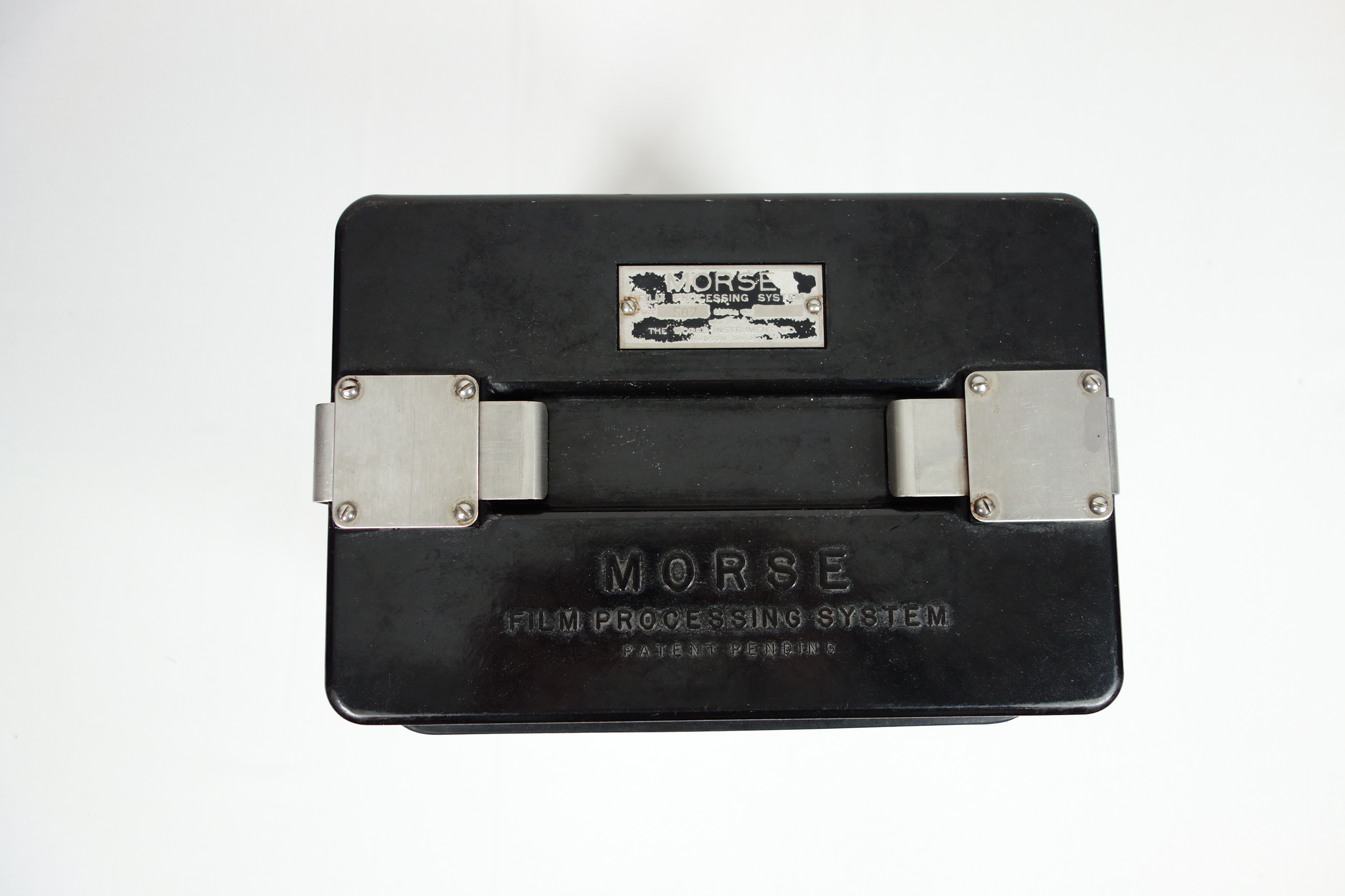

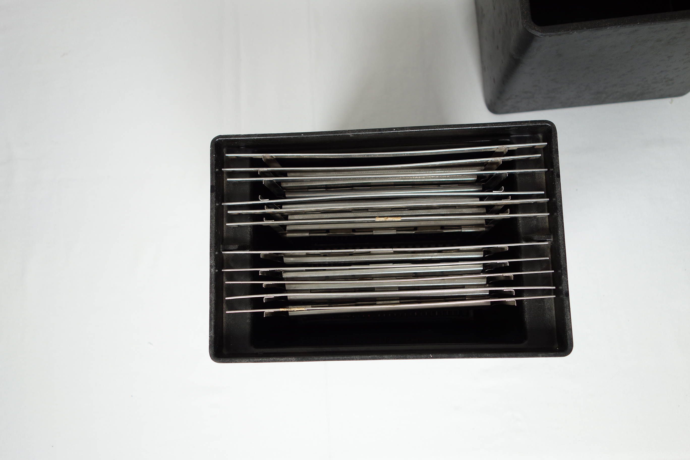

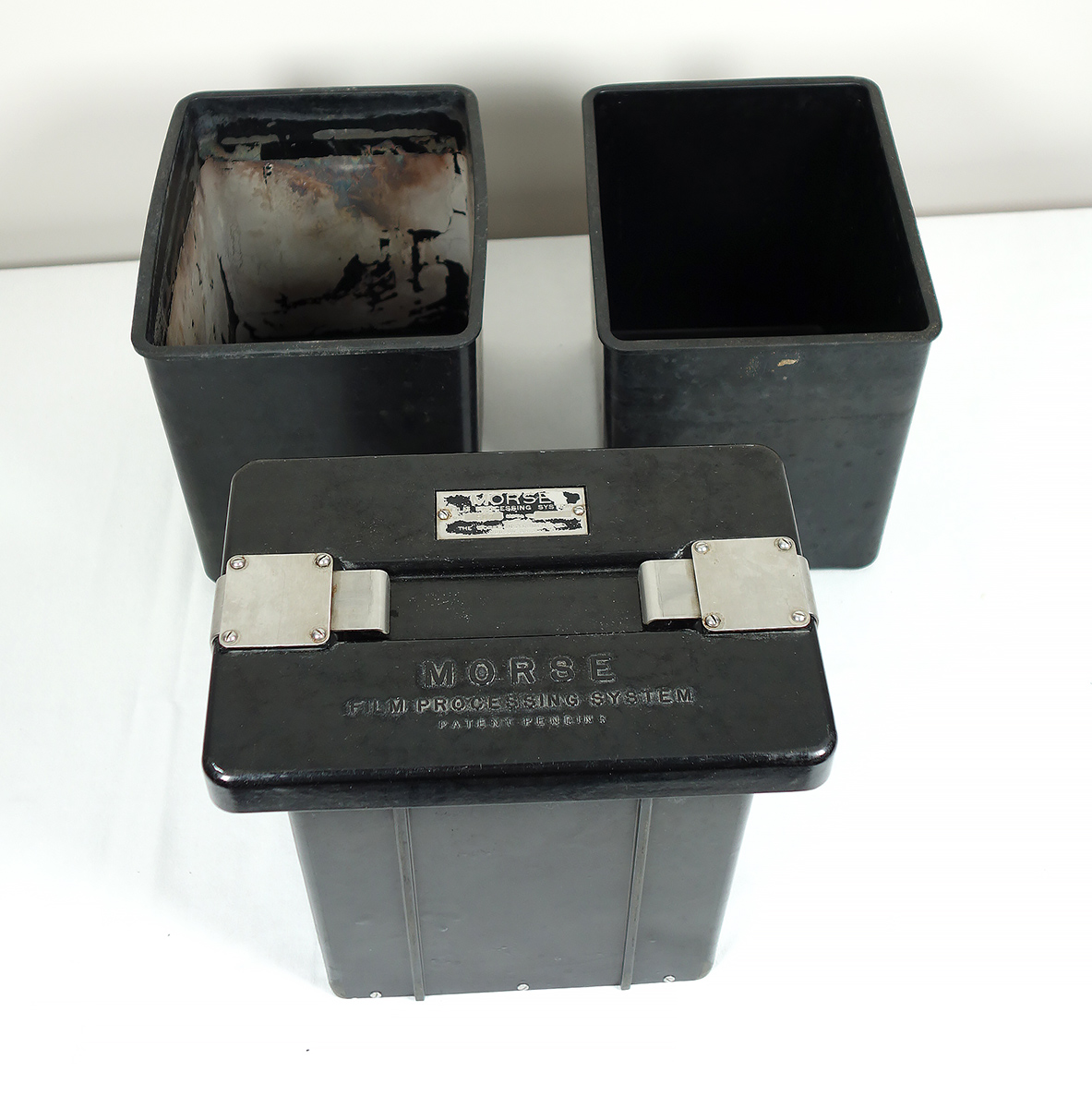

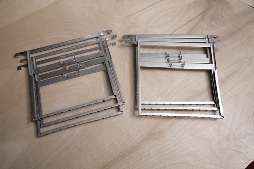

Well just for the sake of completeness, there is the Morse 5x7 daylight processing tank system that uses the normal 5x7 Kodak film hangers. The light baffle that the chemistry flows through is at the bottom of the daylight processing tank, just dip and dunk! Biggest drawback is the amount of solution needed for each tank.

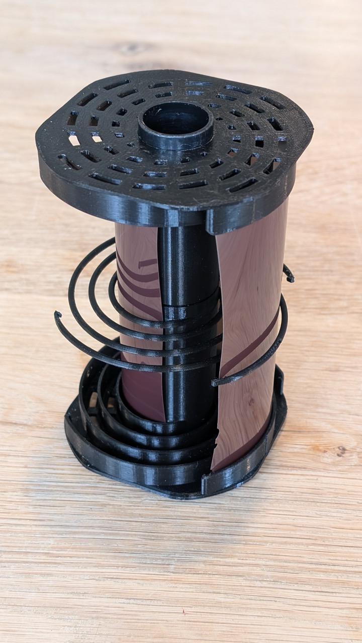

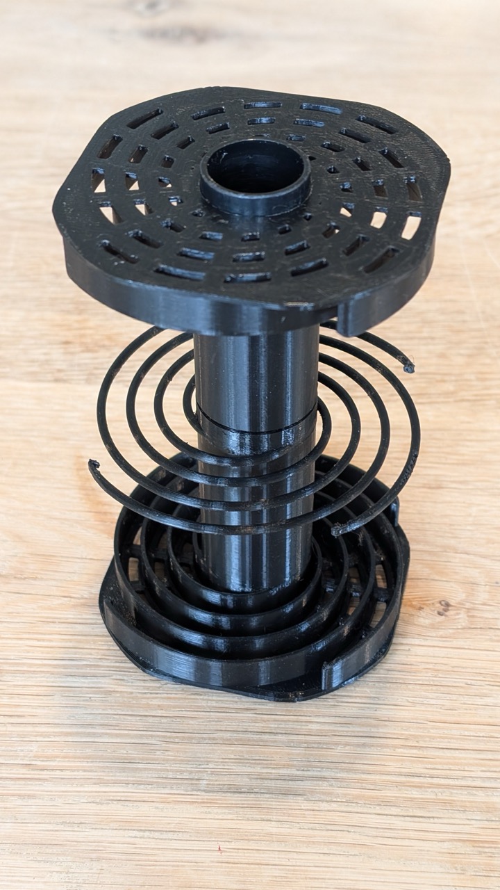

I found a 3D design for 4 sheets of 5x7 in a Paterson System 4 tank (1L capacity). I printed out and assembled it. It might work, but I'm a bit concerned that the part of negative closer to the central core might not get enough chemistry flow. It is quite cramped for 4 sheets of 5x7.
Well, as long as you do gentle inversions during agitation, it probably will work.
Might also want to orient the spiral the same way each time so if you rotate it, the chemistry is drawn into the spiral, not pushed out.
I use something similar for 3x4, it works very well actually. As long as you agitate the tank the chemicals will get everywhere. This looks like it actually has around the same amount of gaps in the top/bottom as a regular spiral so I think it should work just fine.
You are right. I just did a test run with Foma 400 in F76+ 1+9 dilution last night: all four sheets developed nicely and evenly. I used inversion, and there is no pop-outs. 1L chemical for 4 sheets with manual agitation, not bad at all.
I'm fairly confident that I can do color processing (C41, E6) with this reel as well.

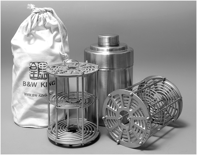

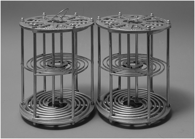

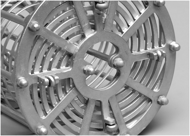

B&W KING 5x7' Format Stainless Steel Film Developing Tank
5x7 Inches specifications of film,It will hold up to 6 sheets at a time
height: 195 mm
diameter: Ø110 mm
capacity: 1350 ml
weight: 1320 g
