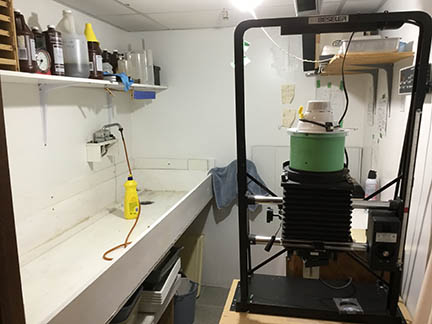

Why not? I have a 60SF darkroom with a Beseler 45MXT for 30 years. Works great.

Here is my 48 square foot darkroom with a Beseler 4x5
