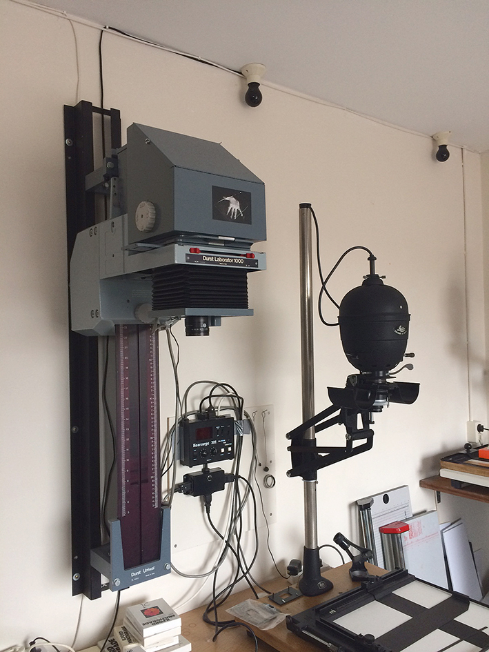

What would be best is you find a very complete one with spare bulbs. Mine is against the wall, using the Durst wall mount and gives me beautiful 20X24 prints. I took two years to get it complete.
a sturdy wall mount is a very valuable addition to any enlarger DIY versions work if not available from manufacturer but. they make a big difference in enlarger sturdyness.

I do have a pdf of the L1000 manual but it is too heavy to upload here. Send me a pm with your email address and I will send it to you . . .
Here the L1000 I have
