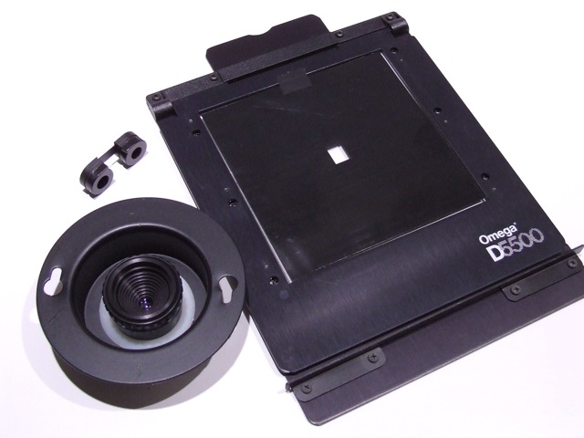

ic-racer
Feb 25, 2007
16,719
USA
Didn't we have darkroom portrait with D5 set for Minox, btw?
I have no problem to print 35 with D5.
My Minox setup.
