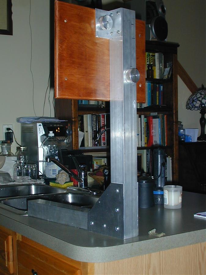

I also want to post a pic of a vertical mounting bracket, since this issue comes up often with banquet cameras. As 5x12 is relatively small it's not a complete horror to mount it this way, but I still get a little pale. The idea was stolen outright from the Lotus VMD, btw. I got the idea for the parts from Kerry Thalmann's arca-conversion- he found 8020 surplus on ebay, aluminum extrusions, very cool stuff. They have all sorts of different profiles, brackets and angles in all manner of sizes, like a tinkerer's erector set.
The bracket mounts to the tripod head by way of a 3/8 thread coupling nut that's mortised into the aluminum and is locked and secured from above with a 3/8 bolt and lock washer. The camera attaches with 2 1/4-20 screws to keep it from spinning. I use a 3/8 screw on the Reis head for regular mounting, but only had the 1/4 20 knobs on hand so used them and threaded two matching holes in the camera's mounting plate. (That's the jr tilt head, btw, and it's plenty strong enough.) The knobs are captive, which means you can loosen them without fully removing them from the bracket and thus promptly loosing them. I simply fed some retaining nuts into the hollow parts of the bracket that keep them from unscrewing completely out of the bracket. Hope that makes sense.

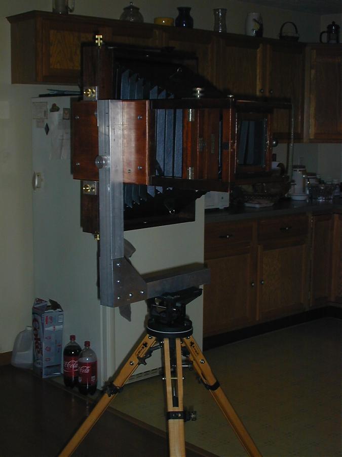

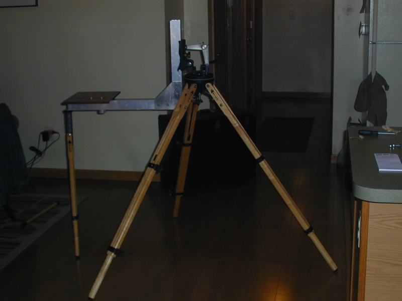

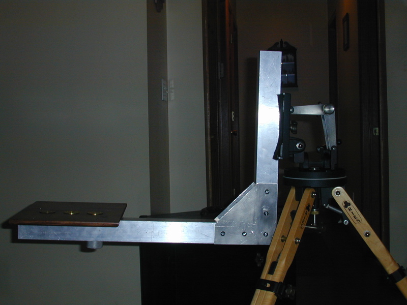

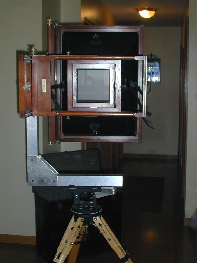

Here is a verticle mounting bracket for my Korona 12x20. The wooden plate was added to make the bed and front extension more stable. The 12x20 Banquet's bed is bolted with 2 bolts and an additional 2 bolts bolt the front extension rail.(there was a url link here which no longer exists)

Oops...sorry. I realize this thread is about 5x12. I just wanted to comment on Colin's bracket. These L-brackets work very well and keep the camera centered over the tripod. I wouldn't think of turning that old Korona on its side without it.
I appreciate you posting yours, Robert. Always great to see different takes on things. Looks great. Do you mount the bracket on the tripod first, then the camera? Or put the camera on the bracket and then put it on the tripod? You have my utmost respect for doing this with a 12x20!
Colin, We just finished the bracket last week so I'm still unsure if I have found the best way to mount this as of yet. What I'm doing now is mounting the bracket to the tripod head first then mounting the camera. I index the head 90 degrees after the bracket is mounted then I mount the camera to the plate. Now when I'm doing this by myself the bracket has the camera so far boomed out over the side of the tripod that it really concerns me. On a flat even floor it will hold it but I use a monopod as assurance if I'm working alone. I'll post a few pics. Roberthttp://www.apug.org/forums/attachment.php?attachmentid=10309&stc=1&d=1206551238http://www.apug.org/forums/attachment.php?attachmentid=10312&stc=1&d=1206551607http://www.apug.org/forums/attachment.php?attachmentid=10313&stc=1&d=1206551711

I think what I may do is shorten up the vertical arm. I could do without a couple of inches of clearance. But I would still use the monopod when mounting this way for assurance. Robert
Looks great! That's a good idea about flipping the bracket over 90 degrees to attach the camera, I'm going to try that my next time out. I'm letting alot of shots go because I'm still a little uncomfortable with my routine for verticals, so this is great. Thanks.
Colin, Once to have the camera up into position you can easily rotate the camera and bracket around to put you back into position on the head for forward tilt. My next move is to make 4 knurled knobs for the 4 plate mounting screws. Using a screw driver is just an additional move that can be eliminated.

Mark, The bracket with plate and all the mounting screws weighs about 6.5-7lb. Now this is according to my high tech scale. (bathroom scale). This is made with 2" O.D. aluminum tube. I think it is somewhat of an over kill. You could hang a Volkswagon on its side with this. I'm sure 1.5" tubing would work just as well and maybe save you a few onces. I have come to the conclusion that when you start getting into cameras this size you have to accept the fact that things are going to be heavier. Robert
I better post a disclaimer here. I use to work in a tool and die/fabrication job shop many years ago. But I can't take a lot of credit for the work that was done on the 12x20. I have a friend who is a retired NASA engineer that happens to have a pretty well equipped workshop, complete with bridgeports, engine lathe, ect...ect. If you look carefully at the 12x20 you will see all new hardware for the rear focus assembly and the rear swing. The rear focus assembly was missing when I bought the Korona and someone had just run wood screws through the frame into the bed. He machined all those parts and even realigned the gear tracks. This thing works as good as new. Although all it takes to make the bracket is a drill press and a saw the knurled knobs were made on the engine lathe. If anyone is interested in him doing any work, he is a great guy. And he will not take payment until you have it in your hands and are satisfied with his work. I would much rather see him make a few bucks to help pay for his hobby than I would want to put the time into making a bracket. I'd rather burn film. Robert

I wonder if the 8020 extrusions would make it any lighter? Mine's under 2 pounds and if it was a few inches longer would easily hold a larger 25lb camera; the stuff is unbelievably strong. It might cut the weight in half or better. What gauge did you use to make it?
Colin, You can definitely go with a thinner wall and smaller tube. And cut out a lot of weight. This 2" looks to be at least .090 or more like .125 wall. This is what you get when a NASA engineer decides on the material. Of couse I told him I wasn't worried about weight so much. So I can gaurantee there is no flex whatsoever in this bracket. This camera won't go over 100 yards from as far as a two wheel cart will take it. If I have to carry a camera for any distance I have an 8x20 that weighs 14lb and that goes if it has to be carried. Of course these old Korona 12x20's weighed just under 20lb. You are right though, when working in ULF a 6.5lb bracket seems light. Words like porter/phot assistant/ATV/pack mules/4 wheel drive are used more the older you get with ULF. If I was going to do it over I would go with 1.5" tube and thinner wall. You could probably cut 2lb off easily and still be strong enough to hang a heavey camera. Robert
