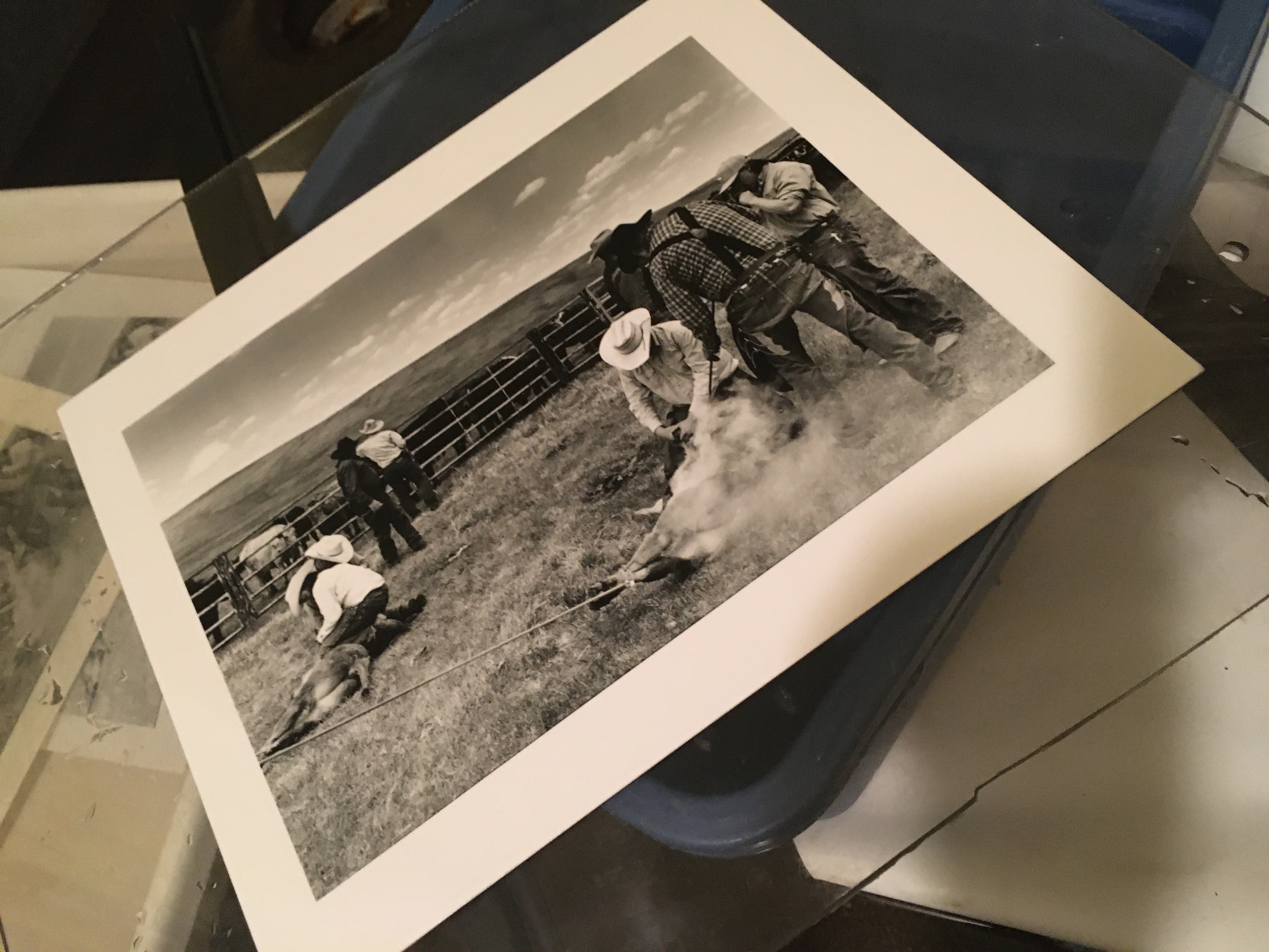

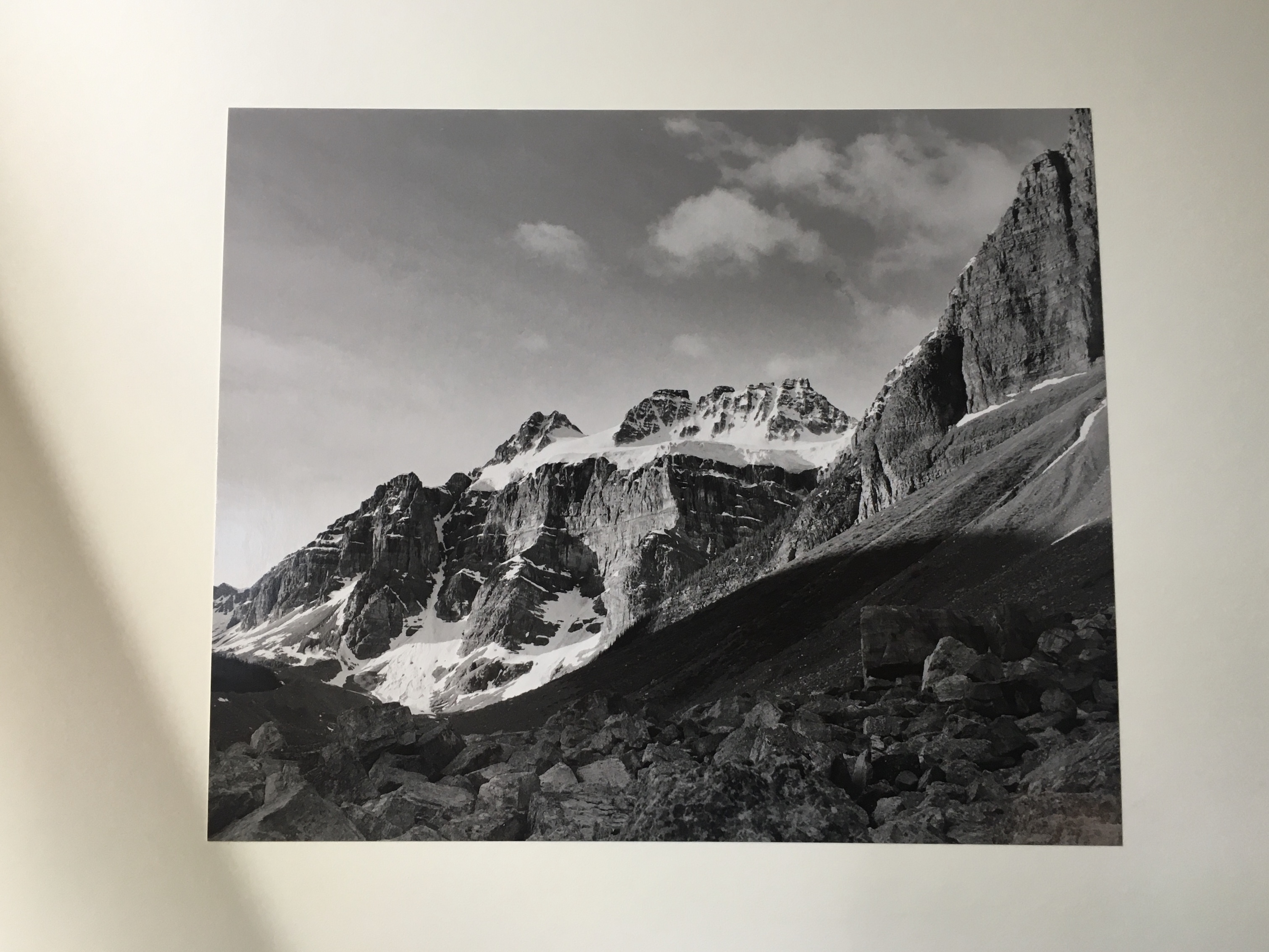

T, i can't offer a solution other than what's been said about exposure & agitation. But i've used Pyrocat since it was introduced (before that i used PMK) & it is my standard developer for anything. Here are two examples of Tmax (400 & 100)
w yellow filter processed in Pyrocat HD and wet printed. Lots of mid tone separation.
T, i can't offer a solution other than what's been said about exposure & agitation. But i've used Pyrocat since it was introduced & it is my standard developer for anything. Here are two examples of Tmax (100 & 400)View attachment 415742 w yellow filter processed in Pyrocat HD and wet printed. Lots of mid tone separation.
Greg,
That ought to answer any questions as to whether or not Pyrocat-HD is any good or not. That said, I bet you'd do well with 510-pyro also. Love that mountain scene! One thing we lack in Michigan is mountains. Plenty of water, but no real mountains.
