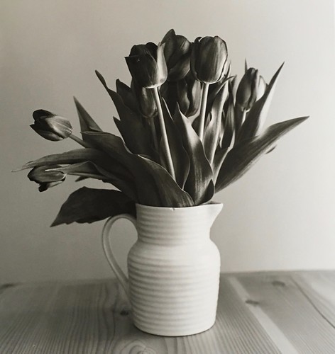

Lorenzo, I've used PMK and Pyrocat HD for decades now. Buy the Pyrocat for 25€ and try it. I have never had the desire to look for something better.... (50cm x 50cm print)
