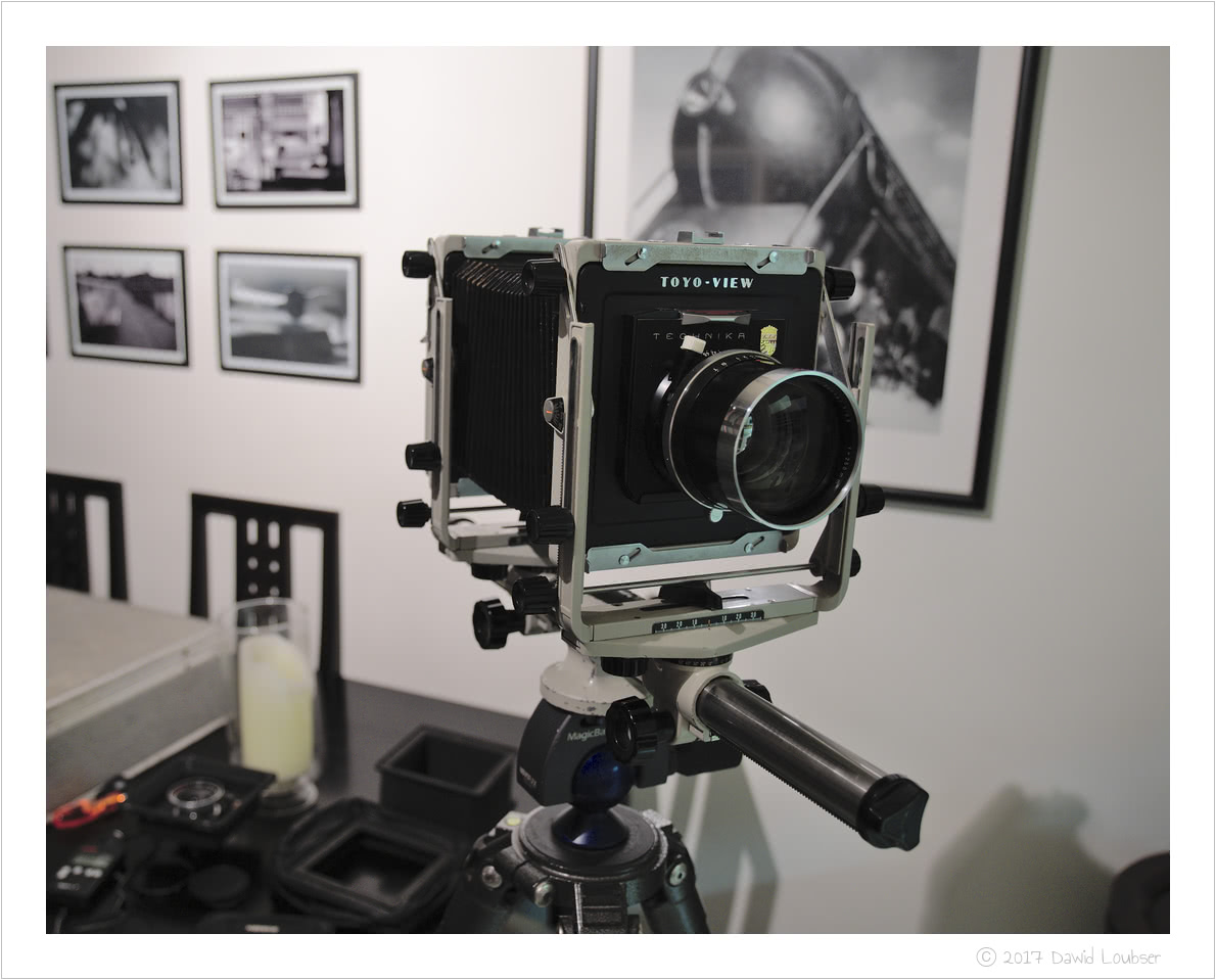

One of the best photographic investments I've made, was to buy a big Gitzo Carbon Fibre tripod, now more than seven years ago. The rigidity is far beyond any Aluminium tripod I've ever used, and if I don't lose it, it will last me a lifetime.
You just can't go wrong. Mine is total overkill for hiking, and much more stable than what my biggest 4x5in camera requires - it would handle a big 8x10 with ease. Like many others have said - don't ever get a centre column - just put a nice ballhead directly on the tripod.
I see from the picture that you have a MagicBall. Neat. How does it work in the field compared to the standard ball that sits in a cup on the bottom? I only once looked at the Magic during a trip to New York, but never tried one in the field with my equipment. Thanks for hints.
