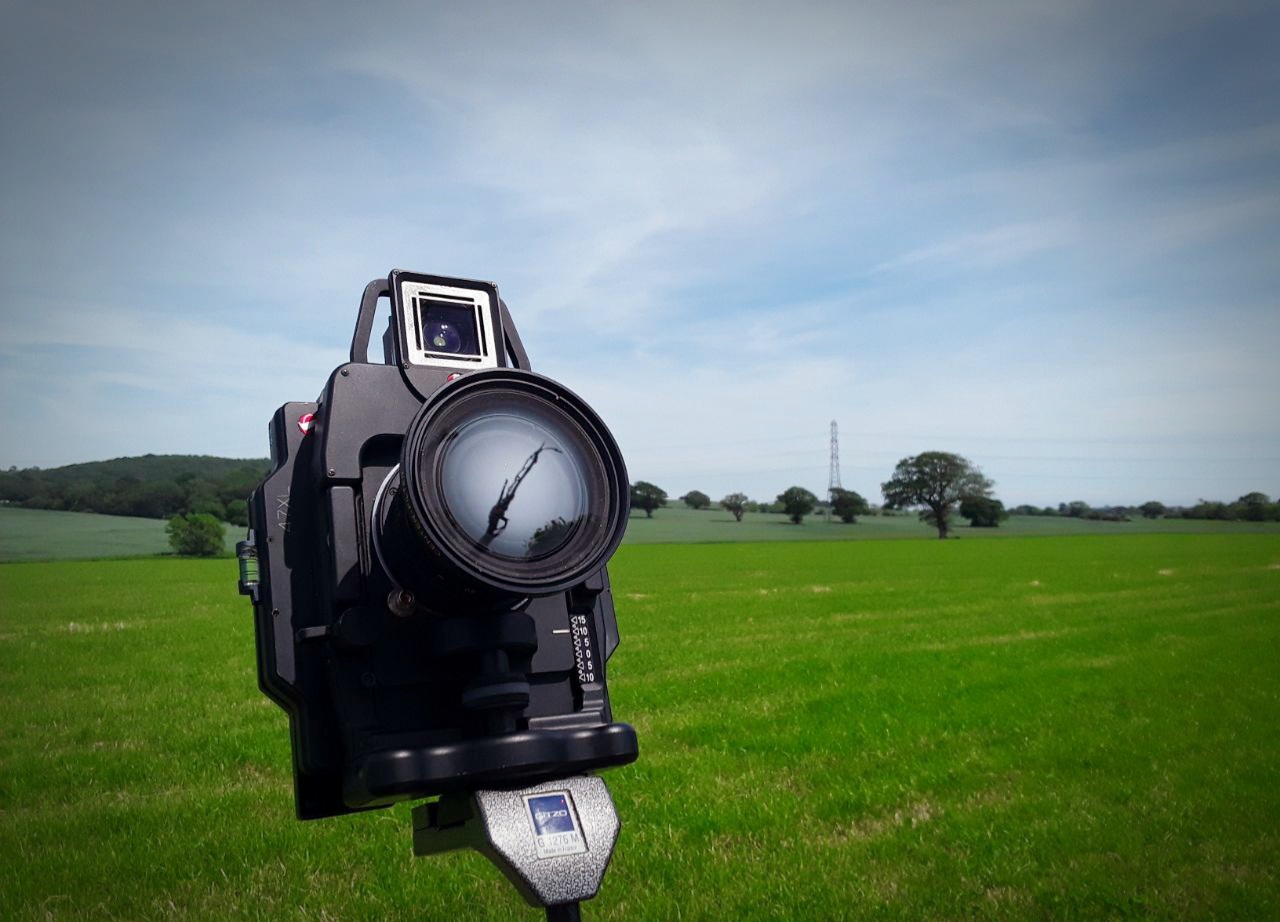

There are a few of us Silvestri camera users - mostly based in Europe like yourself. There are a few comments in this thread where the respondents need correcting :smile:
I've used the S4 - and it's anything but handhold friendly. At nearly twice the weight and bulk of the Silvestri Hermes, it was never designed to be swift and light like their ultraslim H models (or even the earlier T30s). The Silvestri H was designed for working photographers, particularly specialising in wide-angle photography: Schneder Kreuznach Super Angulon 47mm XL, 58mm XL and 65mm Angulon or Rodenstock 65/4 which all can be still custom mounted in a Silvestri helicoid bayonet mount. But not the 90 XL. If you have any standard lens, you can still contact the Silvestri factory to mount it correctly.
The comments about +40mm rise extend beyond the available image circles of these lenses for 5x4 inch format. For 6x12 inch and smaller formats, the +40mm rise is useful: most of us Silvestri users find the 6x9cm film back useful for that purpose.
Front tilt is redundant: it is not the most important movement. It is the least important movement for these portable ultrawide shift cameras. For a 47mm XL lens where near everything a metre in front of the photographer is in focus. Silvestri did make an elbow joint type front tilt socket adapter for the 100mm+ focal lengths although I have never used one.
It is similarly not correct to assert that shift cameras only have one movement at a time. The Silvestri Hermes, T30 series and the S4 all have the ease of cross-movements at one swift touch. You cannot do cross-movements on a view camera in less than 5 seconds which the Hermes permits. This combination of vertical shift and lateral displacement is done simply by rotation of the film back relative to the image axis.
With the tendency towards wide angle lenses, the groundglass viewing mechanism becomes slower through dimmness and the struggle to focus particularly on non-specular light sources and night become rapidly apparent. The linked viewfinder of the shift camera is indispensible for rapid composition in the dark. Anyone who has tried to focus a 47mm XL with a Centre ND filter will know how fiddly taking it on and taking it off for focussing is, particularly on the move. Here, you can see the linked viewfinder: the framelines rise in accordance with the shift (bottom right dial) and fall so the composition of the viewfinder matches the groundglass. It is a simple mechanical linkage which allows the various compositional masks to be swapped over. The Silvestri series permits the use of every back that fits the standard 5x4inch Graflok back; 6x12cm panoramic; 6x9cm, 6x7cm, 6x6cm and even Hasselblad A12 backs with the correct adapter.
Lastly, these cameras did not cost a fortune. They are uncommon and the few of us who still use them are mostly in Europe. The cameras paid for themselves after 2 or 3 photo assignments and are extremely well machined and built on a plane parallel military grade bulleted solid aluminium chassis - a real challenge for any folding field camera. Today, they are still cheaper than most of the hobbyist digital cameras which analogue touting keyboard warriors hide behind their analogue ones.

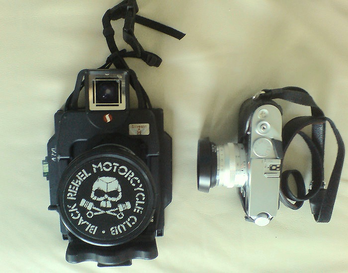

Hi,
Yes the Silvestri Bicam is a completely different tool. The S4 shared more analogue friendly features with the lighter weight Hermes (pictured below beside a standard 35mm rangefinder).
As you can see - the width of the Silvestri Hermes is barely wider than a Leica 35mm rangefinder and taller. LF Shift cameras are very different tools from standard 5x4" cameras: 5x4" camera users think they understand dedicated shift cameras without owning and working with them.
The crash bars don't permit the use of centre ND grad filters with the short helicoid turns becoming very awkward and fiddly. The great thing about the shift LF camera is that it disassembles flat into a briefcase for transport and just requires the lens twisted on to get started.
On the RFF forum and LF Photography forum, there are usually one or two users per year who discover Silvestri T30s or Hermes (H25) models. The T30 is worth looking at since it has a top down chassic table turn reversal capacity (so that shift applied +15mm can become -15mm) which is greater than the Silvestri H with a -10mm shift. An external (non-linked rise/fall) viewfinder exists for this T30 model too.
For use of the 6x12cm 120 roll format adapter on Silvestri T30/H/S4 models, there are 2 routes:
Silvestri Body + Lens + Back Spacer [0,1,2,3,4 depending on focal length] onto either:
6x12cm dedicated roll back adapter + 6x12cm viewing fresnel and leather hoodette
or
via ring spacer [0,1,2,3,4] + Graflok International 5x4 back + Horseman standard 120 roll film 5x4 back adapter. Mask off the area outside of 6x12cm on the 5x4 inch frame or use the grid lines on the groundglass.
The most compact Silvestri 5x4inch set up is the Hermes with the Back spacer Ring 0 + Schneider Super Angulon XL 47mm f5.6 helicoid mounted. This is a true handholdable street photography solution. In the 20 years of shooting, I've only encountered one other Silvestri user though. I guess that's how unusual and off the radar we are....!
