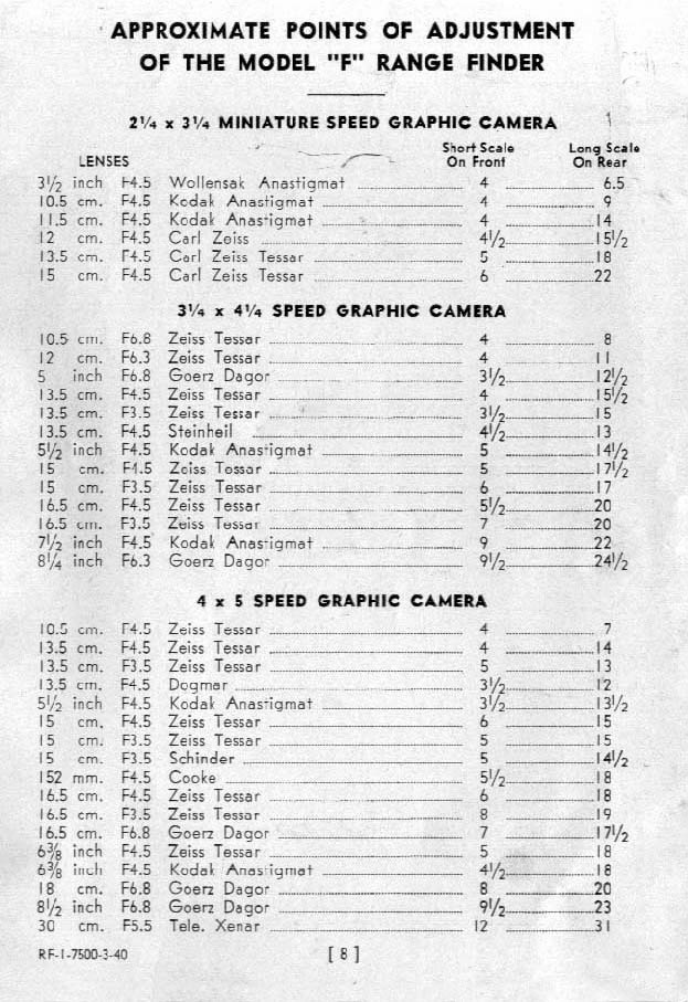

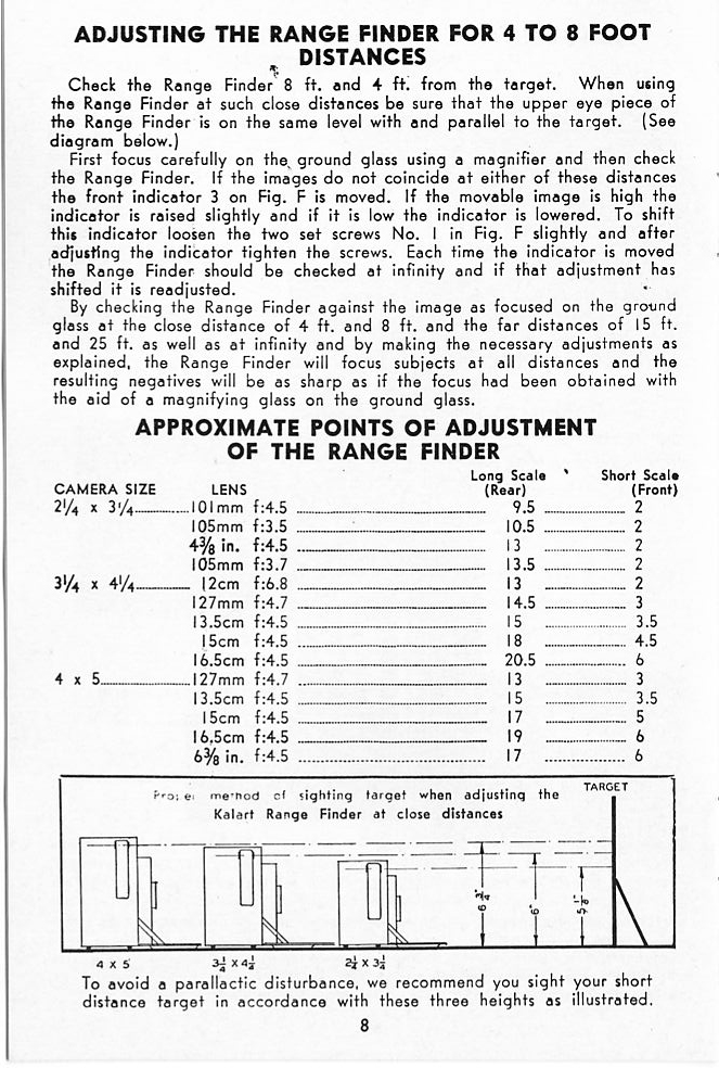

There are accessory rangefinders from the day that fit into a hot shoe or use a similar bracket that mounts onto the camera or can be used handheld.

So with a Graflex way short of a 240mm, the 6.75" is around 171.7mm, so no ragefinder coupling for a 180mm or 210mm.
Bob S mentions some Linhof's can have cams for lenses up to 360mm, but that'ts the Tele-Xenar or Tele-Artar, and shorter 240mm and 270mm Tele lenses. The 360mm Tele-Xenar has back focus (Flange Focal Distance) of 214mm.
