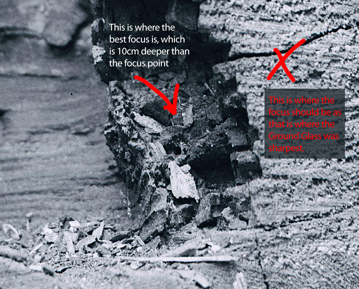

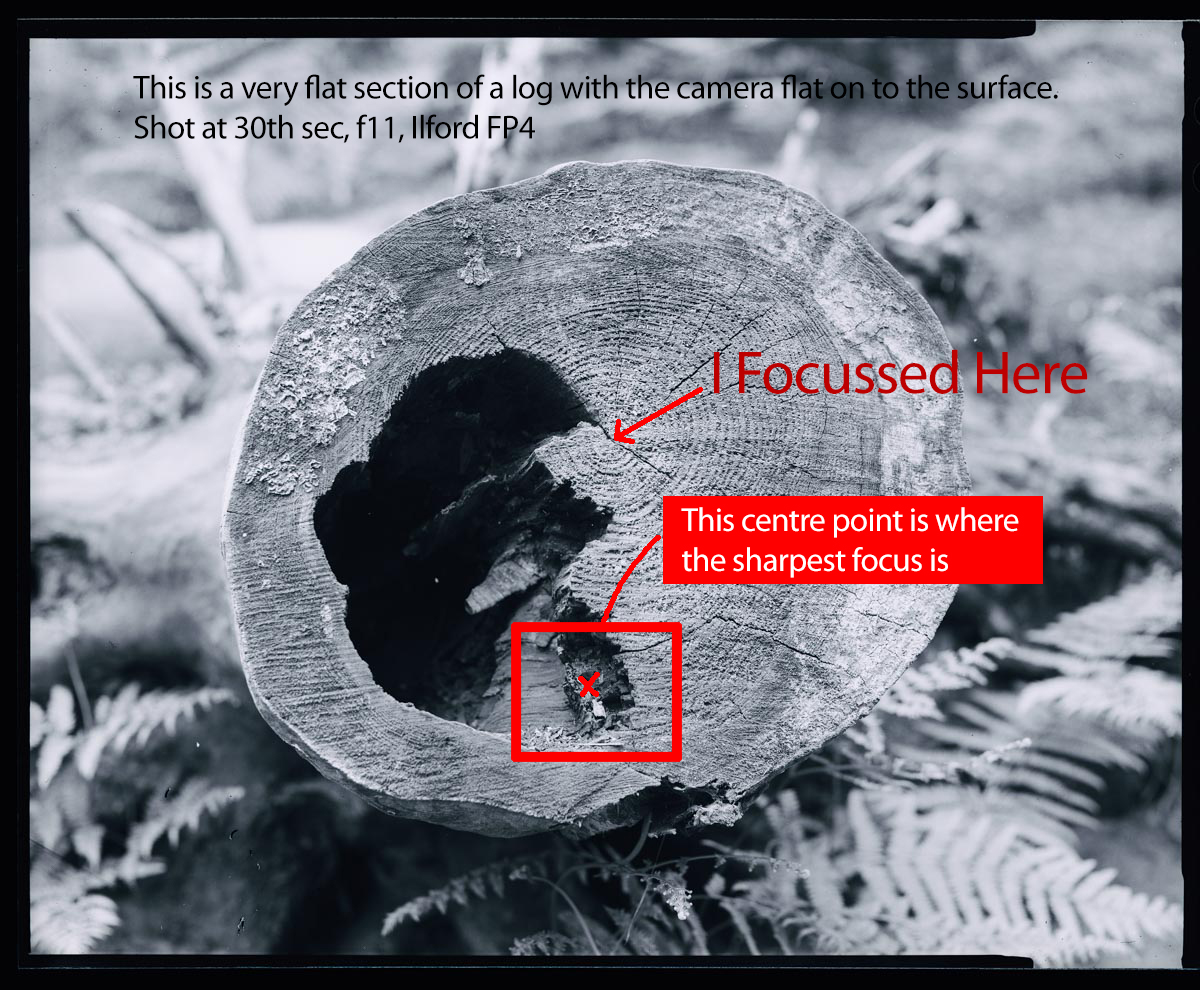

Right I have done a test on a flat surface and I think something is seriously wrong here.
I looked at the ground glass and focussed on the centre of the wood, according to the glass the edge to edge of the wood was also sharp.
the camera tilt and shifts were locked and the body of the camera was flat on to the surface of the wood.
I assumed that if the GG said it was sharp then the holder (Fidelity - that came with the camera) would also be sharp.
I have no clue what is going on here.
attachment.php
attachment.php
Take a look at the pictures and tell me what the hell is going wrong, so far I think I should ask the seller to take it back.

Looks like you are doing close-up/macro work - This will exacerbate any small focusing errors. I have noticed a similar problem with one of my cameras.
Yes, it looks like you do have a focus error, but it isn't as far off as you might think. In the absence of accurate measuring equipment, I'd suggest shimming the GG out using some bits snipped from a roll of film.
P.S. Noticed an error in post #22 - Sheet film is coated on to a 0.180mm polyester base, 120 film is on a 0.110mm acetate base, and for completeness, 35mm is on a 0.125 acetate base. (data from Ilord FP4+ datasheet)
