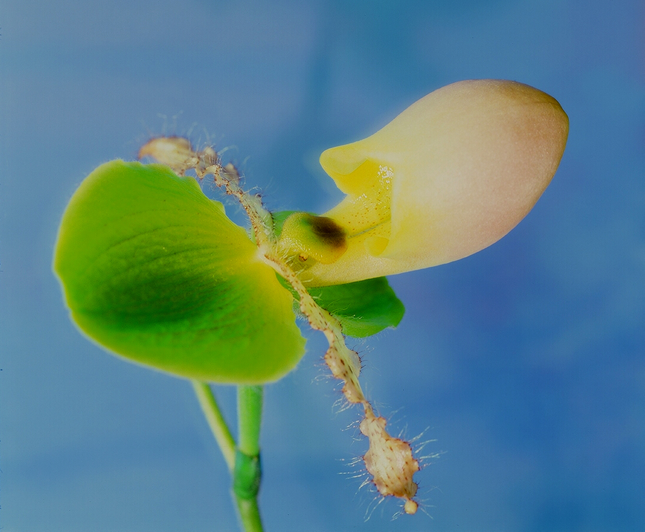

This was taken with a 140mm macro lens for a Mamiya RB67, but given the non-flat nature of this subject, another non-macro variant may have behaved satisfactorily:
