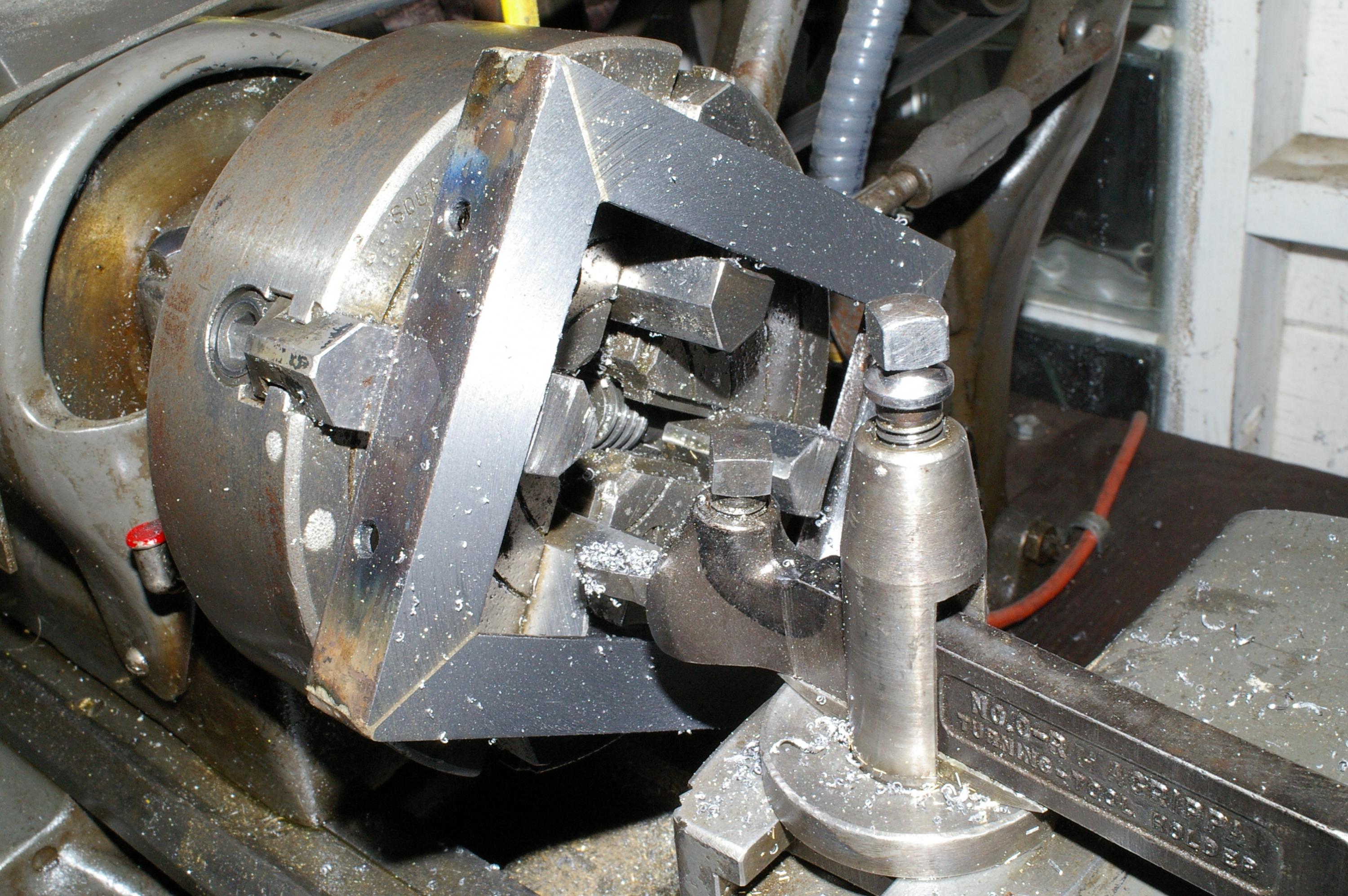

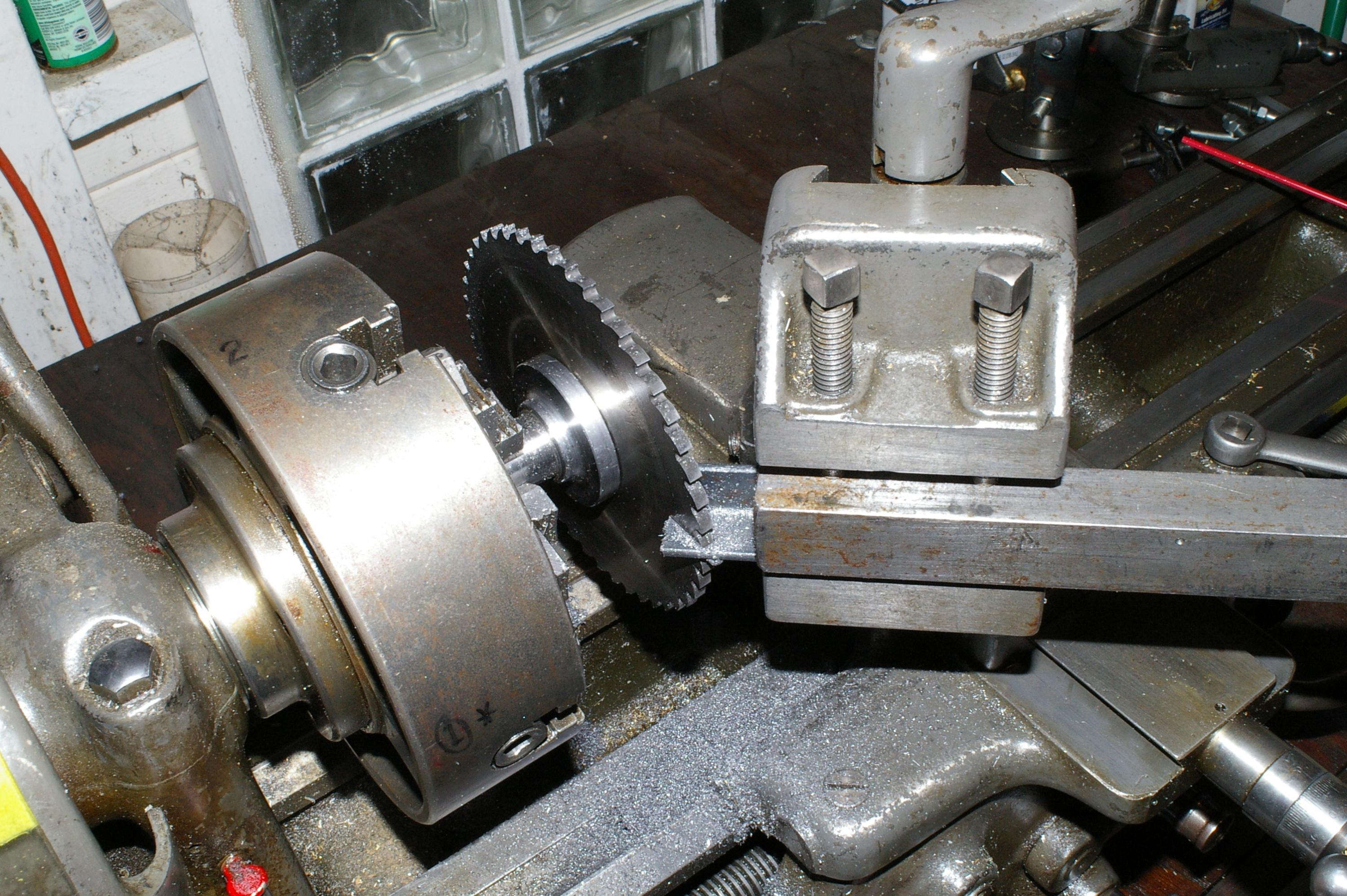

Here are photos of another - fabrication method used on the camera I am working on now.
Ordinary hot rolled carbon steel angle- very cheap.
Accurately mitred to 45 degrees using the lathe and its milling attachment
Silver brazed with oxy acetylene into the rectangle, using a simple jig.
Faced flat to a tolerance of about +/- 0.001 inch (25 micrometre) in the lathe
The consistency of my hand brazing is shown and it was fairly good.
Linished with a coarse belt sander, the appearance of the perimeter is reasonably neat, and resembles the linished Polaroid backs.
At the moment I am stopped, waiting for threading taps.
I broke a M2 by 0.4 tap in a lens board, luckily i got it out without damaging my hard earned piece.
I also have an M7 by left hand tap and die coming , for an idea to use jackscrews.
