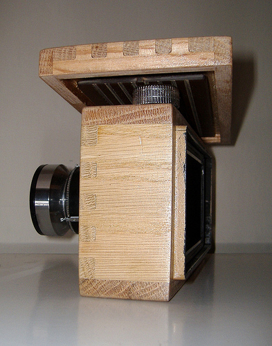

Dan, I believe I did see those photos of your bellows some time ago .
My present camera only has "half of a bellows", that is a single sheet clamped to the body on the periphery, and clamped in a nut on the shutter thread on the other.
I made it from a composite of iron-on wet suit repair patch on the outside and Protostar flocking on the inside.
I had 2 concerns. One that it was not completely opaque, when viewing a 500 W tungsten , there was a deep red glow coming through. ( although it did not fog Fuji 160)
The second problem was that it was not quite flexible or conformable enough. So I stretched it to destruction, when the fibre of the wetsuit repair fabric let go before the telescope flocking.
( Edit error, it was the flocking that failed with radial cracks)
So the next trial is to be of the thick black plastic that Ilford paper comes in, sandwiched to the flocking with a hot iron.
I want to try to somehow pre-shape it to have a bowler hat shape.
Perhaps in the oven while wife is away...

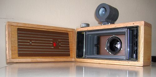

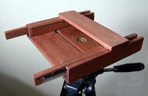

When I first learned how to use it, I made a 6x12 camera with it:

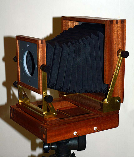

And I currently have a folding 5x4 camera under construction (nearly finished!).
Steve.

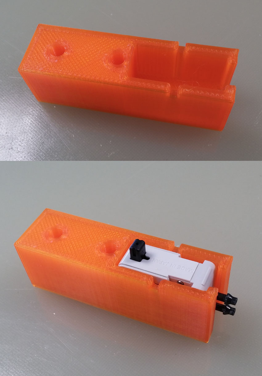

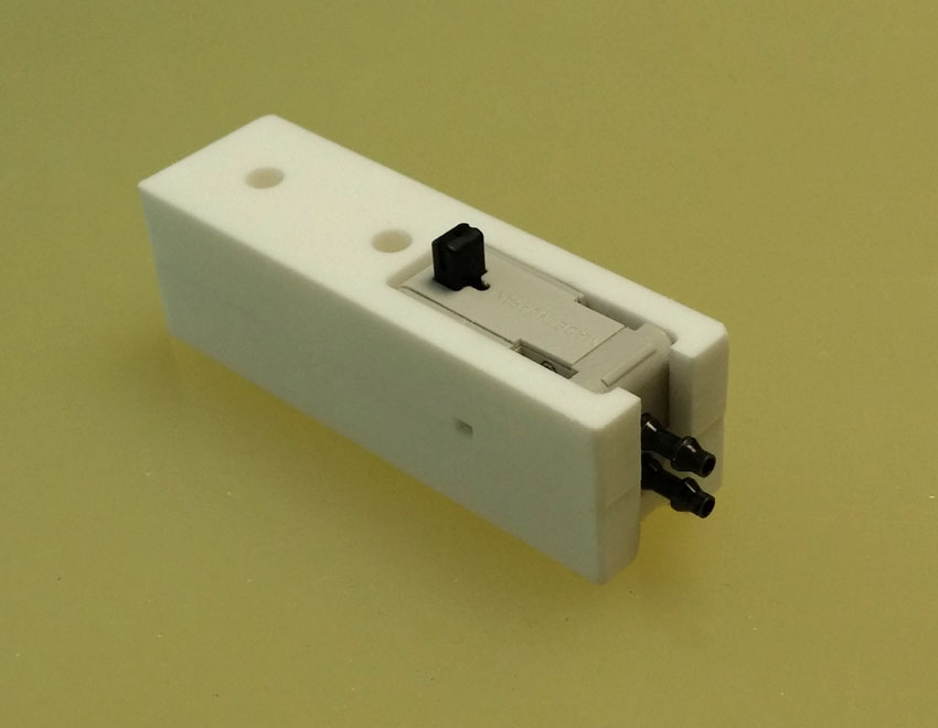

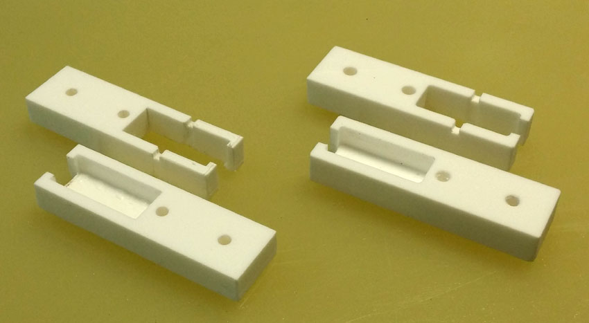

A laser cutter generally works in two ways. Either it cuts linearly in vector (lines) or it can raster etch solid areas. I can use our laser to make 3D objects using a combination of raster and vector cutting - and regularly do.
To back up my claim, today I did an experiment.
In the first picture, the two pieces to the right were made with a CNC router. The two pieces on the left are the same design but made with a combination of raster engraving and vector cutting with a laser cutter.
My preference is for the CNC cut parts as they require much less finishing off the machine (none really - just filing off sharp corners). However, if necessary, with a bit of extra work with a file, the laser cut parts will work fine too.
The second picture shows the intended use for the pieces. It's a bracket/holder for a pneumatic microswitch.
