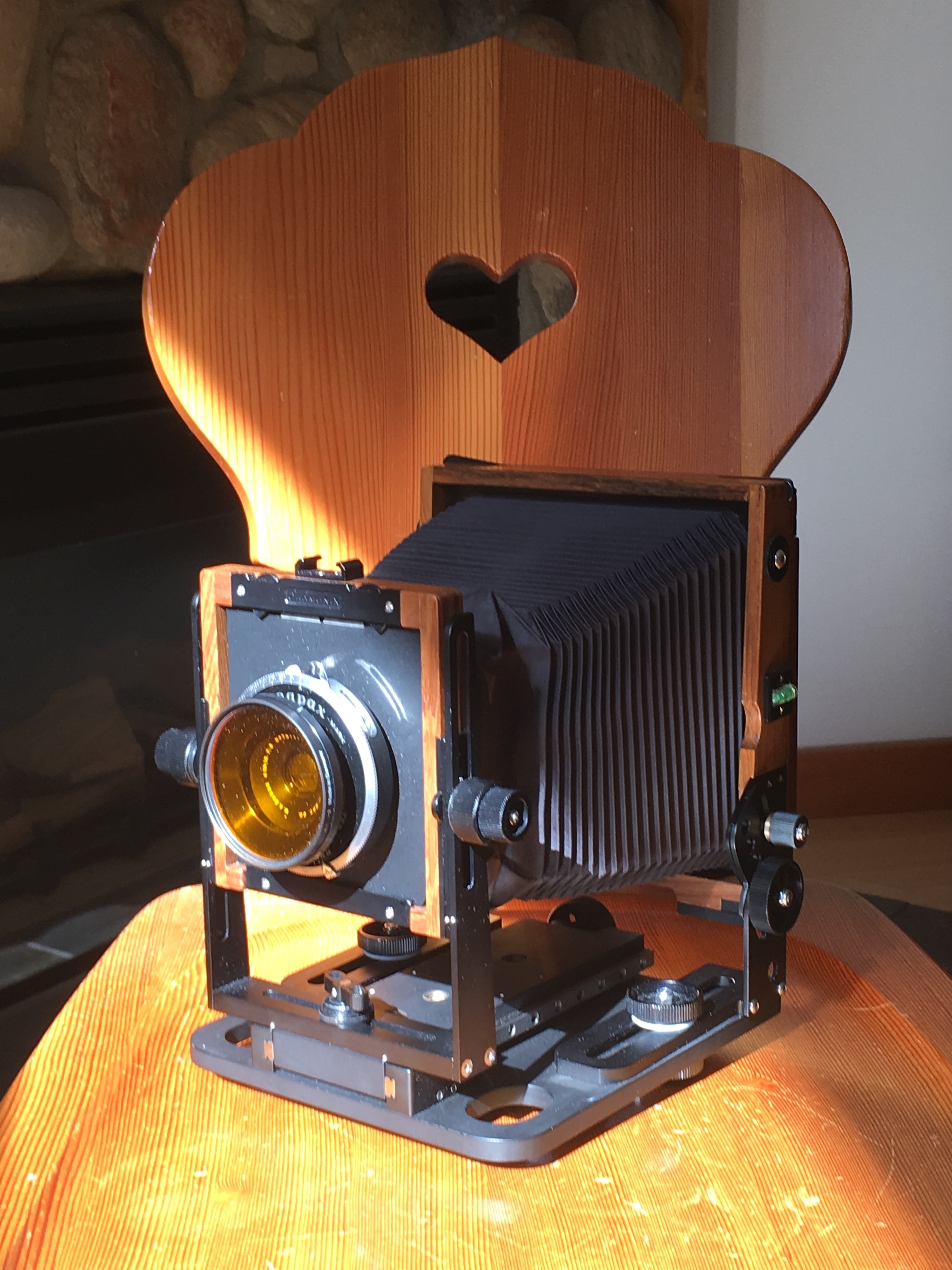

I really like the Toyo 45CF. It's a carbon fibre camera, and what is nice is that is can be folded up with a standard (150mm) lens attached and the lens is protected within the hard shell. It makes using and putting away the camera fast and easy.
It's quite light too, and has most movements. I've never felt limited by it's movements.

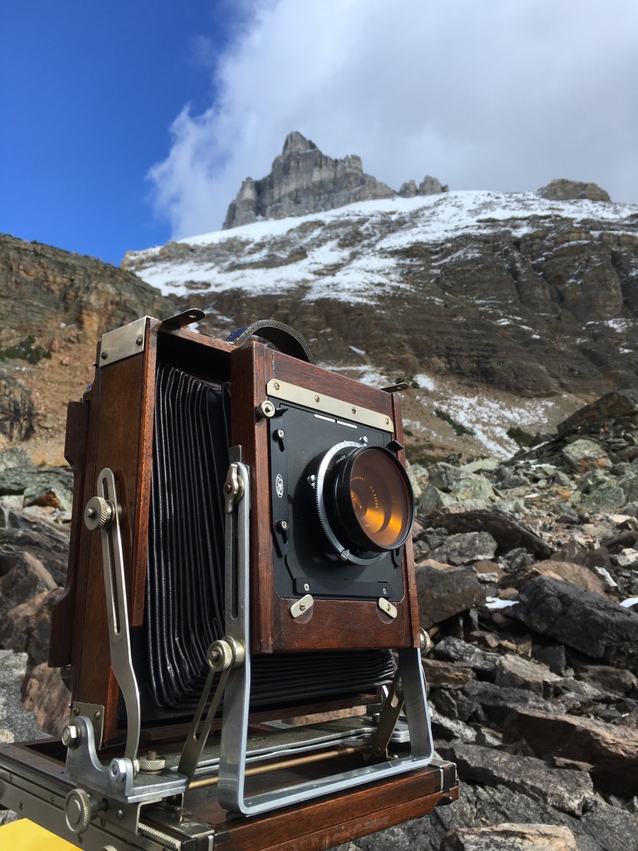

I have both a press camera and view camera. I usually take both, the Crown for hiking and the view when shooting off the road but close to the SUV. My view is very light but not compact, it is a Brand 17 View, made in L.A after WWII from melted down aluminum from surplus aircraft. It has good movements and a rotating back, I don't think one replaces the other.
I had a Brand 17 for a short while until I upgraded to a Graphic View II. I think the "17" in brand stood for melted down B-17????🤔
It is a very odd camera, the 17 was for 17 inches the length of the bellows, there are extension for the rails that allow for use of long lens. It has pretty good movements. Considering that it is now 76 years old, it has held up.
Yes, I was just making fun of the old B17 scrap yard thing. Mine was certainly built will, but a little bulky. With a normal monorail 4X5 it could be broken down to just a rail and the standards and bellows if needed. The dual rails on the brand made it sturdy, but less compact.

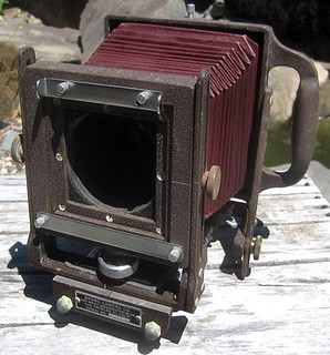

Another very good candidate is the Busch Pressman or Sears Tower 4X5. The Tower 4X5 was my only 4X5 for many years, after I sold the Graphic View II, I liked it better than the Speed Graphic. Built very well, nice rangefinder and handle all my needs in 4X5 until I bought a Toyo field camera. The Tower 4X5 was a dream with the 135mm Symmar-S mounted on it and synced with the rangefinder. It took smaller lens boards than the Graphic cameras, but if you use lenses like the 203mm f7.7 Ektar or Fuji's smaller size lenses you're fine. They can be fairly cheap and to me, are a bargain.
