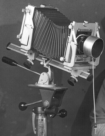

That's amazing. Which one?
a Toho FC-45A. There aren't many of them out there. Here was a Japanese auction:
And a picture assembled:
