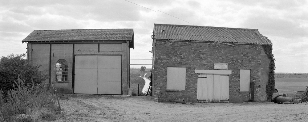

A few years back, I was interested in stitching frames together to achieve a sort of poor man's Xpan vision of the world. My line of thought was that if a 43.2mm lens theoretically gives natural perspective for a 36x24mm format, a 40mm lens should be close to ideal for stitching frames together. That was obviously wrong, as you can see from the overhead cable on this stitched image. I don't know why it was wrong, though. Any thoughts?
Rollei 35 Tessar, Ilford Delta 100 in Tetenal Emofin

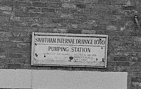

Incidentally, the resolution of that little Tessar lens is pretty darn' good.
As a rather simplistic explanation, if you rotate the camera and lens, objects toward the edge of the frame will not line up exactly. The effect will be more pronounced with shorter focal lengths than with longer, even if you keep the subject image size the same.
If you keep the film on the same plane in both photos, by shifting the camera or lens sideways, the objects will line up better.
Ah, OK, got it! Thanks. Shifting the film plane sideways accurately could be rather tricky in practice.
Wasn't there a special panoramic tripod head made by Rollei for their MF cameras, made to allow accurate location of adjacent frames? How did that work, and why did it not suffer from the problem described?

snusmumriken
r_a_feldman
As a rather simplistic explanation, if you rotate the camera and lens, objects toward the edge of the frame will not line up exactly. The effect will be more pronounced with shorter focal lengths than with longer, even if you keep the subject image size the same. If you keep the film on the same plane in both photos, by shifting the camera or lens sideways, the objects will line up better.
Diagnosis correct. Remedy not.
Diagnosis is correct. A camera (a normal one, see below) projects the 3-d world onto a plane. If you rotate the camera, you change the plane, and the geometrical transformations do not match. Yet in all cases, straight lines in the world are mapped to straight lines on film. Won't go into more details, would require preparing figures, and even so... The laws of perspective are known since Alberti and a few other worked them out in the 15th century.
Remedy (move camera with film in same plane) is not. Demonstrated with a counter-example. Imagine there is a house on the right of the field of view of the first picture; far enough to the right that you see its left-side wall. Now move your camera to the right, keeping the film plane parallel, until the house is in left of the viewfinder. Now you don't any more see the left wall of the house. How could you possibly stitch these two images together?
snusmumriken

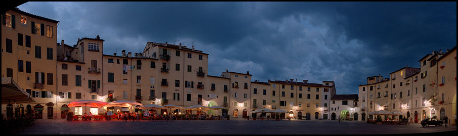

Go back to the camera in a fixed place, "just rotating" between frames. Take overlapping pictures (1/3 of a frame overlap recommended). Feed them to a piece of software called a pano stitcher. The software will "undo" the projection from the (two or more) film planes onto a sphere (as above, don't ask for more details), and, from the overlap areas, figure out how the images should be positioned. It will also figure out more subtle things, like the distortion of the lens; I mean true distortion, as in pincushion of barrel, not the "distortion" of wideangle lenses. Once the images match on the sphere, the software will re-project them onto...
  • A plane, effectively providing the picture that you would have obtained with a view camera. You can choose that plane, giving the equivalent of shifts/tilts. Or...
  • A cylinder, effectively providing the picture that you could have taken with a Horizon or Noblex camera.
  • Several other options.
And, what is meant by "just rotating" between frames? That the camera stays at the same place. But which part of the camera? If you rotate the tripod head, the front lens will rotate and move. So we have to a small degree the unwanted effect described above in the example of taking a pano of a house by parallel shift. Over the internet, so many experts state (parrot) that the nodal point of the lens is what must be kept fixed, while truly it is the entrance pupil. What is the entrance pupil? stare into the front of the lens, with the diaphragm partly closed; the entrance pupil is where the diaphragm appears to be, as seen through the front group(s) of lenses.
This issue of what part of the camera must remain at a fixed position is significant only if there are nearby foreground objects.
Pano software (just example that I have used): PTGUI (shareware), Hugin (freeware).
Example Piazza dell'Anfiteatro, Lucca, Italy

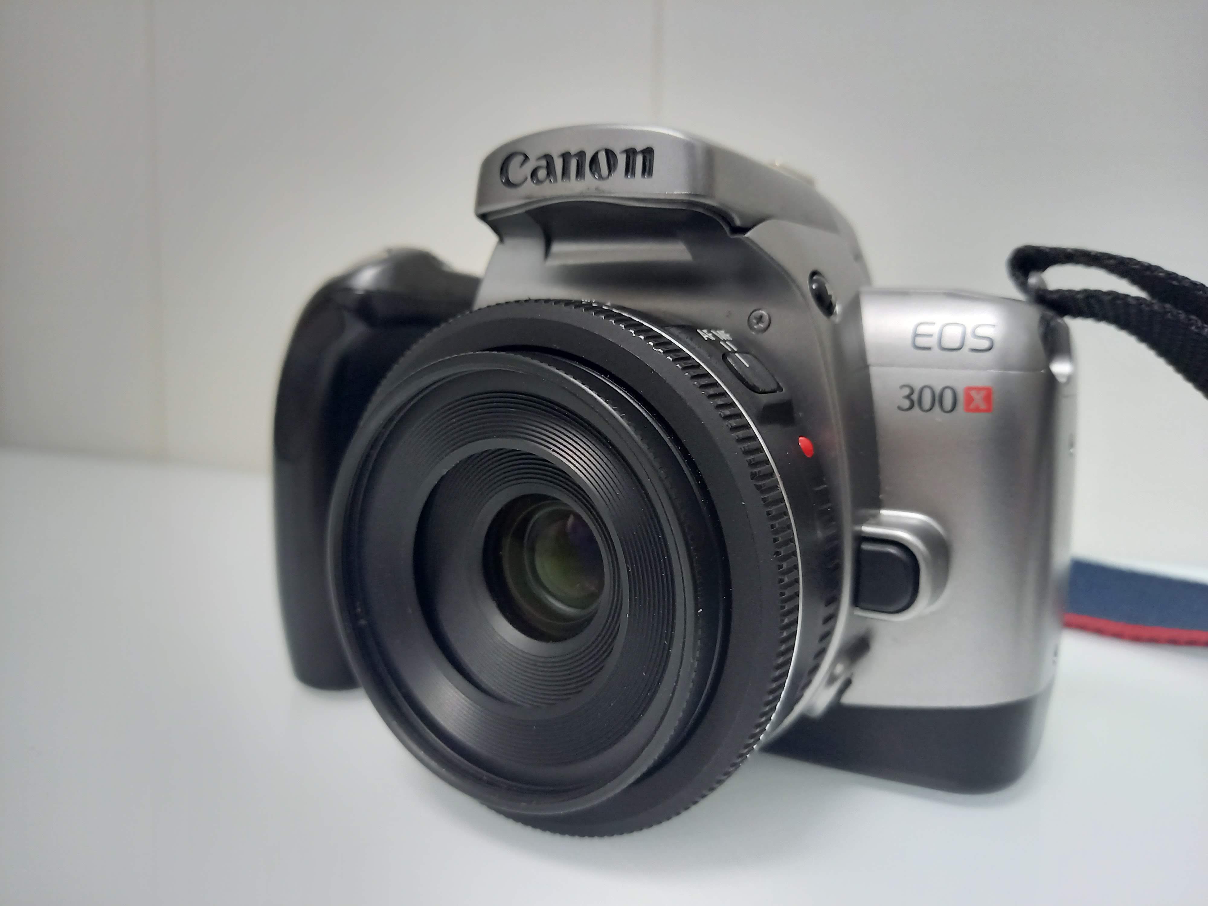

The start of this thread coincided when I was thinking to assemble a light and compact modern SLR with AF for those ocasions where my Nikon FM2 is not a good option (i.e fast action in low light).
So I finished with this pretty inexpensive combo:
Canon 300X (Rebel T2 in US) with a 40mm f/2.8 STM.
The whole kit with batteries weights 530gr and it has a total depth of 9 cm, the integrated flash (GN 13) is also a welcome addition for the intended purpose. It seems a very capable camera in a cheap "suit", really looking foward to put some film on it...😊
I have used the EOS 300V with the 40mm STM. It's an awesome walk around, light combination. A nice sharp lens with a very capable little camera.
Great post, thanks, which deserves its own thread. I tried the above method of moving the camera in a parallel fashion a few years ago and the software stitching result was as bad as you would predict, even with significant overlap. The software couldn't figure out a reasonable solution, and even if it could the perspective would have been all wonky as you rightly point out.

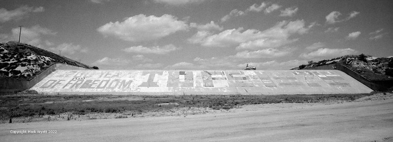

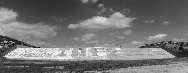

I wanted to photograph a dam spillway with a defaced mural on it last year (the Army Corp cleaned it at the end of last year). I brought my Mamiya C330f with a 55mm lens, and as a back-up I brought a Kiev 4a with a 21mm SC Skopar. I hoped the 55mm would get the shot, but could not get back far enough before the terrain started dropping off. I tried a center position and two rotated shots. I then took the same shot with the 21mm lens from about the same position and got the entire spillway. For the composite shot, I should have taken two straight on shots at 1/3 and 2/3 of the distance and at the same normal distance from the spillway (but I had no way to accurately measure the normal distance...). Both images used Delta 100 developed in ADOX FX-39 II.
Composite 6x6 image
Prado Dam by Mark Wyatt, on Flickr
35mm image with 21mm SC Skopar
Prado Dam whole by Mark Wyatt, on Flickr
