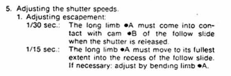

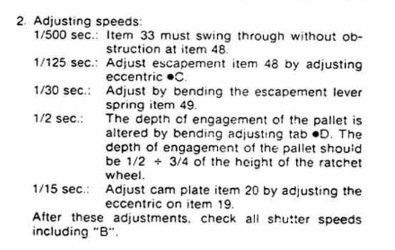

The instructions in Rollei's repair manual for the 35 are a bit alarming. Basically, speeds are adjusted by bending components of the mechanism!

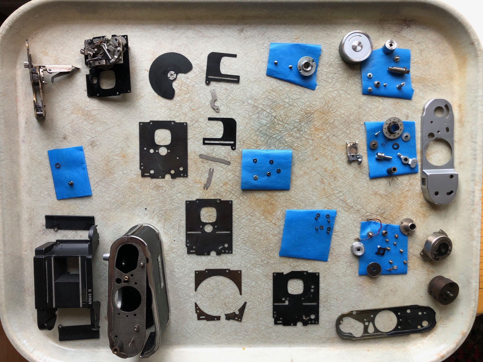

This picture shows my Robot II in a state where I could clean and lubricate the shutter clockwork (top row, second from the left). And I didn't even have to remove the leatherette!
BTW, the lens I have for it ( a CZJ 3 1/4cm f2.8 Tessar) is an equivalent of 41mm for the 24mm x 24mm Robot format, so it is on-topic for this thread.
