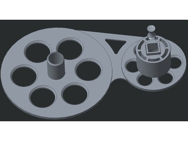

On my side, I opted to print a 400ft -> 100ft re-spooler, and stick with one of the tried and true 100ft bulk loaders (e.g., the AP Bobbinquick).
I have yet to use it, but I can't see why it wouldn't do the job for my needs.

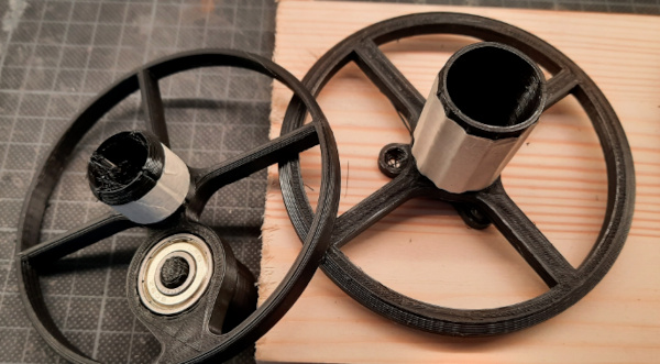

This is the method I went with. I had this printed, and then I got a bunch of extra 2" kodak cores. I had to invent a new crank so that it would fit the standard cores, but it wasn't hard. I managed to split a 400 ft roll down to 100 ft successfully with minimal stress. I originally opted for this method of 400' → 100' so that I could put them in regular bulk loaders, and they fit, even on the 2" cores. The 100' rolls on 2" cores are about 3.5" in diameter.
I am considering some sort of 400' direct to 135 canister bulk loader, but what I have going suits my needs at the moment. Plus, for me, it's nice to be able to freeze three rolls and start with one and work my way through them. When I go back to college and start bulk loading for my photography society, things might change, but that's a later problem.
