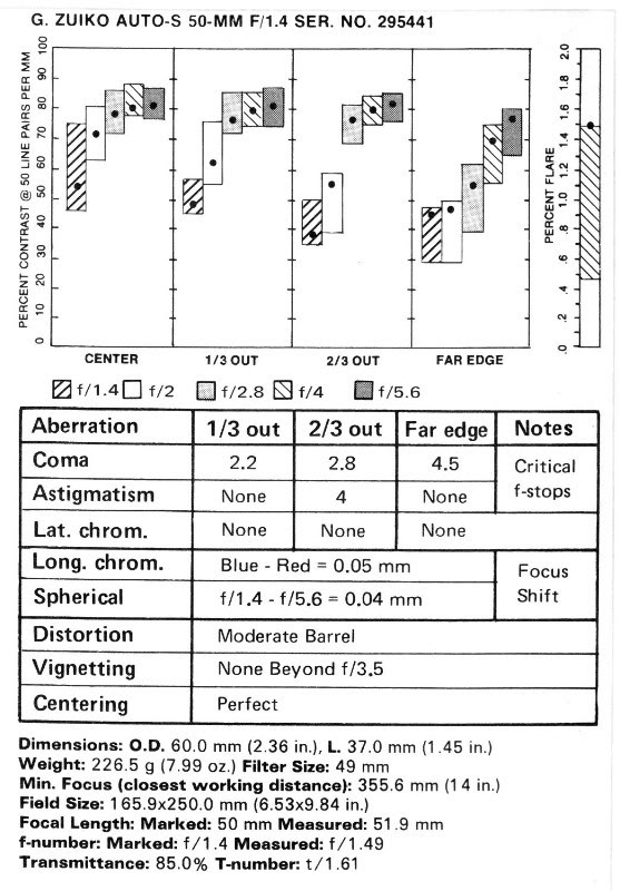

As mentioned, Modern Photography used to print very in depth analyses of lenses...
true FL, true max aperture size, lens resolution tests.
In those days, a lgood ens typically measured about 48-64 ll/mm, really great lenses were 84 ll/mm, and the rare truly exception lens was 100-120 ll/mm
For OM mount lenses, one site carried many of the Modern Photography results as a compilation
https://potsun.wordpress.com/2005/10/28/modern-photography-zuiko-lens-tests/

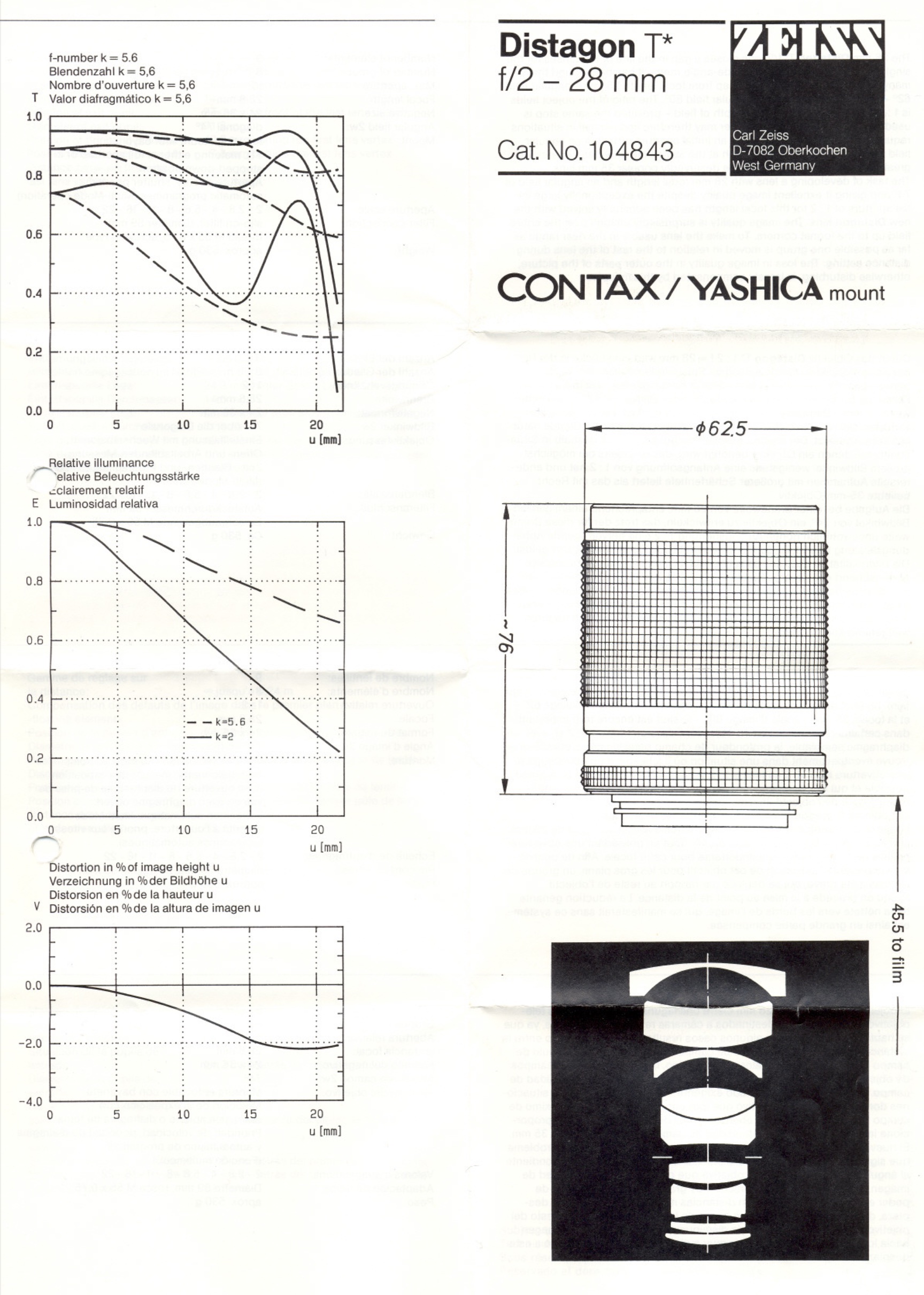

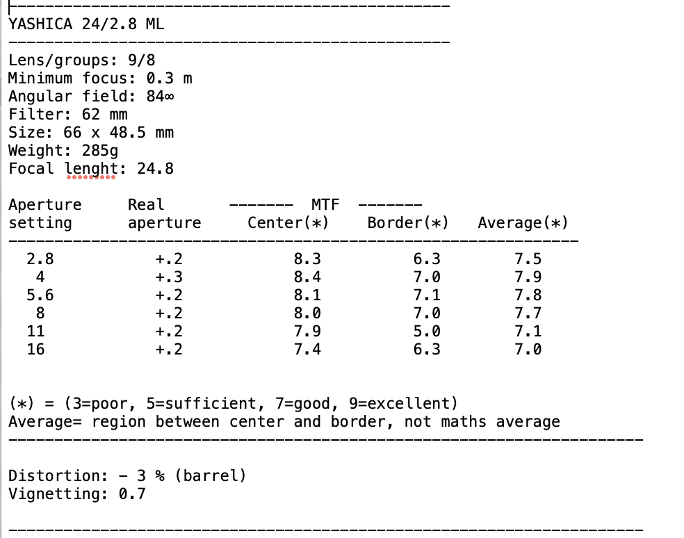

There is MTF information on the internet for 35mm camera lenses. It takes some searching. In the 'pre-MTF' era, resolution tests of 35mm camera lenses were published in the popular photography magazines. For example:
Independent lens analysis obtained form the internet:
Some manufacturers also provided MTF information for their 35mm camera lenses that can be obtained with internet searching.
