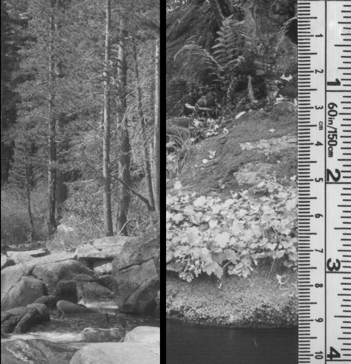

I want to share a side-by-side comparison.
The left is 4x5 TMY-2 printed with Xenar 135 f/4.5 @ f/11
The right is 35mm Panatomic-X printed with APO Rodagon 50mm f/2.8 @ f/11
Both developed in D-76 1:1

Thanks for sharing your prints!
It seems, to me, that the differences between your two prints would be largely subjective and relating to what flavor we like. How do you perceive the differences, personally?

Hi Thomas,
Here is a closer side-by-side comparison. Same two prints. 4x5 on the left, 35mm on the right.
Earlier comparison was 300 DPI this is close to 1800 DPI.
Bright specks are surface reflections on the prints not on the negatives. The 35mm print background is not as white.
My DII enlarger is not aligned, but that's a non-issue because I picked a particularly sharp area for the closeup.
Conclusion: 35mm fine-grain film on a tripod can rival 4x5 fast film on a tripod. Both are appropriate for 11x14 silver gelatin prints viewed extremely critically, where the eye can sense 1800 DPI.
Why is the scan 1800dpi? The higher dpi results only results in a higher file size that will be disproportional to, for instance, web viewing (set at 72 to 100dpi or specifically, digital output, where most printers are at the 300dpi end with scans from 2420 to 3,000 dpi before fine downsampling.
The comparison between 5x4 and 35mm is technically too shallow. Even as a devout, decades-long 35mm users, I acknowledge that 5x4 is a superior format in terms of resolution and detail; it is just too slow, unwieldly and potentially troublesome in a great many conditions.
That's just it, though. 35mm CAN have resolution very similar to 120 and almost 4x5. In fact, it can even be superior, depending on film choice.
Grain will obviously be more visible, because of magnification, but it's so fine at 11x14, (and sometimes 16x20), that to some it neither makes or breaks the picture. It is more than adequate for making stunning prints.
I'd like to re-emphasize that the thread isn't really about comparing ultimate print quality between 4x5 and 35mm. 4x5 will probably make for a better print.
What is astonishing, though, is how incredibly close we can get with that tiny little negative. That is just mind-boggling and incredibly rewarding. :smile:

Hi Poisson Du Jour,
The illustration is from analog silver gelatin prints. Shown here at 1800 DPI equivalent just to support this discussion.
Don't forget, my conclusion is the two prints have the same resolution and detail!
What I'm saying is that when everything comes together, 35mm can be as good as 4x5.
...depending on film choice...
...it's so fine at 11x14...
Exactly!
Imagine how large a print you could make if you can't see the grain at 1800 DPI on an 11x14 print - but you accept 300 DPI for prints - is it 6 times larger?
I should have tried to calculate lines per mm which is a more appropriate way to quantify resolution of analog processes...
An 11x14 inch print is on the smallish side that will of course preserve good detail. Go bigger to fully exploit the potential of 35mm to the point where a print no longer looks attractive through loss of resolution. For years I my gallery Ilfochrome prints were printed at 20x30 (50x75cm) from 35mm. I am printing bigger than this now through digital colour output.
