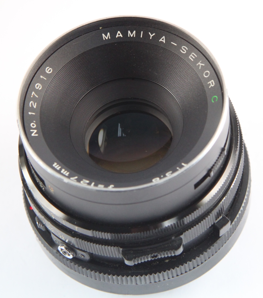

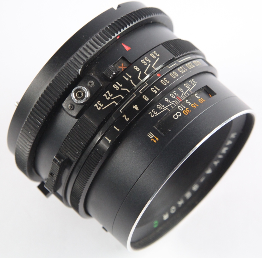

update: 127 mm lens
I found me a nice MAMIYA RB67 SEKOR-C 3,8/127 lens today in Germany and it is on its way to me.
attachment.php
attachment.php
attachment.php
I saw several very good images made with a RB67 and the 127 mm lens really stood out (to me). So it was on my watch list and now I found a decent one. The 65 mm lens will follow sometimes too, I guess. The 250 mm probably not. I'm not a "tele guy" so there is (to me) no gap between 180 mm and 360 mm. And there is a good chance I might even sell the 360 mm lens.
At the moment I'm having a rather bussy period at work: we're having elections on March 18th. After that I hope to get me some days off with good weather and go out shooting with the RB 67 (there was a url link here which no longer exists).

EdColorado
Feb 7, 2009
506
Loveland, Co
Nice lens Toadman, I'm sure your going to like it. I have a pretty full range of lenses for my RB and for most of what I do the 127 is as long as I get. I do though like the 140 C, its a wicked good lens but most of what I do tends toward wider angles. I don't remember the last time my 180, 250, or 360 were taken out of the cabinet.
