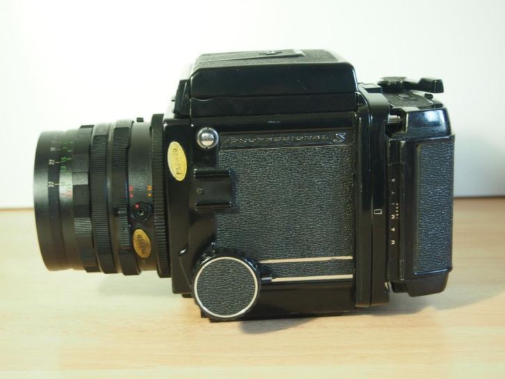

I'm meting up with a guy who's gonna sell me his Mamiya RB67 next Monday. I know manual MF cameras, but have never used a Mamiya RB67.
Here are some images of the ad:
The set contains:
- RB PRO S BODY
- LENSES: 90/50/180/360
- PRISM FINDER WITH LIGHT METER
- GRIP
- 2 FILM BACKS
- ALU CASE
The complete set is supposed to be serviced by Mamiya in 2013 (he has the receipt). Body and lenses were cleaned and light seals were replaced.

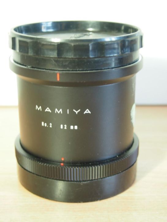

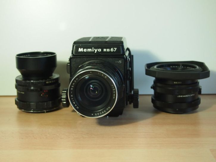

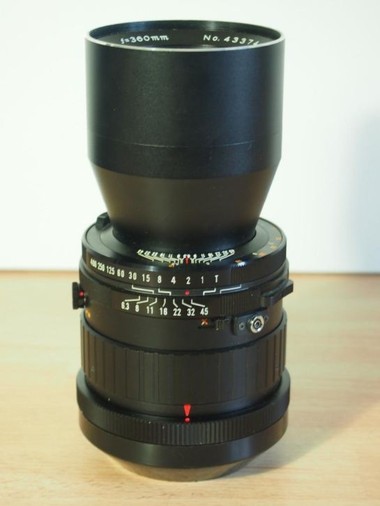

I got the set and some extras:
- body Pro-S (No. C195143) ##can anyone tell me how old this camera is?##
- revolving back
- filmback Pro-S
- lens Mamiya Sekor C 1:4.5 f=50 mm No. 27227 (it actually is a "C" lens after all)
- lens Mamiya Sekor C 1:3.8 f=90 mm No. 84967
- lens Mamiya Sekor 1:4.5 f=180 mm No. No. 20030 (not a "C" lens)
- lens Mamiya Sekor C 1:6.3 f=360 mm No. 43374
- Macro extension tube
- Prism finder (metered)
- Waist level finder (can be closed with one hand)
- Mamiya pistol grip
- original aluminum case
- original focussing screen (horizontal and vertical lines)
The camera and lenses look like new and operate very smooth. The whole set was serviced by Mamiya in Jan. 2013.
All glass clean and as new. Only the barrel of the 180 mm lens shows serious cosmetic marks from handling.
He's gonna send me an extra focussing screen (with grid).
I'm very happy with this great set. I think I like the 50 mm lens best, butI'll shoot all lenses to see what it is capable of.
The 360 mm lens is new and never used. But since I like wide angle it might not get much exercise with me either.
