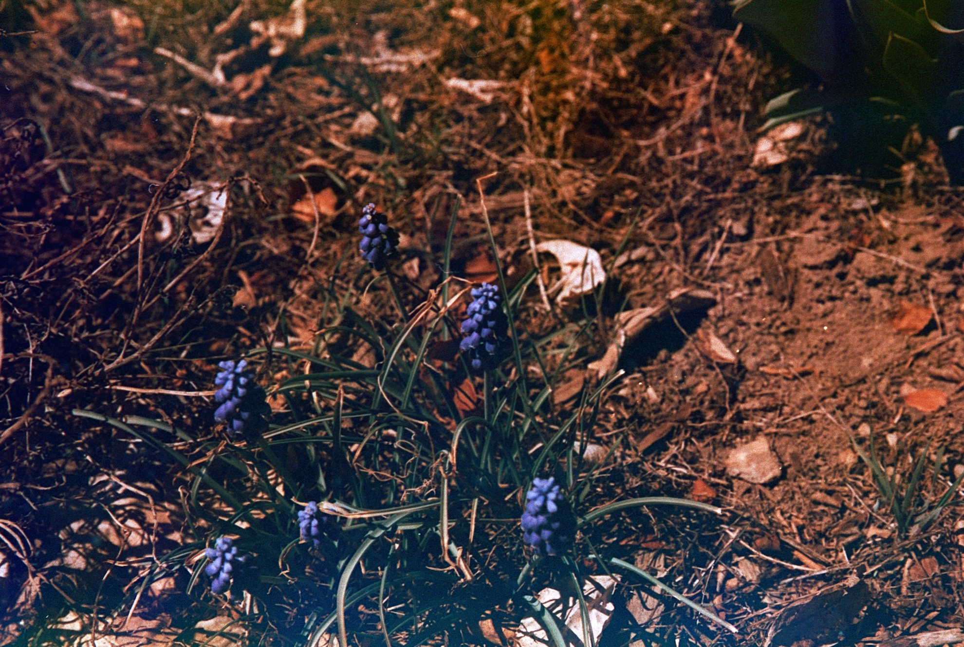

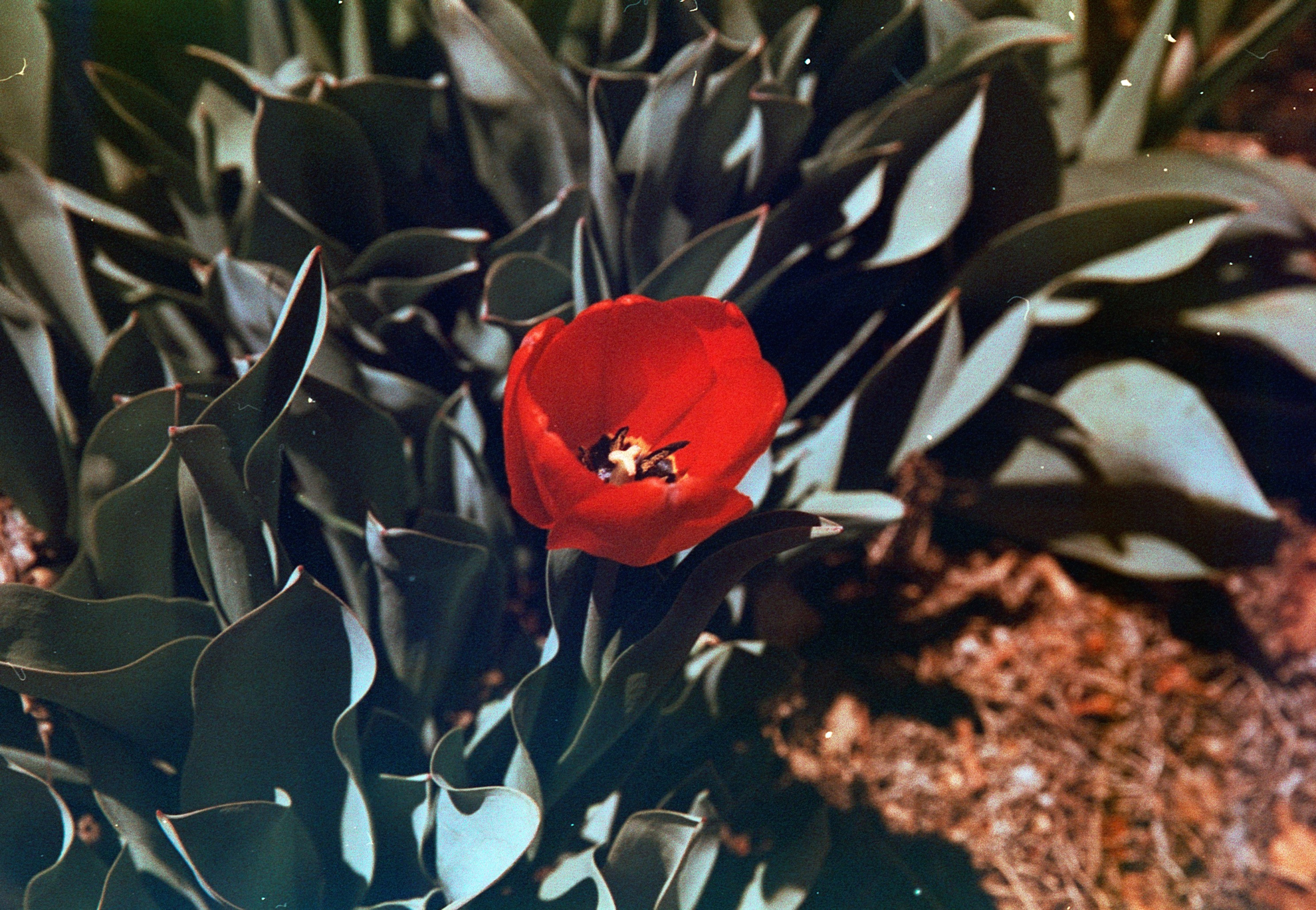

After spending a lot of time and rolls getting a 250D in C41 process down, problems have come back.
I have done about 20 rolls since my initial experiments that have all given good results, I was quite happy with my process. I recently did a couple rolls in ECN2 that also came out fine, but I like the results from C41 better and went back to it.
Yesterday I went out and about and took some shots of what I call early spring, finally starting to get some color around here. That roll came out very magenta/purple with uneven casts across the whole roll. I was down to the very end of my C41 chemistry, so I wrote it off as aged chemicals. I mix my chemicals for one shot use from the concentrates. The color of the developer did not look off, but......
Today I went and shot another roll using a fresh batch of chemistry and got the same results, again, the color of the chemicals all looked OK. I got near the same results, magenta cast, green on the uncorrected scan. The scans mostly clean up except for uneven color cast along the roll. Oddly it seems worse on the outside of the reel.
I also noticed one edge of the film has pretty close to the right mask color. Trying to convince myself why that might be, I process in my Jobo CPE2, so rotary processing. Trying to convince myself that the chemistry somehow stays in contact with the film longer and that even though this C41 kit is fresh, its still old ( maybe 8 months ).
I'm thinking of processing a test strip right from my bulk loader to see if I can get the right mask color.
Any thoughts?

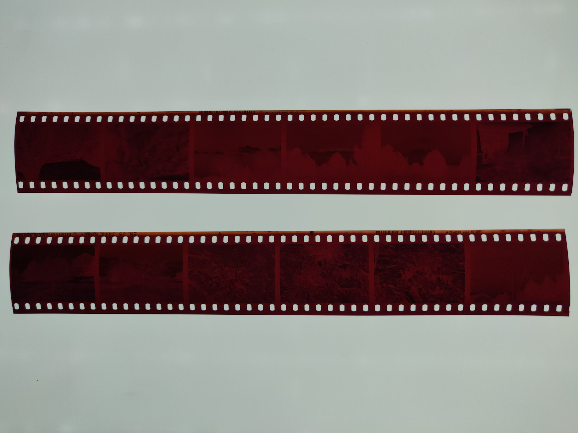

My first guess would be a problem with the bleach, but the negative strip photos don't look quite right for retained silver. Still, re-bleaching with known-good bleach would be the first thing I'd do. Test the bleach on some B&W paper to see if it works and how long it takes, then re-bleach some of the affected strips and see if it makes a difference. Maybe add some KBr to your bleach and bleach for a long time (10 minutes at room temperature) by means of a safety margin.
Can you describe the exact process you're following and chemistry used?
Stop bath and/or rinse after developer?
What kind of C41 chemistry and in particular bleach are we talking about?

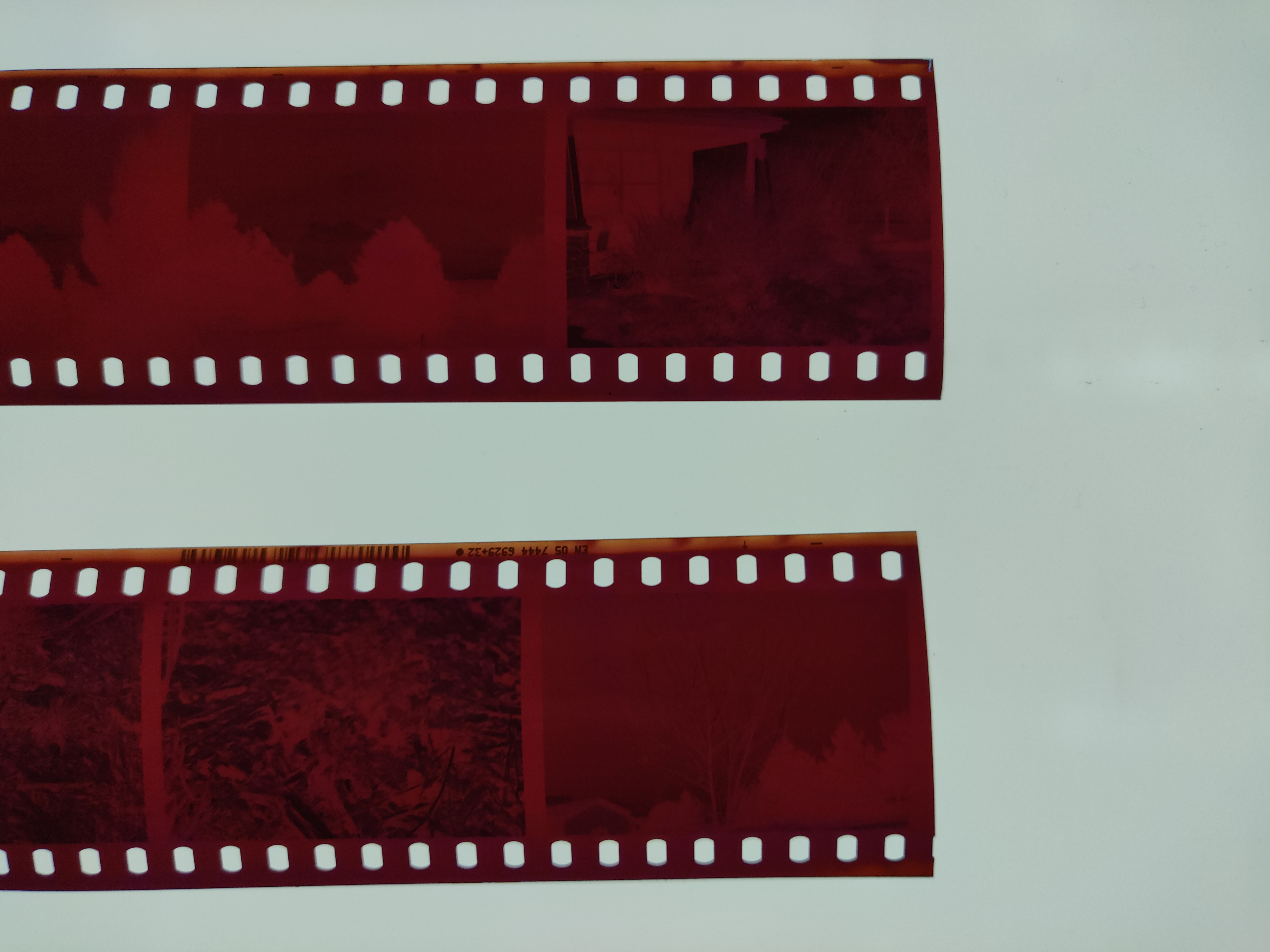

I must say the tiny band at the top of your strips does indeed look like the correct mask color. It's a bit of an odd pattern, really. It's a bit reminiscent of massive light fogging. You do have the center column in your Jobo tank installed, right?

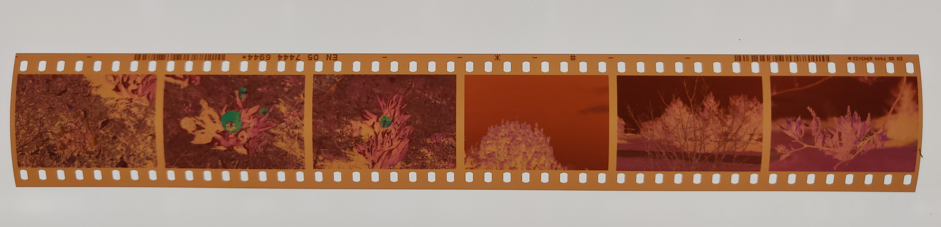

Now I can stop panicking that my roll of 250D was somehow exposed. I did a roll around the house ( really getting bored with doing that for these tests, but would really hate to botch something I like ).
Anyway, I processed this in my ECN2 chemistry, which is also getting old for working strength chemicals. They turned out fine, no signs of fogging at all.
It finally got warm enough going over the hill that I ordered some fresh chemistry. Not sure I'll spend any more time with this kit and just call it bad.
This roll was shot in the same camera and processed in the same tank, there should not be another path for fogging.
Yeah, that looks just fine! Really weird; the only thing I can think of is some form of severe cross-contamination that somehow made its way into your C41 kit.

This sounds like it could be a failure of the velvet at the lip of the spool and possible a light leak into the chamber when you were bulk loading the cassette. The fog looks like it was fogging from the backside of the film and quite consistently.
As another pointed out, if the chemistry was to blame, the edge with the correct D-min would not have been correct.
