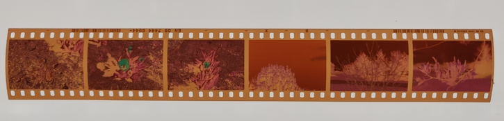

After spending a lot of time and rolls getting a 250D in C41 process down, problems have come back.
I have done about 20 rolls since my initial experiments that have all given good results, I was quite happy with my process. I recently did a couple rolls in ECN2 that also came out fine, but I like the results from C41 better and went back to it.
Yesterday I went out and about and took some shots of what I call early spring, finally starting to get some color around here. That roll came out very magenta/purple with uneven casts across the whole roll. I was down to the very end of my C41 chemistry, so I wrote it off as aged chemicals. I mix my chemicals for one shot use from the concentrates. The color of the developer did not look off, but......
Today I went and shot another roll using a fresh batch of chemistry and got the same results, again, the color of the chemicals all looked OK. I got near the same results, magenta cast, green on the uncorrected scan. The scans mostly clean up except for uneven color cast along the roll. Oddly it seems worse on the outside of the reel.
I also noticed one edge of the film has pretty close to the right mask color. Trying to convince myself why that might be, I process in my Jobo CPE2, so rotary processing. Trying to convince myself that the chemistry somehow stays in contact with the film longer and that even though this C41 kit is fresh, its still old ( maybe 8 months ).
I'm thinking of processing a test strip right from my bulk loader to see if I can get the right mask color.
Any thoughts?

I must say the tiny band at the top of your strips does indeed look like the correct mask color. It's a bit of an odd pattern, really. It's a bit reminiscent of massive light fogging. You do have the center column in your Jobo tank installed, right?

Update: I put a strip in fresh bleach for 10 minutes, no change.

The more I look at it, the more it makes me think of an optical fogging problem. Not sure where it would manifest itself down the chain, though.

This sounds like it could be a failure of the velvet at the lip of the spool and possible a light leak into the chamber when you were bulk loading the cassette. The fog looks like it was fogging from the backside of the film and quite consistently.
As another pointed out, if the chemistry was to blame, the edge with the correct D-min would not have been correct.

Recently ( in the last week )I went back to the 250D. First roll had the same dark muddy issue and that's when I had my aha moment.
I still do not have a darkroom so just process on a table in my basement near my hot water heated. I would poor the remject clearing solution into my tank, let it sit for 30 seconds or so, poor in back into my bottle for next use. Now I would fill the tank from the hot water heater, shake and dump. Do this four or five times to clear what remjet was going to come off. From there into the Jobo and process. Some times was fine, some times dark and muddy looking.
My aha moment was that the water from the heater was way too hot. Now I'm not sure that it was hot enough to really damage the emulsion or if it just made things hot enough that the developer was really active.
With that in mind, I did a few more rolls using water much closer to the process temperature and all of them came out fine. I used my driveway cleaner to clear the remjet, no issues. Each roll looked like I would expect it to.
So, why the inconsistency, I think it was a matter of if the hot water heater had just been used so that the water temperature was much lower, vs a freshly heated up tank full. Stupid right!
Anyway, my 250D process is back into control and giving good results.
Moral of the story, watch those temperatures, I measured the water out of the heater at what I think is its hottest and it was 140F, poor film.
