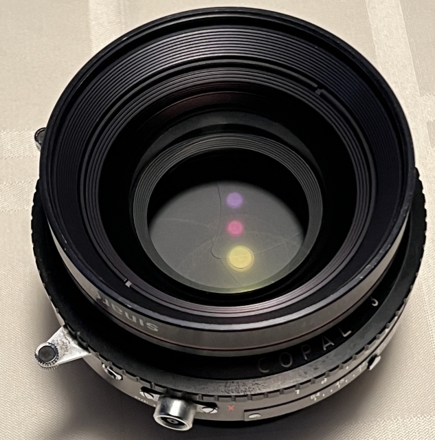

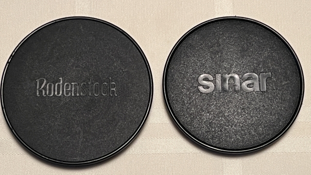

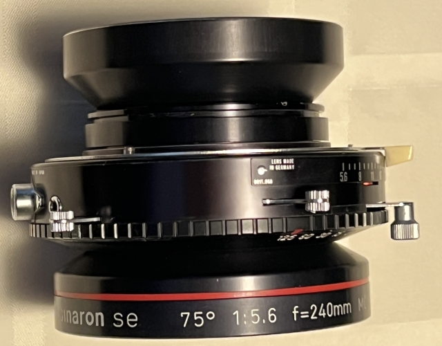

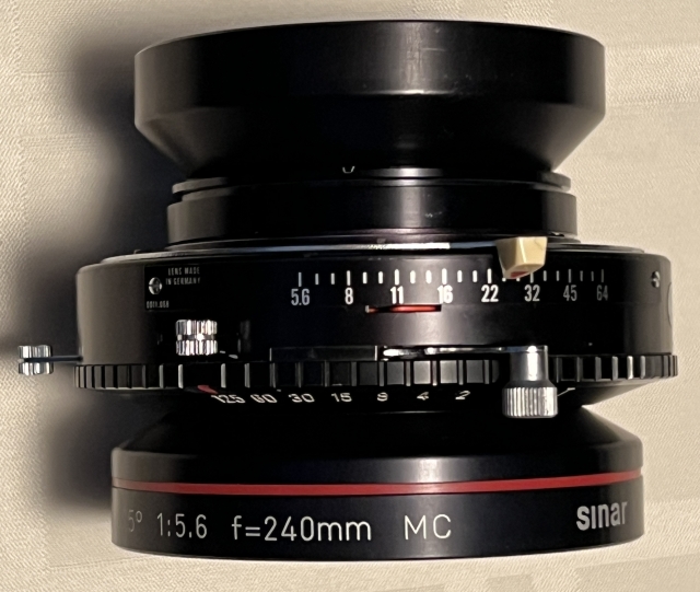

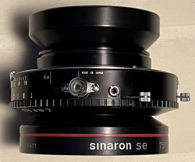

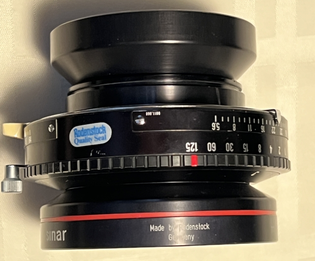

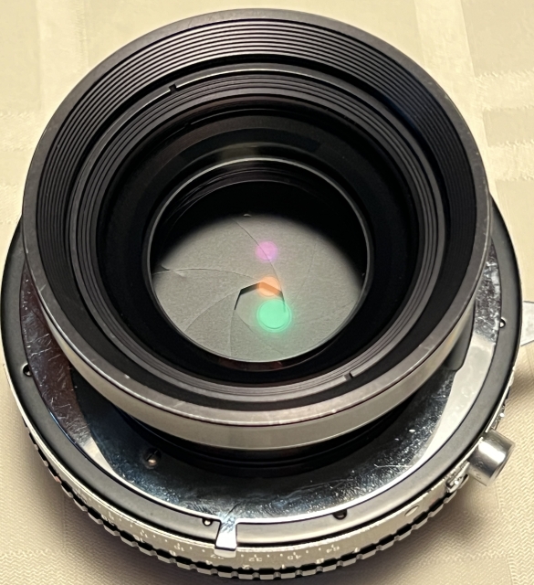

Here's a nice 240mm f/5.6 Sinaron-SE, the Sinar-branded version of Rodenstock's Apo-Sironar-S, mounted in a last-version Copal 3 shutter. Its 75-degree field of view gives a 372mm image circle at f/22, which allows plenty of movement on 8x10. It's a substantial lens, weighing 987gm (about 2 lb 3 oz) with caps and retaining rings on my kitchen scale, and takes 86mm filters. The glass is clean and clear with a few specs of internal dust and no obvious cleaning marks. Includes Sinar rear cap, Rodenstock front cap, and both the spacer and retaining rings.
I measured the Copal 3 shutter's speeds at f/22 with an old Calumet tester (admittedly I've never tested the tester's accuracy) and they're repeatable and slightly slow throughout range with the worst results at the fastest speeds, the usual result for Copal 3 shutters. The sheets that came with new Copal shutters said that 30% error (almost 0.4 stop) one way or the other was considered "in spec".
