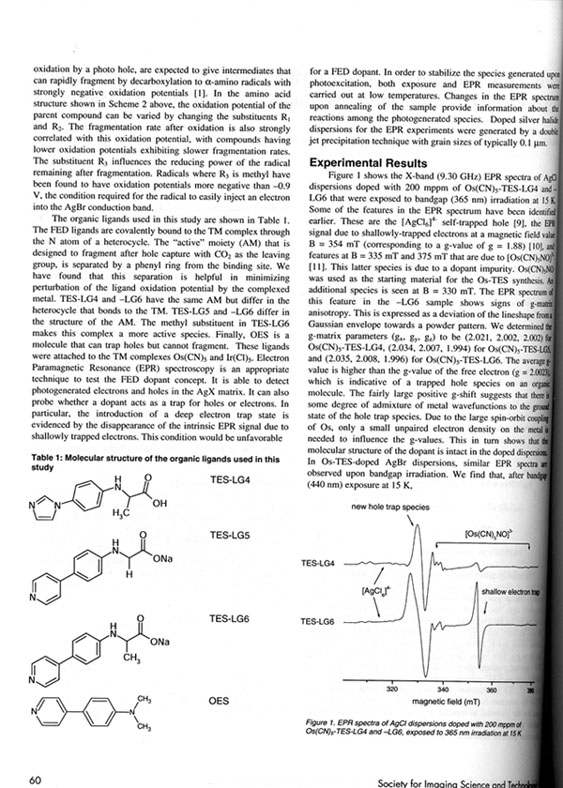

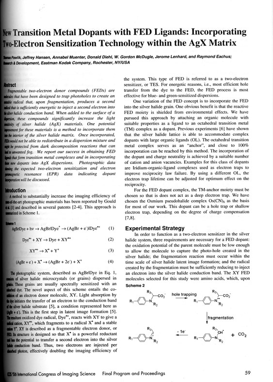

The process uses what is called an FED or Fragmentable Electron Donor. Even that paper does not show it in much detail.
Thanks for the reference. I have a few more plus the abstract to their talk in 2006 if anyone is interested and I manage to find the time to scan it.
PE

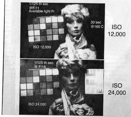

In the interests of copyright, I have copied only the title page and one introductory page. As a bonus, I have included the 2 photos using Paul Gilman's 24,000 imaging system. :D They were in the same journal.
I might add that the journal is about 3 inches thick so the quality of the scans is not perfect. Sorry.
PE

Those pictures at ISO 12000 and 24000 make me sad. I could have had some fun with that film.
