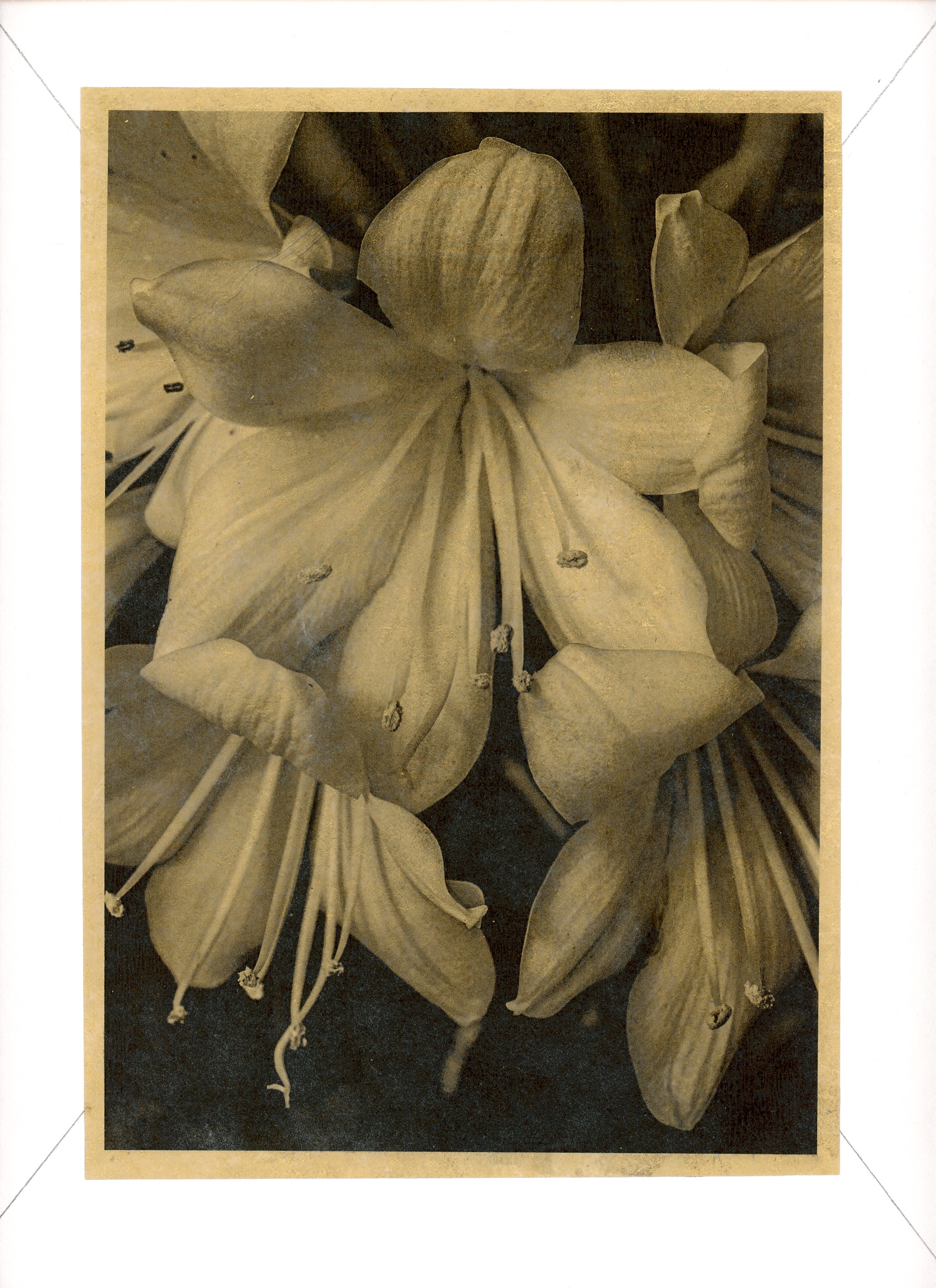

FYI, Here is a tri color gum I did over a photogravure intaglio print - it was on print making paper which is very porous so I had to PVA the heck out of it - but it seemed to work OK - Cyano, Quin Gold and Scarlet Pyrol. Probably could have used a sienna to make the street a bit more brown.....

This may amuse you - a photogravure I recently made on some fairly thin Kozo paper, then a couple of coats of Karmar spray varnish to make it translucent - and the "Dan Burkholder" gold (fake who could afford real gold now) treatment on the back side... not too bad - some brushing marks unfortunately in the sizing I used to attach the foil. Dry mounted on a piece of matt board - but lesson learned. Overall not too bad.
i like doing gum overs on fairly neutral B&W prints, and have been doing some B&S Pt/Pd stuff, but it is so damm expensive I think I will go back to Kallitypes as the base.
