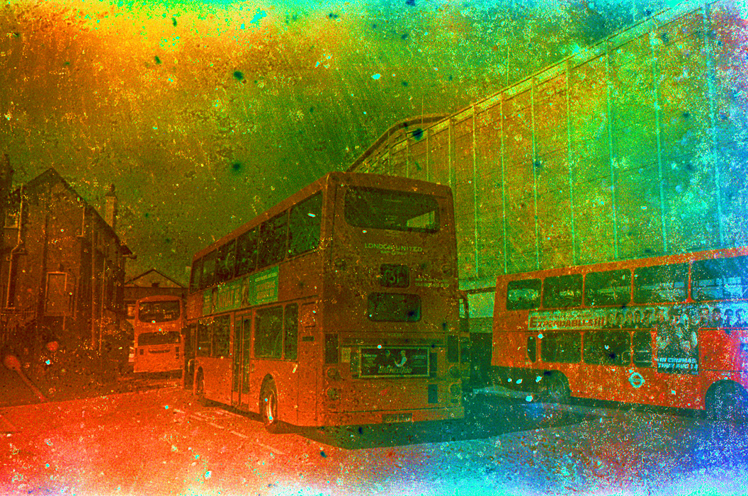

In the attachment I adjusted the color of the bus to be approximately right, the sky was blue.

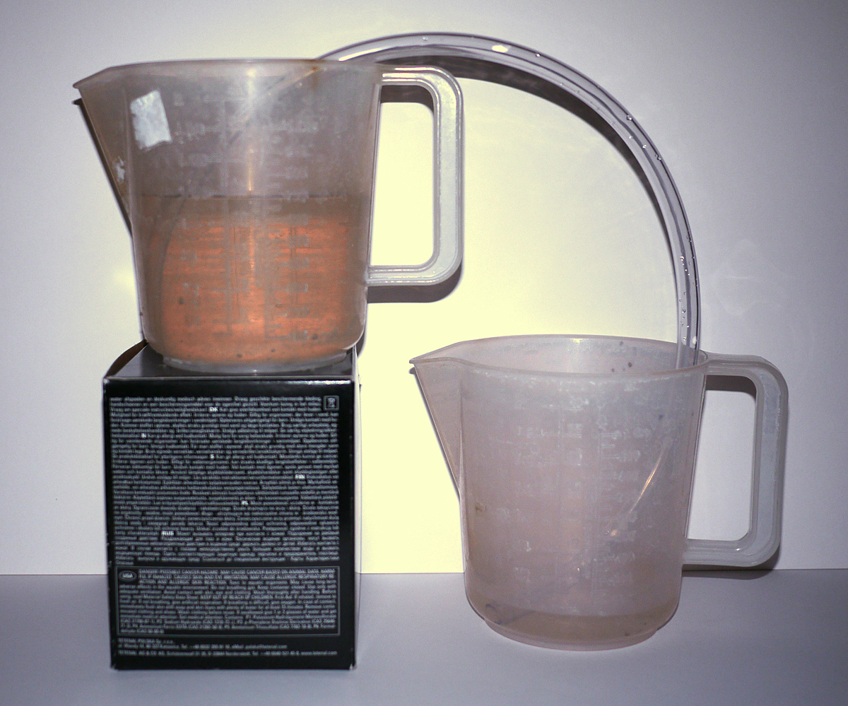

I made a siphon using a flexible plastic tube (attachment).
For safety the plastic tube is first filled with tap water then dipped into the water layer containing PPD.
This is then siphoned off for use ( after filtering through cotton wool) and the oil residue that was floating on top is discarded.

My next lot of hair dye was slightly different, it did not separate into two layers so I added some shower gel and shake the emulsion before use.
Also, I obtained less thin negatives by first developing in B/W developer.
Bath B was made 1 shot because blobs of grease form on cooling.
Vista 200 @EI=50
Develop Xtol 1+0 8min 20C
Fix
Rehalogenating Bleach 10 min 36C
Expose to daylight
Part A 5 min 36C
Part B 6 min 36C
Rehalogenating Bleach 10 min 33C
Fix 5 min 32C
In the attachment the red is about right but the blue sky has shifted to purple.
This is, just about, a viable process for obtaining strange colors but there is a problem with debris on the negatives in my test.

I've still got a couple of tubes of £Land's finest hairdye, I might dig it out and have another go.
It's curious, I've tried a few recipes for C41 colour development, using hairdye and whatnot as well as CD4, and when I get anything at all, the reds always seemed to be fairly true.
Since you know the original scene: do you think one could fix the magenta sky by contrast adjustments for each color channel? If that is the case, you might be able to fix these different contrasts by changing the Xtol treatment step, using different temperature and possibly different concentration.

That is an interesting observation that the red color often comes out right.
Rudi,
It would be simplest to change the temperature.It is a while since I did any C41 and I do not remember what effect this has.
IDK if one can predict the effects of process changes on the colors obtained.
Steve,
The process produces a negative on the usual orange base.
The trick in color processing is to develop three color layers in lock step, i.e. with parallel characteristic curves. If you change temperature of your bath, you have different swelling and diffusion, which means you change the ratio of development between layers. If you increase dilution, the top layer will see a more active developer than the bottom layer. All the methods of color balancing of C-41 and E-6 depend on exactly these techniques.
Since this is some sort of lomographic experiment, I see no point in playing with competing couplers and organic restrainers. I'd say check whether Xtol@38°C makes a visible difference, and whether dilution and pH changes (+Na2CO3, +Acetic Acid) change the result in the direction you want.
