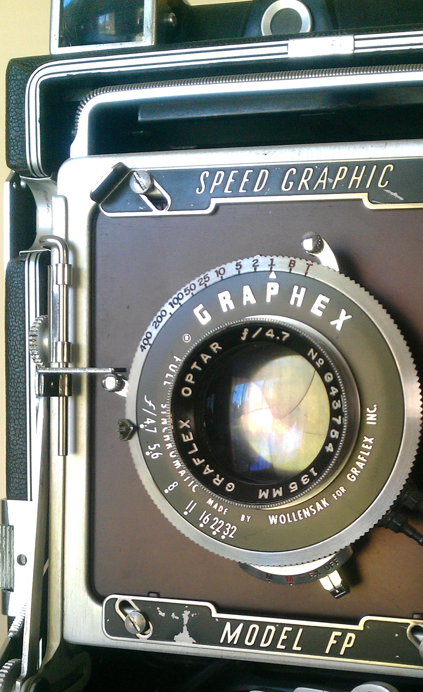

To the type of shutter. all I can say is the cocking is at 2:30, release at 9, and focus lever at around 4.
Focus lever? Do you mean aperture? Focus is with the knobs on the bed.
Does yours look like mine, below?
Notice that the lever which contacts the release on the lens can be adjusted for position.
1- the manual (which is all I know!) speaks of a "Press Focus Lever", which opens the shutter blades for FP shutter operation - as in, allow focus on ground glass, I guess.
2. No, does not look like yours, and yes there is a provision for height adjustment, which is needed in my case.

Jay, what you earlier called a focusing knob selects the correct sync for a variety of flashes. X is for electronic flash and F and M are for fast and medium sync delay for those two classes of flash bulbs.
