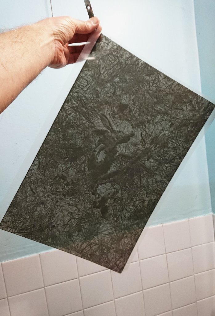

Over the past couple of days I've, ahem, acquired, a couple of large but not enormous garden trays, so that I could do a few test runs at a smaller size (around A3) to see what I'm letting myself in for.
The weather was rotten this morning so I set up and had a go. I made three negatives, and here's one of them:
I'd made this negative before at a smaller size so I used the (L2/L1)^2 formula for exposure factor to estimate the new exposure time. Bit long as it turned out, but I guesstimated a shorter time for the next ones and made quite a decent negative in the end.
Easel: taped the film to a sheet of cardboard taped to the wall. Hi-tech stuff.
D23 1+14 + some benzotriazole as before and about 8 mins in the tray.
Conclusions thus far:
Vibration is a potential problem. Very great care (or a footswitch for controlling the enlarger) is required.
I'd have no qualms about processing the final print in a single tray using makeshift kit, but processing a negative nearly half as big again as this one gives me much pause for thought. I may have to save my pennies and get the big Paterson trays.
Also, none of my time or materials has been wasted or cost me more than I can afford or want to spend. Just in case anyone thought I might do that. Not mentioning anybody in particular of course :D
