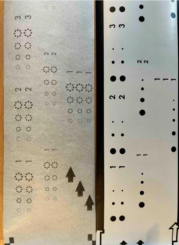

The numbers on the back of Ilford/Harman Delta 400 are very light, extremely difficult to see through the red window. In contrast, Fujifilm Provia could not be clearer, see the attached photo (which shows the numbers darker then they really are for Delta 400). The Fujifilm Provia backing paper also has a hole in the leader, which engages with a catch index the slot of the plastic spool, very useful for loading the film, see second photo.
Ilford/Harman make nice B&W emulsions, but they seem to have switched off on the packaging. This is "Film Photography 101". Having difficulty seeing the numbers when winding on takes some of the fun out of using a film camera. Or perhaps they think we need to be challenged?
By the way, notice how the Fujifilm dots before the numbers are so much more sensible ... large, medium, small in that order ... so you approach the number clearly. Fuji have put some thought into the packaging, Ilford have not.

Ilford/Harman made their numbers quite a bit lower contrast as a result of all the bleed-through that happened where numbers were being exposed onto the film. This change was some years back. Presumably what Fuji has done is to actually have a better light-proof paper where this does not happen, which then enables higher contrast numbers.
In layman's terms it's paper and ink, in film manufacturing the backing paper costs even more than the film and is highly specialised (it's just paper, right?).
The offset and mottling was a huge problem even with Kodak really struggling, MattKing described well and I was surprised on the level of criticality this had. Quoting his post from another thread about backing paper:
It could very well be that due to the nature of the paper and printing options that are available to them, the two options are:

When Eastman Kodak were recently struggling with the wrapper offset problem, they came very close to option 2, because option 1 was considered totally unacceptable to them.
Fuji never seemed to have this issue or only very lightly with old film and badly stored conditions. And their backing paper has always been this strongly printed. I had shot some 2006 Astia that has some slight paper texture to it, if it comes to that.
My cameras don't use red window, and I have photo friends that chose Foma instead of Ilford Kentmere because of the frame advancing difficulties... But I'd rather have these films without defects and issues if this minimises it.
Fuji somehow never had the problems that Kodak and Harman/Ilford had. Kodak and Harman had to redesign their backing paper with lower contrast numbers and indicators....and I agree, it does make it difficult to see the numbers through the ruby window on most cameras.

Just a reminder - most of the wrapper offset issues have little to do with the backing paper itself. They arise because of the chemical interaction between the emulsion of the film, and the back of the backing paper that it is pressed against, including the printing thereon.
Every time an emulsion is changed, the possibility of new wrapper offset issues arising is very real.
So swapping the backing paper from Fuji to Ilford or Kodak film may very well not work at all!
Eastman Kodak is carefully guarding the technology they use for their current backing papers - it is a very valuable asset, that cost them a huge amount of money to develop.

The main issue is the ink and the design, not the paper itself although it obviously plays some role.
Look at the photos on post 2 (thanks Koraks), and see how much clearer and definitive the Fuji design is (and as I mentioned in the original post, the iPhone photo makes the Ilford look clearer than it actually is). When you wind on the Fujifilm, looking in the red window, you first see a big bold black dot, followed by 3-5 equally bold but gradually smaller dots and then the number. Starting off with the big black dot gets your attention (long before the number) and then you carefully concentrate on the following smaller and smaller ones until you get to the number ... the person who designed that took photos themselves, I suggest.
The Ilford "design" seems to be done by an intern in the marketing department on a Friday afternoon.

Harman now also use the same backing paper on Phoenix so it has to work with that too. It may well be that if Harman used the same backing paper as Fuji, Lomography or Foma (all of which are clearly numbered/labelled) there would be undesirable interactions with the Harman emulsions.
It is a bit of a problem, I have occasionally wound past a frame and missed it. Rods and cones rather than eye colour, but I really do need good contrast to see things clearly and with Harman film of any brand, I do struggle. Hence using the phone light. Or getting someone to do it for me. In the jazz club, I can barely see the ruby window is even there and certainly not that there's paper behind it. Mind you, my eyes are also super sensitive to red - I can see near IR (some security cameras with IR night vision, for example) and car tail lights dazzle me as if they're being shone right in my face. It's colour perception as well as contrast and detail. I can't see in the dark but I can read a car number plate from 200m at least.
It seems that multiple countermeasures were implemented to address wrapper offset interactions: lightening the printing, addition of a barrier layer on the paper, and I seem to recall that maybe the ink itself was changed. This site provides some 2018-era insights on the backing paper update from an active Kodak representative.
The lightening of the printing, unfortunately, is not addressed. For me, that has been a minor problem that has been remedied by using a small flashlight. If only I had one more arm and hand! The referenced discussion does include my biggest pet peeve: the finicky nature of the sealing tape. I also carry rubber bands now.
