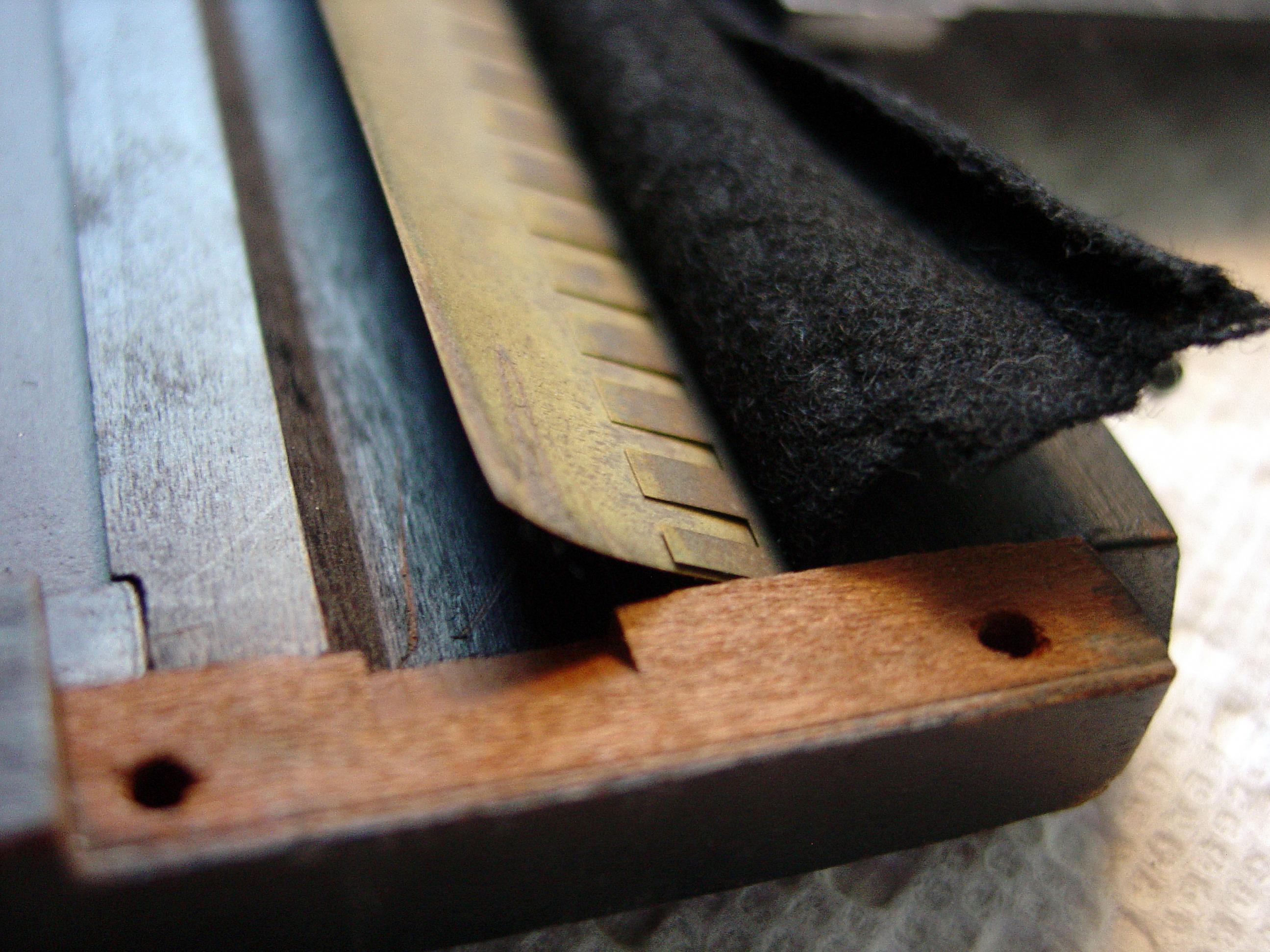

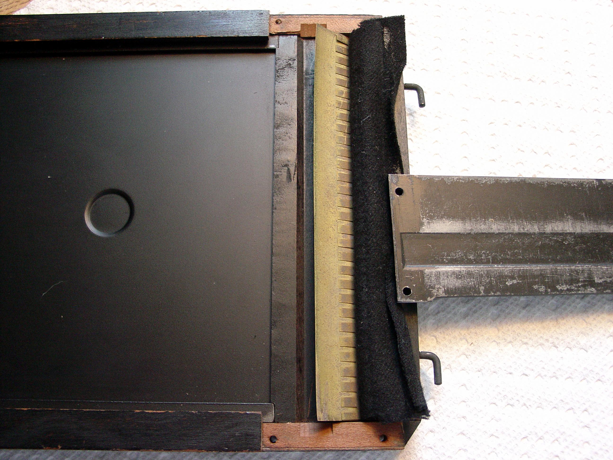

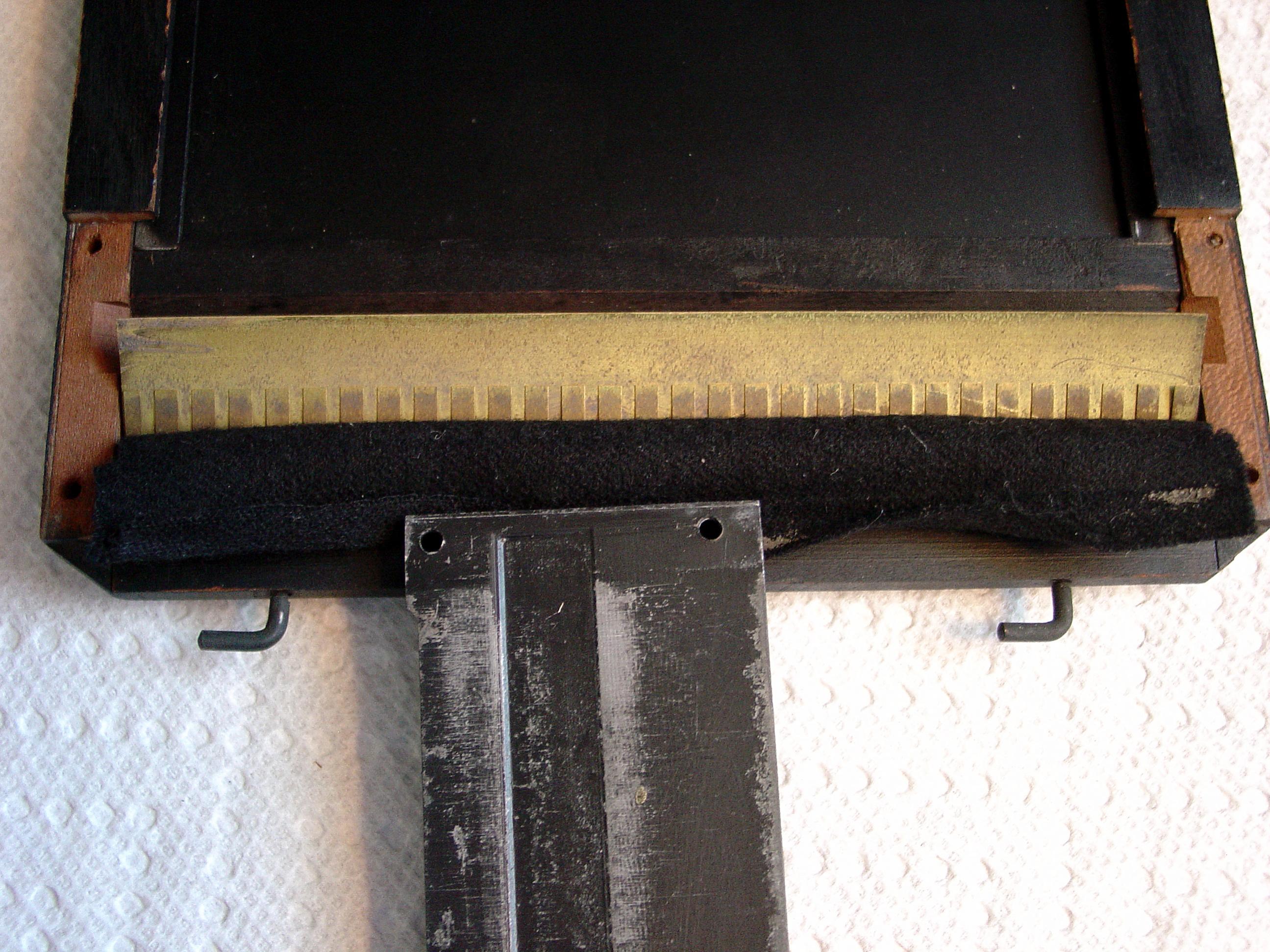

This is what I'm using as a basis for my design of the light traps. These digital photographs are of a 5x7 wooden holder that I had sitting around and it has one piece of brass with a finger / comb piece on top of it and all covered with some felt like material.
I'm going to use one piece of brass shim stock covered with velvet like the wood holder shows in configuration. The brass wraps around the holder and is continuous from one side to the other. There is a wood piece on top of it where the locking screws are attached into. So there are two pieces of wood. One has an opening for the septum plus film and has a surface that is even to the dark slide plane; it has a recesses on both sides for the velvet light trap to go into when the slide is inserted. The top piece is thicker at the bottom where it sits on the light trap. The trap brass/velvet is not glued to the holder and stays in place because it is wrapped over the wood and held down by the top piece and a cover is place over it.
The old manufacturers, designer, inventors spent a lot of time work to make this design. I have a holder made, it's made of mahogany pieces that I had in the shop. I've made my septum groove 1/8" and the dark slide 1/16" but I'm going to make a septum groove 1/16" on the first 'real' holder to exact size.
My first model is a size of 5x9 inches, there isn't a film size for it, it's to see if I could actually get the holders made and to experiment on the assembly and procedure before I make a set of them.
I found that Garolite XX cuts very smooth on my Powermatic 66 cabinet saw with a fine tooth carbide blade, no problems with that. I bought a 1/16" four wing carbide shaper cutter for my Powermatic 27 shaper. It's like cutting through butter. I got some new DeStaCo clamps for a custom cutting platform jig.
I have an excellent planer and a Uniplaner so surfacing the stock isn't a problem. What I thought was hard is easier and what I thought was going to be easy is a bit harder.
This week I'm going over to get the cherry stock that I'm going use for the holders. My plan is to make 6, then make a second run of 6 for a total of 12 11x14 holders. Believe me I've spent many many evening with a caliper pencil and paper going over all the materials and dimensions. There are some things that became apparent with a mock-up that just isn't apparent when drawing them on paper. I did some work on cad but I'm not going to spend months with drawings when I have already made one and now can see how it's done.
My suggestion is to make a model, mock-up, what ever you want to call it and see how it works. Originally I was going to make a single side holder but I slowly realized that what came before me was what I was slowly modifying my holders to. I figured that I was trying too hard to reinvent the basic film holder. I'm making double side holders.
I hope you can read this as I've just returned from the North Cascades National Park. I've been house bound and it was nice to get out. I saw some things I want to photograph with a large format camera. I have 100 sheet box of Kodak green 11x14 film here and that's what I'll probably use for the most part. I will use some regular film too later on.

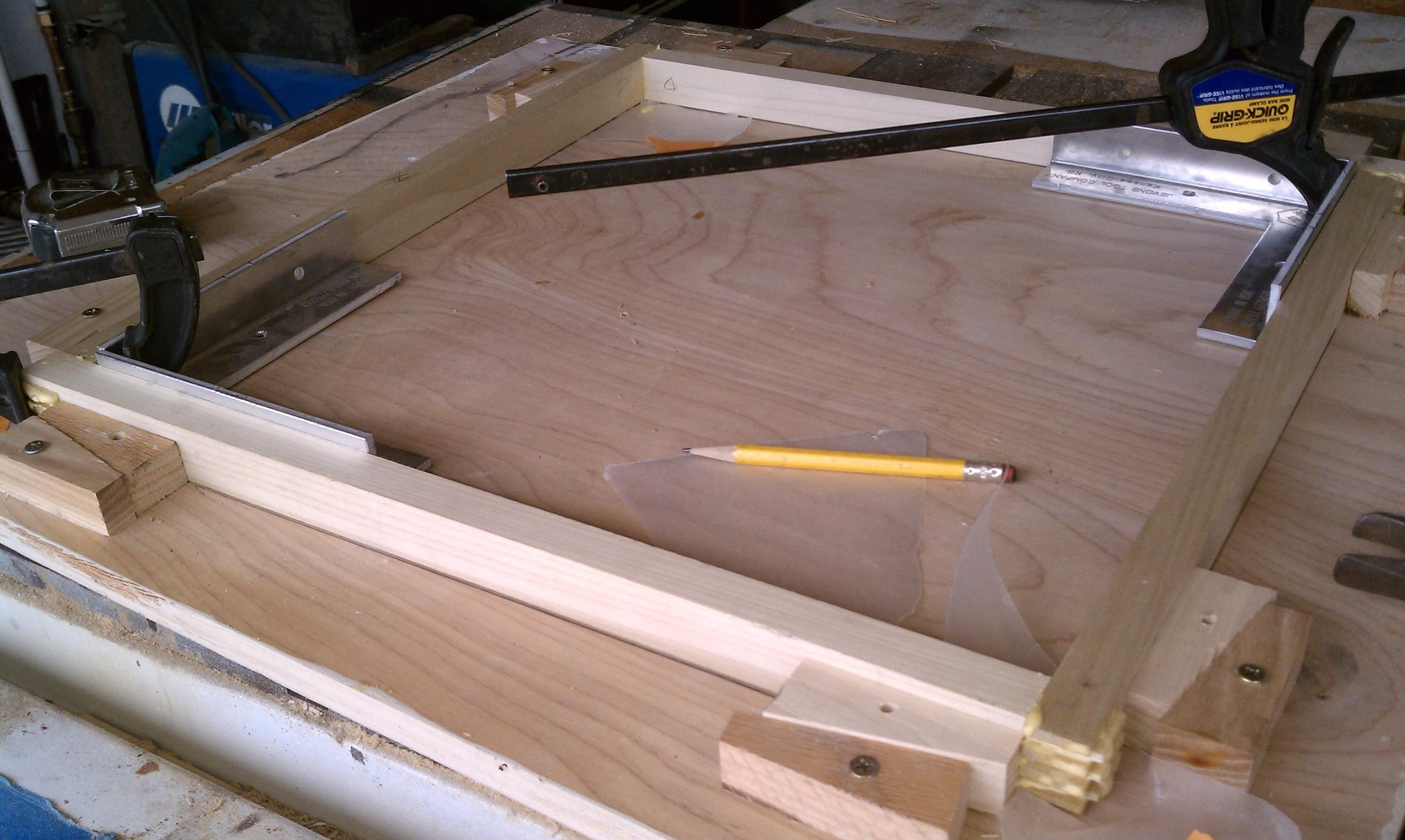

Here are a couple of shots I took with my phone. One is gluing the exterior frame, the other is how I cut my grooves for the dark slides and septum. I'll get some more current pics soon.

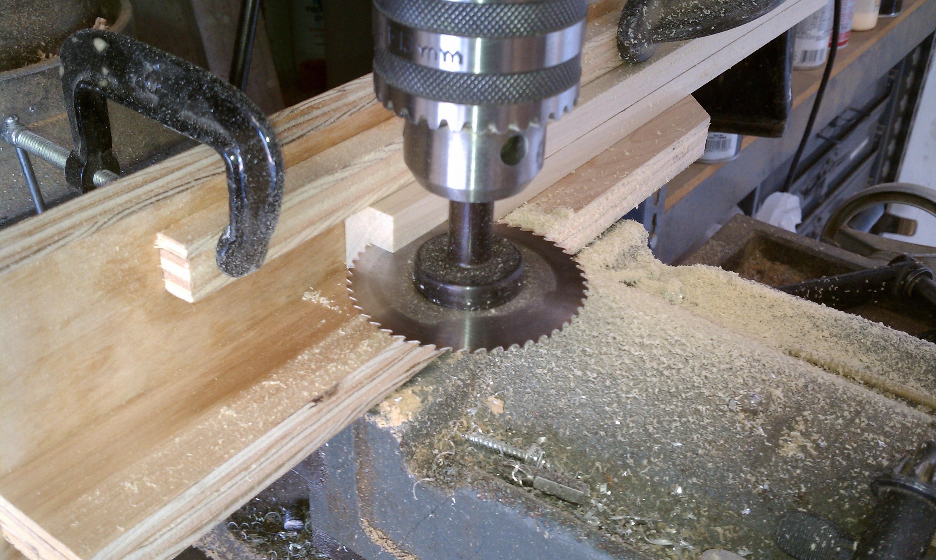

Hey Tim, What type of saw blade is that in number 2? What is turning it? I've never seen anything like that. Looks mighty handy.
tim k
Feb 11, 2008
232
Tucson
Mark, its a slitting saw, usually used on metal. They come in all sorts of different thicknesses. The machine is a mill drill. This is not mine, (much too clean) I snatched the picture on line.

Tim, I'm rechecking my design of the light trap. Upon careful examination and with some thought I figured out what the combed brass does. I had just laid down to sleep and it popped into my head. I thought the second layer of brass which is not connected to the larger brass strip just added some increased force to the set but suddenly I thought that if that's so then why not use a stiffer or heavier single layer. The combed brass strip work like this. When the dark slide is inserted the larger brass bends down and as the slide is inserted the combed brass pushes up behind it making not only one contact point but a plane of contact. It's easy to see this happen when the cover plate is off. It's a very cleaver invention, someone or some people knew how to design and manufacture back then.
So does it have to be combed or can it be a straight piece. It would take days to cut one in the combed configuration. I'll have to recheck this. I think the combed design provides even more independent pressure so if a change in the slides straightness is encountered the comb will compensate. It's a very nice design. The velvet or felt material has to be attached to the underside of the larger brass and not to the top of either.

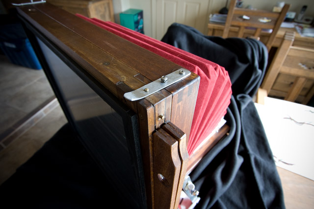

I've completed my prototype 11x14 film holder, at least far enough to start planning the set I need. I've made mistakes along the way but in return I gained a full understanding of the operation of a light tight holder.
Curt
My camera is only partly completed however. Now I want a better camera so I have to burn the midnight oil on the design. That's ULF, help!

Curt, thats good to hear. I've got my first holder done as well, Actually I'm far enough along to actually expose a piece of film. The camera is about 90% done and my holder is 99.3% functional. I'll get some pictures up soon.
tim k
Feb 11, 2008
232
Tucson

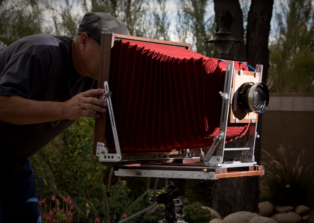

Ta-Da
Its been done for a while. I've just been lazy about getting a picture to upload.
I've shot a couple of paper negatives, and go figure, it works.
Film is in the brown truck. :D

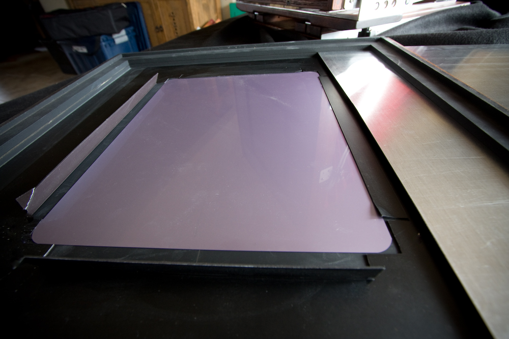

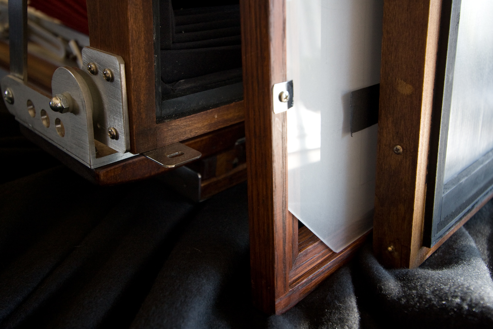

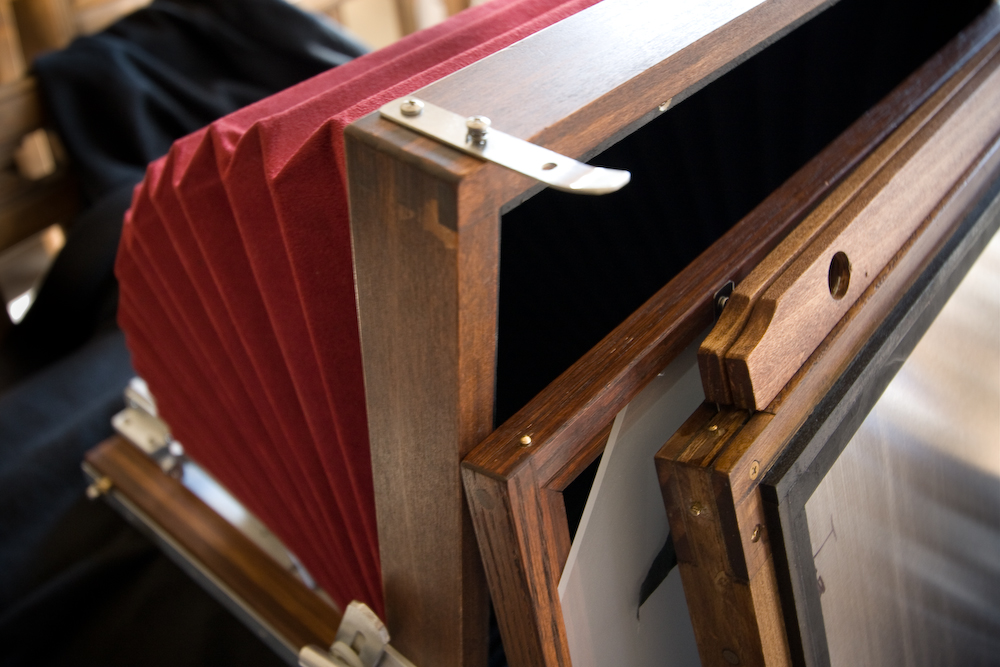

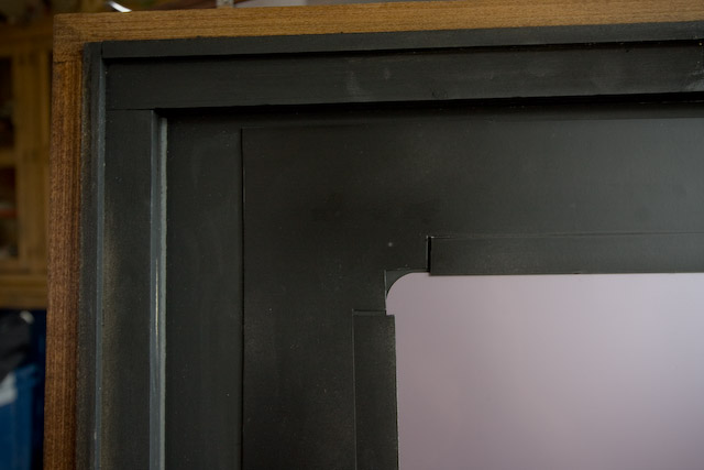

A little peek at the holder
Here are a few shots of the cameras back side, and holder.
My concept was to be able to use any size film up to 14x14, and to make it easy to load, and build. I did not want to have to slide the film in and out. And more importantly, I'm too cheap to spend 300 bucks on a holder. And in a pinch I can bake dozen cookies on the darkslide.
After a few 8x10 test shots yesterday, I'm going to call it a success. You just fold up the flaps, lay the film down, and fold the flaps back down.
The septum is a 29ga piece of painted steel, and the little thing holding the film in place is a mask made of magnetic sign material. So if I want to change formats, just change the mask.
I'm done now. :D
Oh, and thanks everybody who kept me inside the lines.
