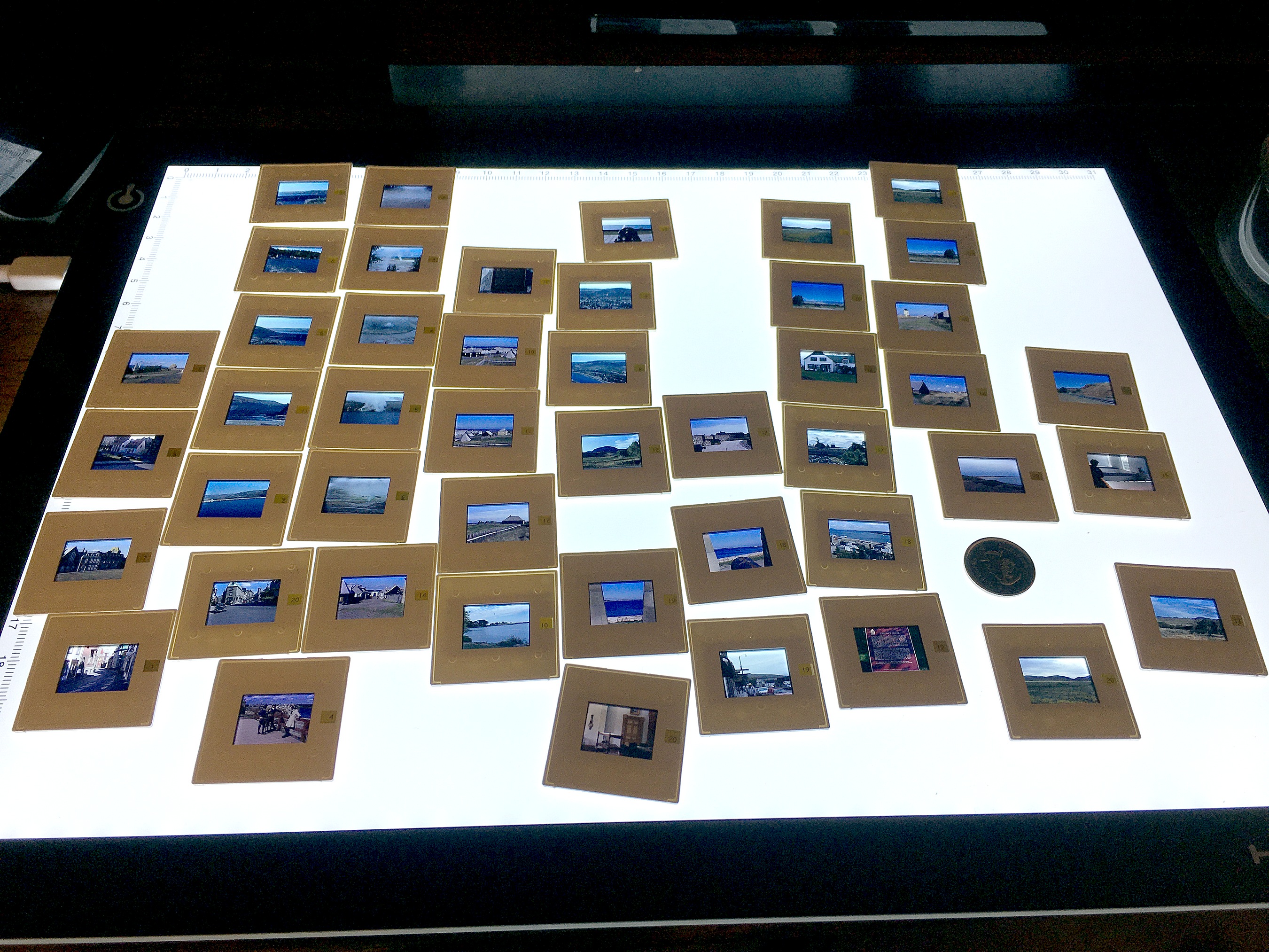

Today I was going through and editing some of my Dad's Kodachrome (+ 1 Ektachrome) slides in pocket mounts.
These are, I believe, all or almost all from 1983, and I expect came from his Pocket Instamatic 60.
Unfortunately, the Kodak Pocket Carousel projector that I was also using gave up the ghost part way through. I guess it had sat in storage a bit too long between uses. Remarkably, the bulb still works fine.
The coin you see there is a Canadian 10 cent coin which is almost exactly the same as the US variety.
They looked great projected about 3' x 4'.
Slick 13x17 mounts... a window for the frame numbers and everything. I don't think I've ever seen one of those before.

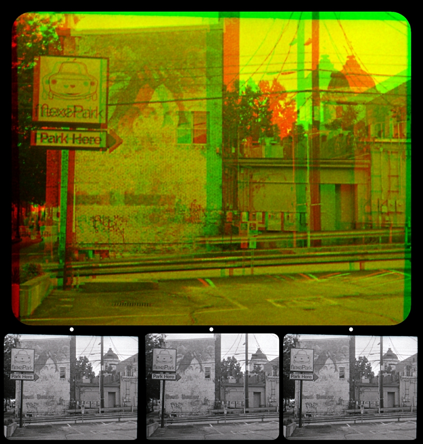

Playing with StereoPhoto Maker and 10x14mm hyperstereo pairs from the Minolta 16ii. SPM is one of the best pieces of niche free software I've ever encountered. Lots of customizable presets for things like printing stereo cards or a 'universal' image as below.
Anaglyph on top and L-R-L for standard or cross-eye viewing.
