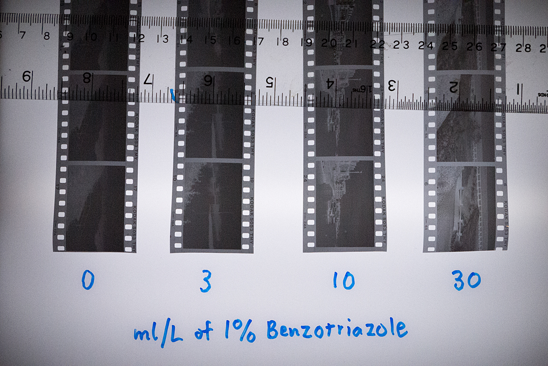

Attachment shows effect of adding 1% Benzotriazole solution to 20 year old T-Max 400 all exposed at EI=100 and developed in PaRodinal 1:50 8min 20C.
What is a good combination of ml/L 1% Benzotriazole and increase in development time?
10ml/L and 30% increase?
Thanks.

The amount is listed below each strip as ml of 1% per Liter.
Background fog, especially with negative film and at these low levels, is no show stopper. Can you see to which extent shadow detail suffers at the higher BTAZ levels?
Alan Johnson: I do not think that you can have your cake and eat it also: with the fog, also goes the shadow detail. Expose more. Read:
You have to remember that when using restrainers, the film speed drops. Think of it this way: age-fog is in the same category as the toe on the characteristic curve. Thus, emergent shadow detail becomes the target of suppression, as does the fog, itself. That is why routinely adding restrainer to developers can be self-defeating with fresh film. The negative's base will look great, but the speed (thus shadow detail) will be compromised. The ONLY way to separate such emergent shadow detail is to elevate that shadow detail upon the characteristic curve.
That said, old, foggy film needs this restrainer boost. If, ultimately, you can use such film, productively, and not have to throw it out, who cares if the speed drops? Here is what I do. I cannot prove that this is theoretically valid but, for me, it WORKS.

I note you use 50ml of 0.4% Benzotriazole solution (with other additive) which is equivalent to 20 ml/L 1% Benzotriazole solution in my attachment series.It can be seen that this would reduce the fog more than the figure of 10ml/L 1% Benzotriazole I first mentioned.

p188 He developed 4 years out of date Tri-X Pan in D76 1+1 with the equivalent of about 3 ml/L of 1% Benzotriazole solution on my attachment.He concluded that with film it will print just as well without Benzotriazole but noted that eventually a fog level will be reached where this is no longer true.
He did not investigate film that was more out of date than 4 years.
Old films with 1% Benzotriazole addition seem to need longer development.
I developed FP4 (discontinued in favor of FP4+ in 1990, date year of my film not known) exposed at EI=50 in Xtol 1+1 with 20ml/liter 1% Benzotriazole addition.
Double the normal time of development (from the massive development chart) was needed to give normal density and a good result.
I have an incentive to check this as was given a box of 60 HP5+ dated 2002 stored at 60-80F.
As its speed will have dropped I push processed it thereby hoping to restore it to box speed. Developer was Xtol 1+2.
The attachment shows the result without and with Benzotriazole addition.
The "without BZT" is more fogged but has more shadow detail. I obtained a good print from it, in spite of the fog.
So it seems best to omit BZT in this case, when wanting to push process to shoot at box speed.

The problem with using BZT with old film is that while is may decrease the amount of fog it also decreases the density of the negative. What Dr Henry found is consistent with this and also finds that it really is not needed. Since age fog is even throughout the negative you can just print-thru it.
