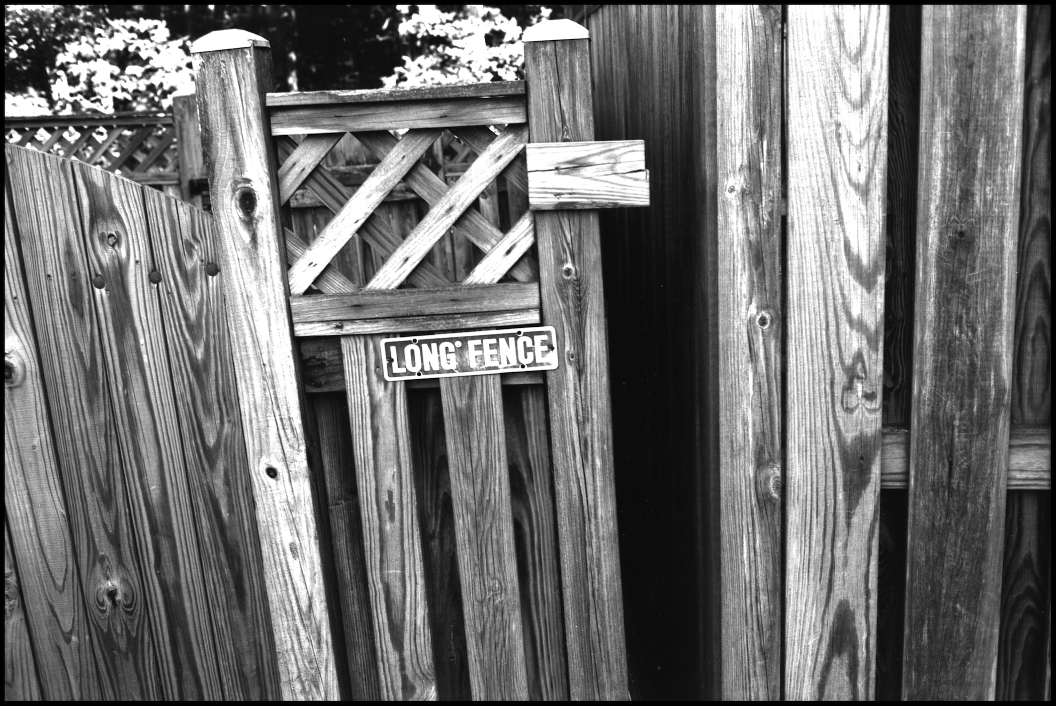

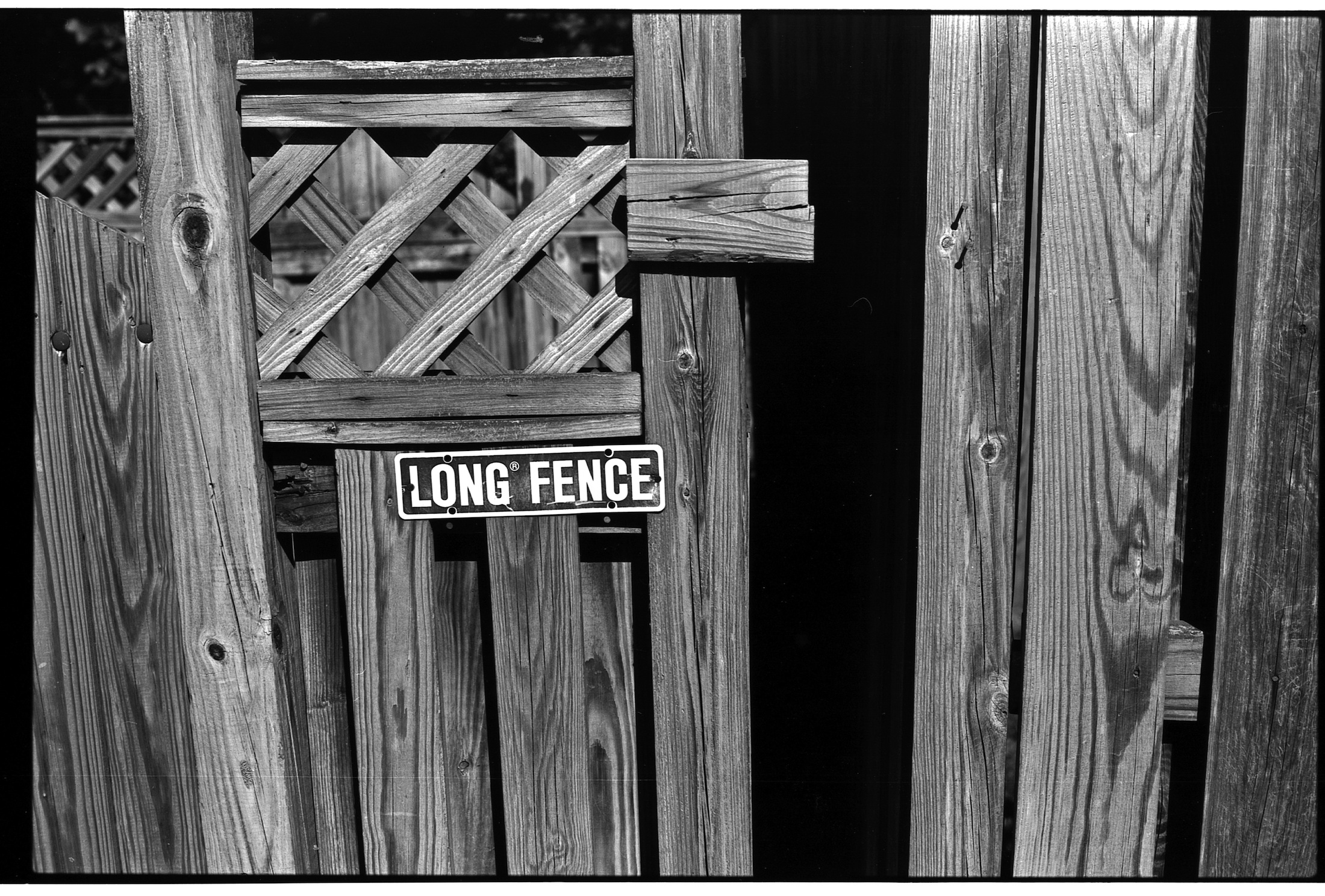

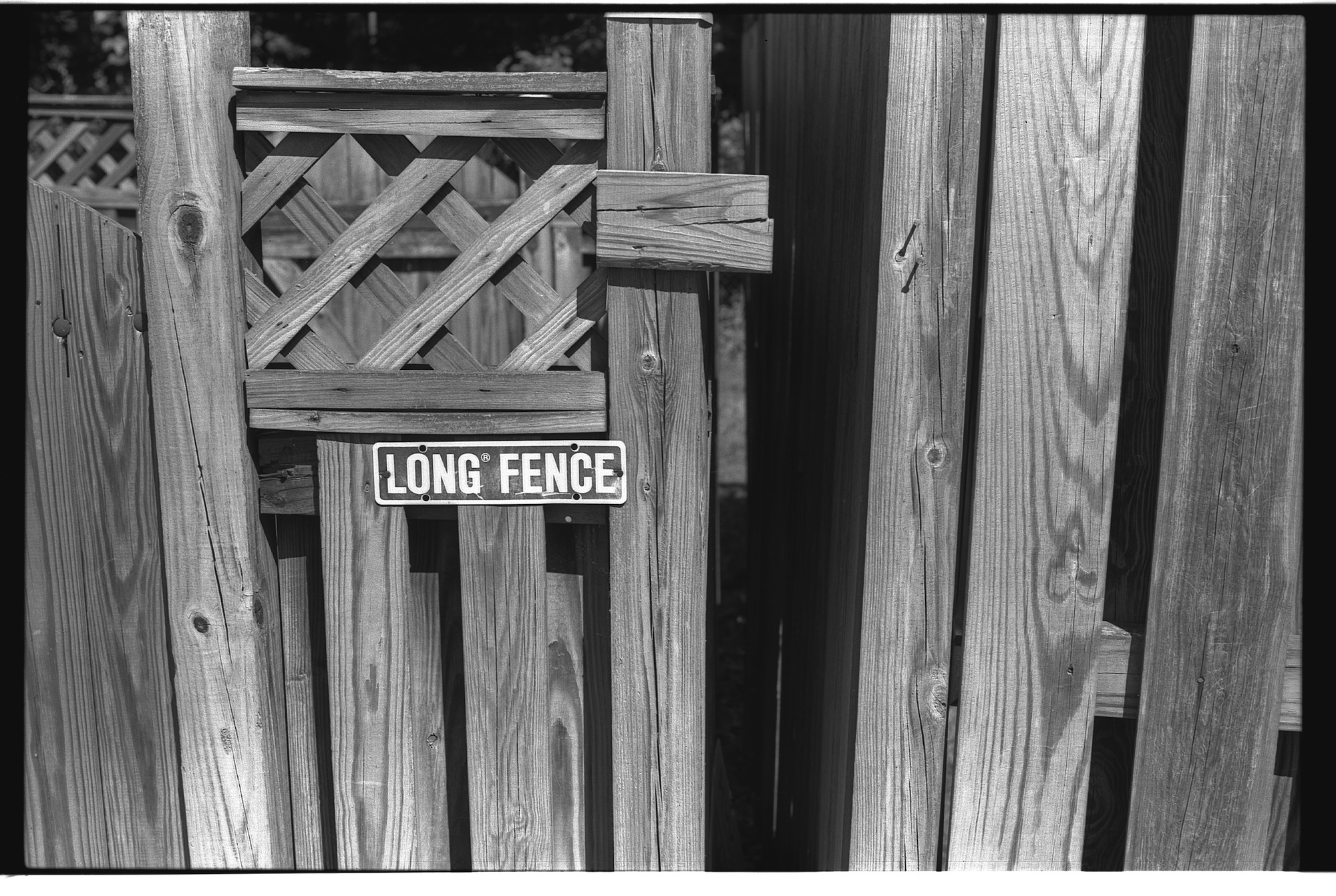

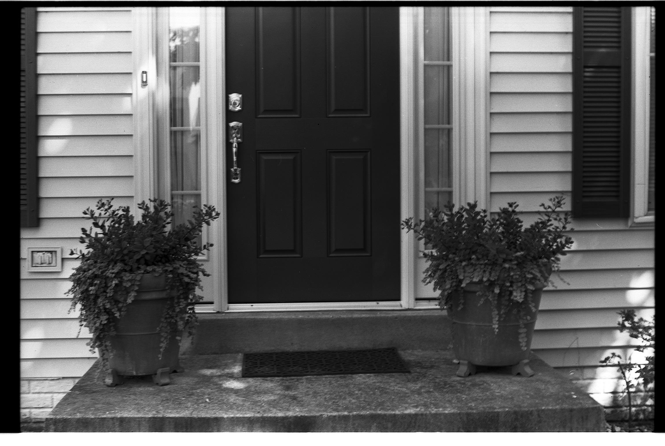

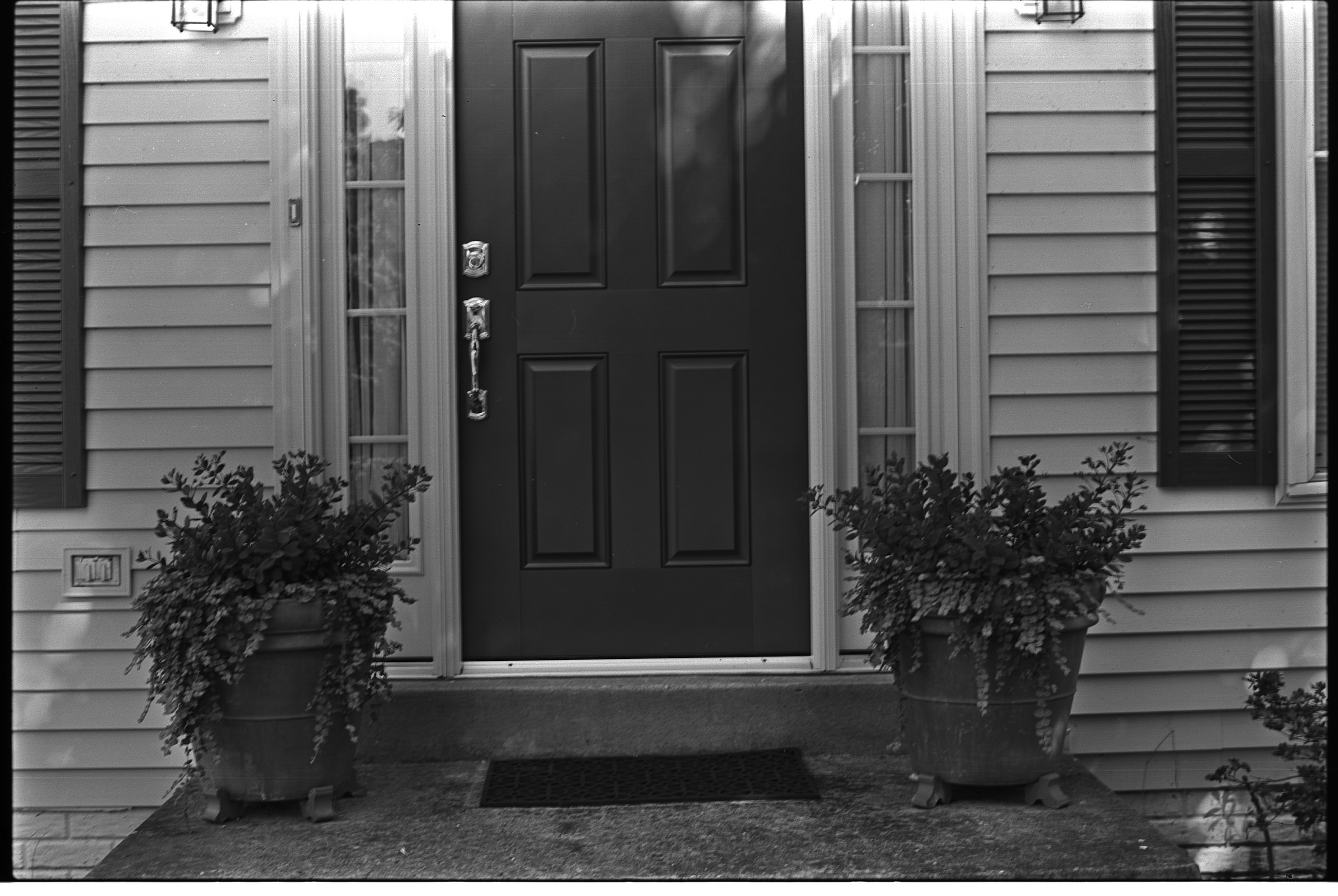

I dipped my toe in these waters four years ago when I first got the film, but haven't really done much work with it since then. At the time, I recall looking for info on the film and wound up believing it is a low-speed film used in some part of the cinema process; I couldn't find any documentation on it. I do recall that one clue was the size and shape of the sprocket holes; there are websites that show them all, so one can look there and try to suss out what it might have been used for.

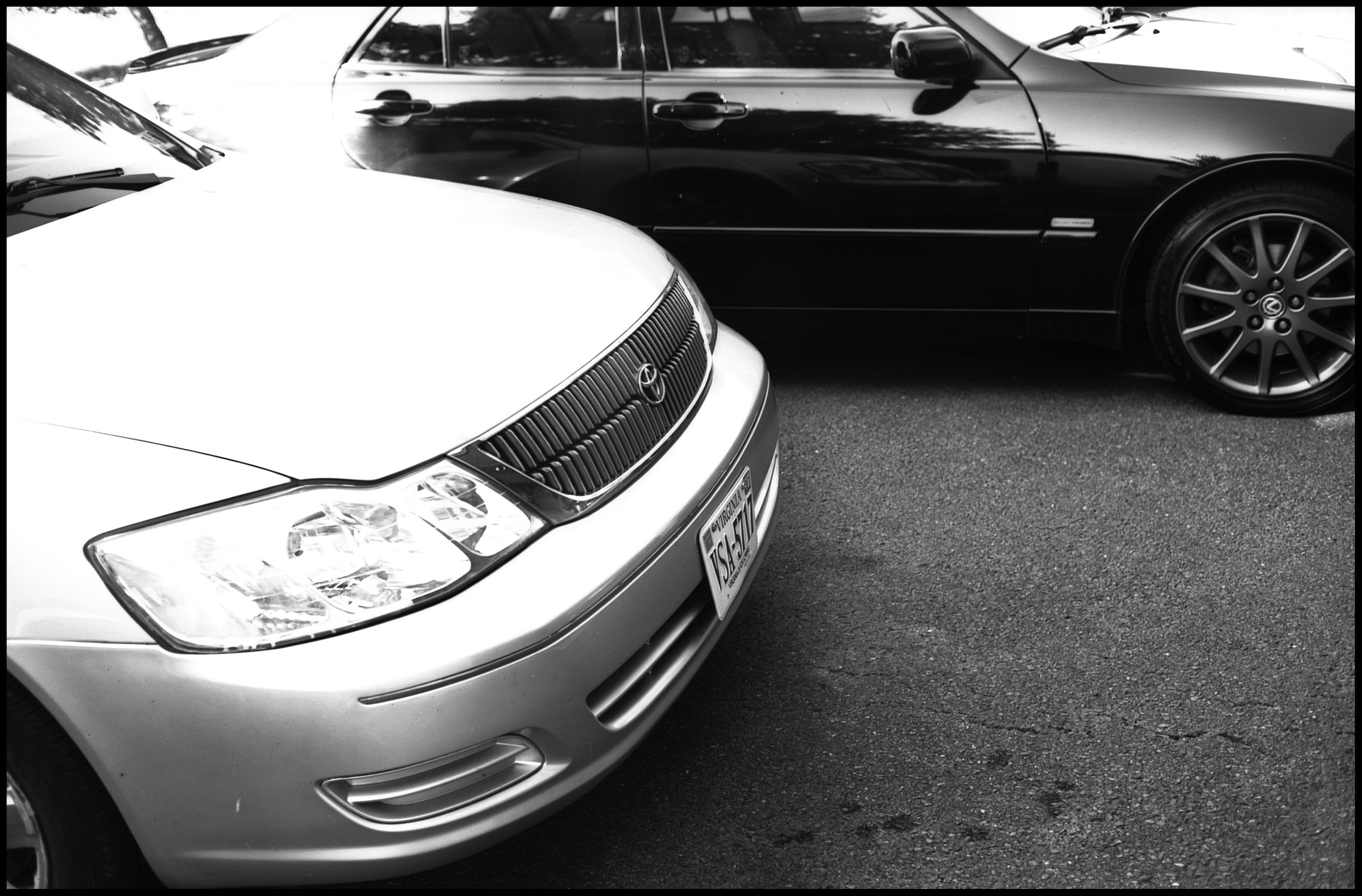

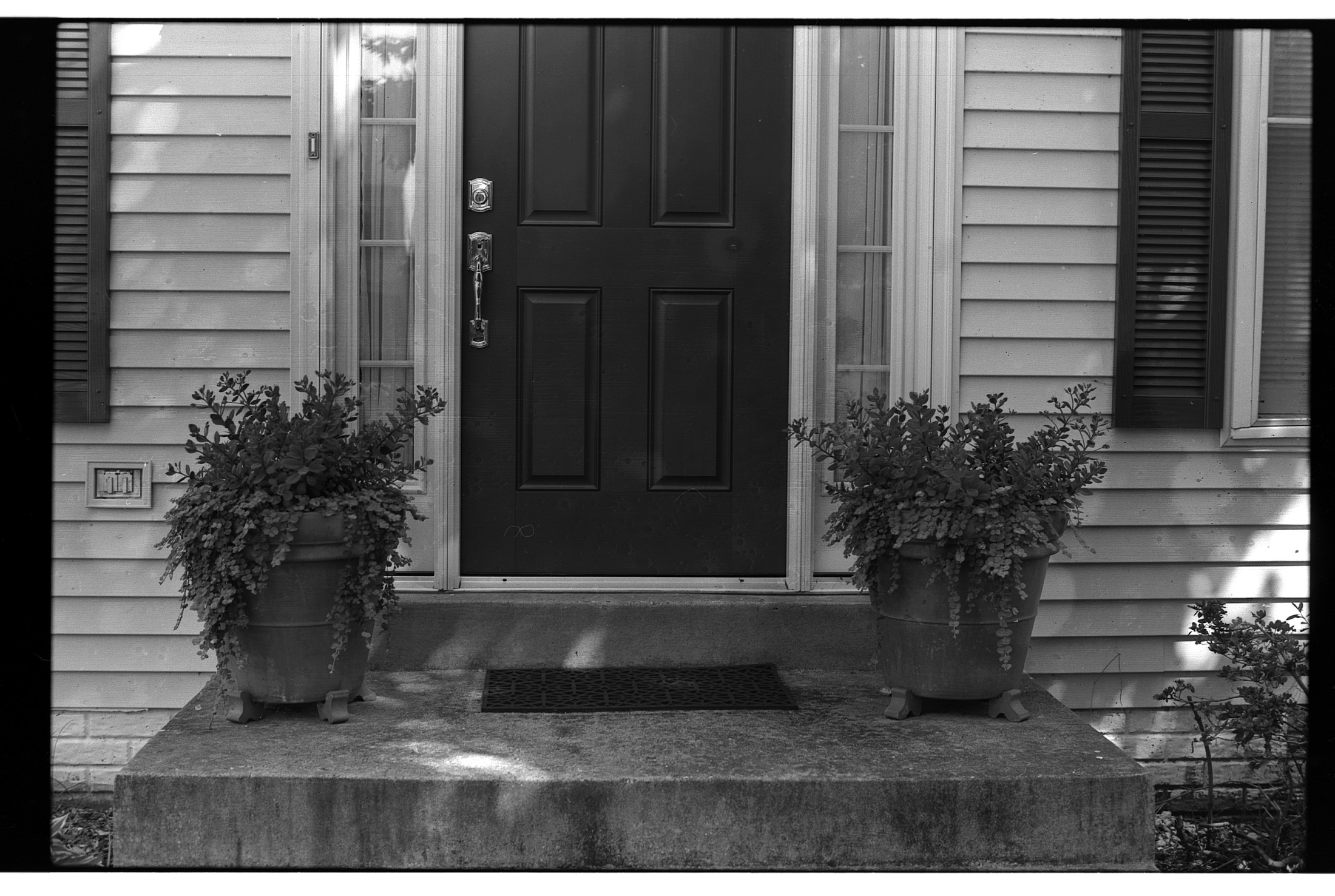

I have tried this film in three different developers: Technidol, 510-Pyro 1:300, and Ethol UFG. I've attached a few photos with each. It seems that on a couple of shots I wasn't steady or the camera was acting up -- I may have been simultaneously trying out a Konica Auto Reflex.
You can judge a bit from the attached images. Clearly this film has extremely fine grain, and it certainly dries very flat. For the 510-Pyro I tried a series of exposures at ISO 12, 25 and 50; with the UFG (5 minutes at 24C) (yes, Auto Reflex w/40mm lens) at ISO 25, 50 and 100; with Technidol (7'30" at 26C) I can't find any further comments in my notes other than I thought UFG gave better results than Technidol, despite in some cases being rather blown out.
I've attached some images that you might find useful. In a certain sense I think UFG (no longer produced) has, at times, a tonality that's a bit more appealing. (BTW, in the Technidol photo of the front door, note the mottling visible on door -- I can only wonder if Technidol has some problems with this film.)

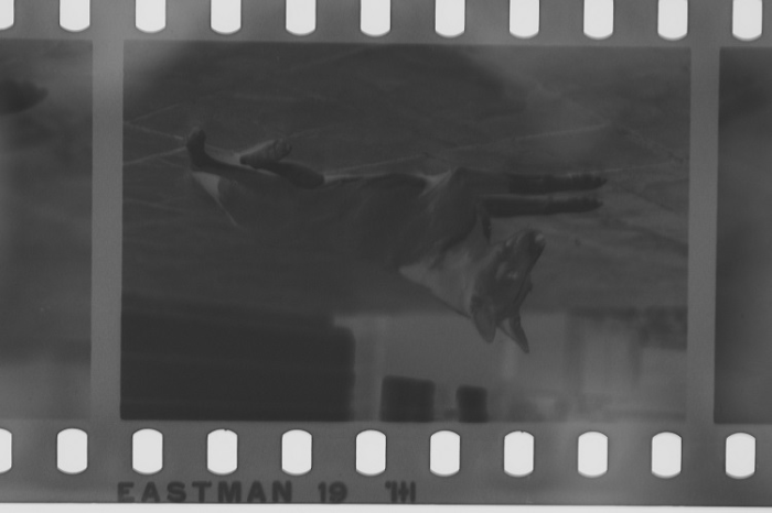

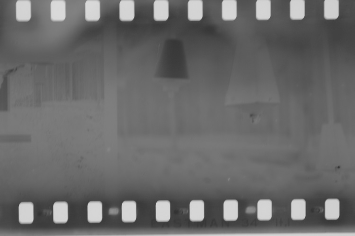

I recently bought a few bulk rolls at a garage sale that both turned out to have Eastman in the edge markings. Both are black and white film. One is Eastman 34 with Kodak Standard perforations. The other is Eastman 19 with Bell and Howell perforations. I contacted Kodak to try to find out what type of film it is, they had no idea. They did mention that Eastman designation is for movie film. They also have the movie film date codes for the manufacturing date. These rolls were both manufactured in the 1960’s.
Could it be the intermediate film they used for travelling matte shots? These sequences required very precise registration, so might have been done on equipment with standard perfs. (I've seen this equipment, but don't remember what the perfs looked like.) That would explain the high density and slow speed.

The image provided by “BAC1967” shows a “EASTMAN 19 and a strange set of symbols”. This edge print was applied at slitting on all 35mm length films (Professional 100’ roll lengths, all motion picture, cine-fluorographic medical films, surveillance films, microfilms, and any other 35mm film during the 1950’s through the mid-1990’s. The “19” does not specify the product number, nor does the “6”, “34” or other numerical numbers following “EASTMAN”. That number is the slit number from the cut master roll. The strange pattern of dots, lines and “+” symbols following denotes the slitter which slit the film. It is nearly impossible to determine the specific film without the product’s complete packaging because Kodak was not edge-printing specific product information onto the edge-print until the implementation of Keykode numbers in 1989, and that was strictly for the Motion Picture panchromatic negative and intermediate products. Eastman Color Print film, with is specific products is the only exception to this because the slitters which slit this film were customized to print “LPP” or “LC” during the 1980’s.
Consumer/Professional products 5060 (Panatomic-X), 5062 (Plus-X), and 5063 (Tri-X) all were manufactured for sale in 100 ft. rolls as well as offered for different customer uses in both Kodak-Standard (KS) and Bell-Howell (BH) perforation formats, and all were finishing over same or similar finishing equipment making specific product tracing very difficult, if not impossible from that era of film stocks.
So in essence, you can't tell from the edge print with film of that vintage.
