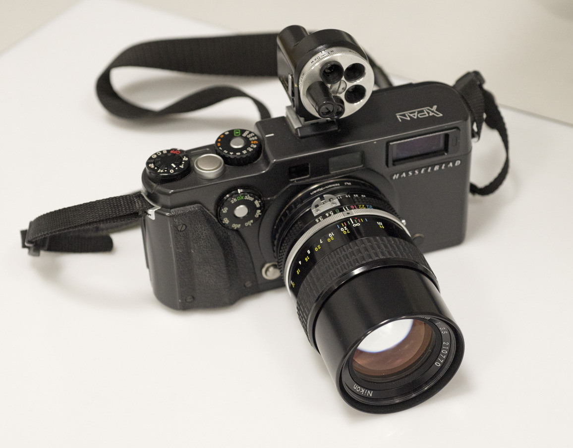

With your adapter various Nikon lenses could be fitted to an XPAN - with more of less success. Perhaps the most commonly used lenses would be Nikon PC 28 and 35mm lenses. Typical problems, beyond the obvious one of non-rangefinder coupling, would be insufficient covering power or mechanical vignetting. The XPAN body has baffle plate just inside the mount, also the dedicated lenses all sit relatively close to the film (compared to a reflex camera). On my 'adapted' XPAN I have tried a Nikon 135mm f/3.5 which works very well, apart from mechanical vignetting reducing the frame width to 50mm or so. I also have a Russian made revolving turret viewfinder for focal lengths 28, 35, 50, 85 and 135mm to aid composition. I should imagine your 24mm shift would work well - but you may not get the full 65mm frame.
