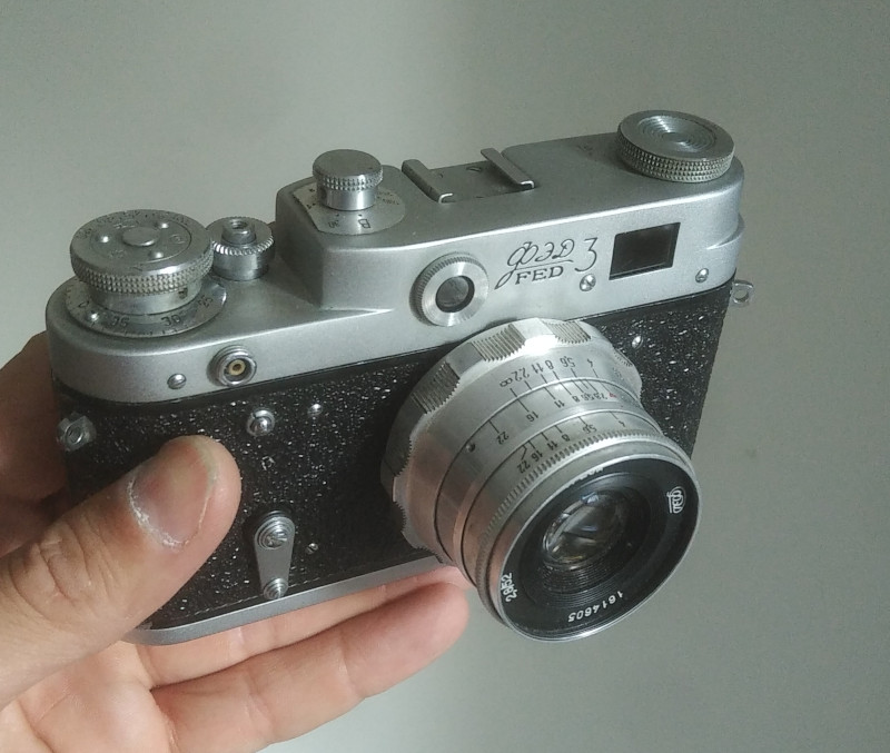

I have a Fed-3 first version (Fed-3a) I bought the winter just before covid-19 set for 1500 rub ~ 16€ in SPb. it's still knob, so still stepped top since no need to accommodate room for the wheel and spring under a lever, it has the strap lugs.
here is the Industar-26

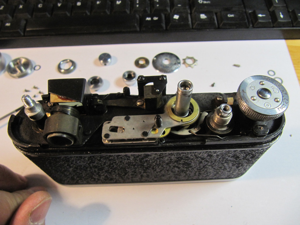

so it was jammed, no big deal just fix it. I recalled this thread and took couple snapshots.
here i already removed the top, and show what was the problem, you can see curtains stuck closed, shutter button triggers nothing:

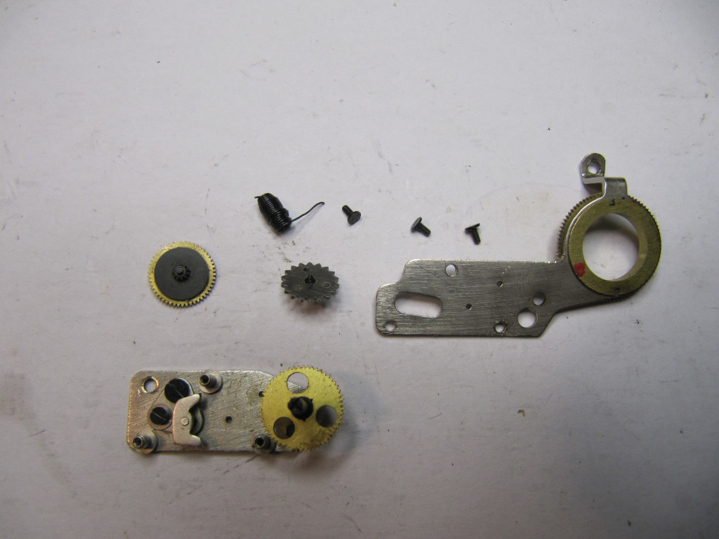

under the top, the slow speeds mechanism is the part with a brass wheel on its right end, around the main shaft:
a short overview : the fast speeds wheel with slow speeds clock removed, the curtains movement with triggering lever of the 2nd curtain, the RF mechanism, the diiopter adjustment, and the slow speed mechanism:
see? it's beautiful in simplicity. If the parts were to specs at the factory, this just works and works and works. Repair is easy, just be cautious not to bend something even slightly.
the slow speed clock is also damn simple, yet caution with tinkering that can throw off the timing (not overdo the spring, wheels alignment, screws tightness, planarity )
in this case unscrewing the slow speed clock reset the mechanism. Done, jam fixed. While I was there I did some more unscrewing in order to check cleanliness and do a bit of lubrication. But this camera was in very good shape anyway.
this mechanism is common with the Zorki. There are slight differences. As I have a Zorki-4 dismantled for cleaning and lubrication, in order to show the level of compatibility, here I have put the slow speed mechanism of the Zorki-4 on this Fed-3:
a fast speed, involving only the lower notched wheel and no action of the slow speed mechanism, then a slow speed and you see the delay clock at work. Here still the slow speed mechanism of the Zorki-4, it's shape is a bit different and it lacks the leg/support of the one for the Fed-3 (Zorki-4 uses instead a hook around main shaft):

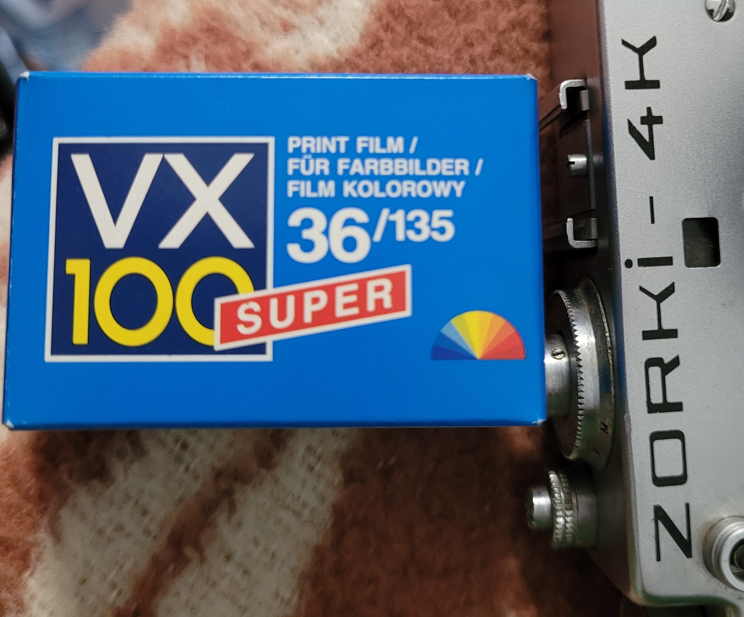

Hey, I got a Zorki-4k camera from my grandfather. At home I found a film VX 100 36/135 made by konica minolta... Can I use that filter on the camera? How do I know what film is for what camera, is it the same? Thank you!
For your Zorki camera you can use any film that got that "135" designation as on that box you show. This stands for the type cassette with film this cameras takes. It is the standard type of cassette you can get everywhere where they still sell film.
The figure before that 135 shows the number of photos you can take with such film. Standard is 36, but you may also find 24.
