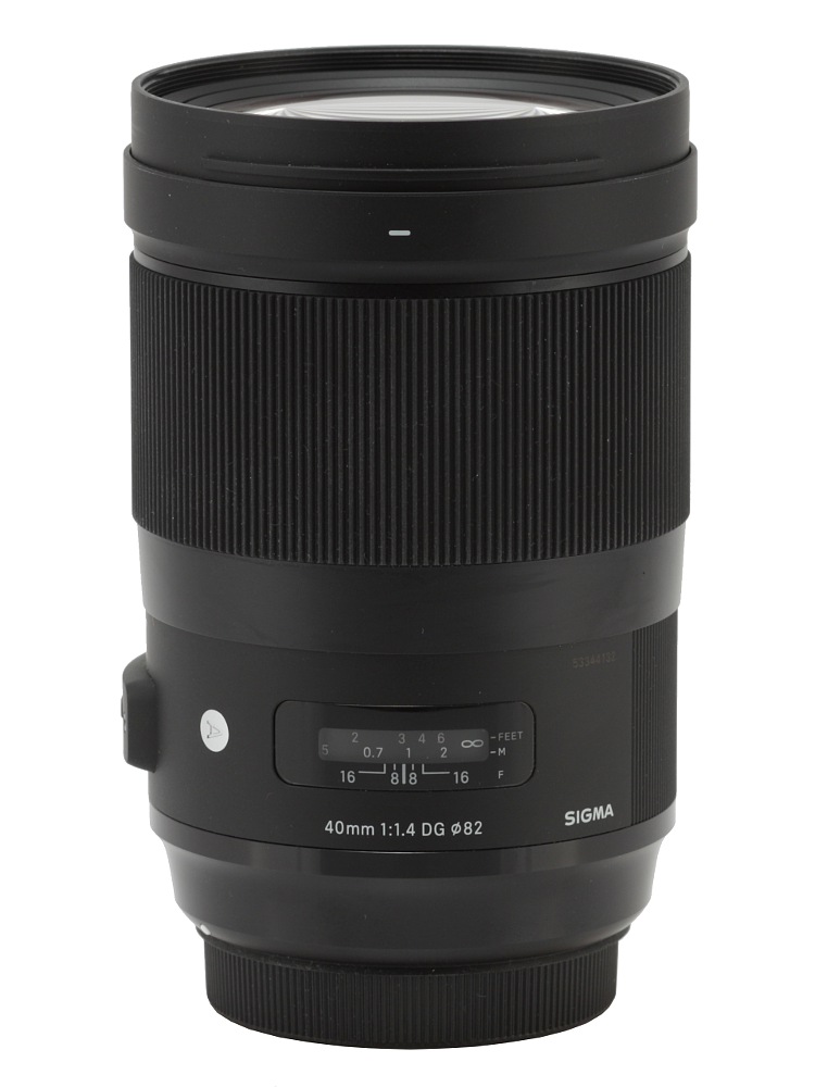

I think the market is broad enough to encompass both trends. A kit 50 from 40 years ago was heavier and in many cases better built than a kit 18-55 today. But there is also an obsession with high resolution MTF designed lenses, spare no expense or size. My old pentax 40mm ƒ2.8:
The new Sigma 40mm ƒ1.4:
Ok, it's two stops faster, but that is another trend in lenses at the moment. I also wouldn't assume that plastic is worse--there are very well made lenses in plastic housings, and cheap metal lenses.
