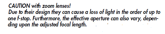

At a current flash manual from Metz I found this puzzling remark:

Not quite... I just checked current tests. A Canon EF 70-200mm F2.8 was tested at T3.3, thus half a stop loss.
Other current zooms were tested for losses of over one stop.
With so many elements it would really be unusual for 'no light loss' to occur. Much reason for of the stated f stop is due to marketing, and there is a legal leeway allowed. It is amazing that they perform as well as they do. Flare is the main culprit and it diminishes the speed on zooms more than on fixed focal lengths. - David Lyga

A Canon EF 70-200mm F2.8 was tested at T3.3, thus half a stop loss. Other current zooms were tested for losses of over one stop.
Interesting. I thought the distinction mattered only for movies to ensure perfect homogeneity between scenes. But this means that with a zoom, you have better use the in-camera meter, that will be fooled into thinking that the scene is not quite sunny after all, and expose accordingly. OTOH, I don't use zooms.:cool:
