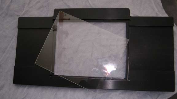

I have two pieces of Denglas, hinged at the back, drilled on one side with two holes, matching pins on the other (setup mates with my existing Kodak film punch) and a set of matte-black masks from 35mm to 5x7 (actually 13x18cm). For casual printing, I put unpunched film up against the pins, close the sandwich, and put the mask on top of the upper glass plate. I've used it for many years with no complaints.

It looks like the photo below come with optical glass. They are custom made I have one available for the type II enlarger.
This is the one I had Richard make for me. It works well, but if I were designing another one, I would incorporate alignment pins for my Kodak punch, just as TimVermont has done.
I seldom do masking, but when I do I use a setup similar to what TimVermont uses.... one piece of glass with a pin-set taped on, and covered with another piece of glass which is slightly narrower to miss the pin-set.
