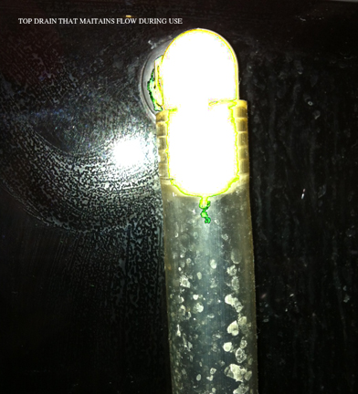

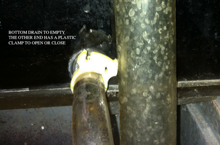

My Zone VI 16x20 came with a drain. It is a coupler-type fitting that holds a vinyl hose that has a clamp to close/drain it. This way it can be on the counter top and empty into the sink.

That's a better arrangement than the simple drain on mine. Without a drain hose, the drain is really only useful for draining within a sink or getting the last bit of water out. Can you upload a photo of your drain?

The pictures were taken with a phone but should give you an idea. I didn't have time for more elaborate photos -- heading out of town in an hour.
http://www.jeffreyglasser.com/
Those photos work, thanks.
The top is standard. At least that's what I've seen in all the ones I've looked at (a few in person, most in photos). Mine has a simple, neatly drilled hole in the bottom with a plug like I referenced.
I'm not where my darkroom is right now but, if I recall correctly, you can't access the inner side of that outer plexiglass due to the glued in inner wall. So any drain fitting would have to be glued in.
