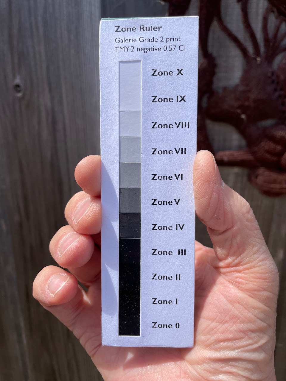

In terms of those Zone labels, with each shade of gray allegedly corresponding to a single discrete interval of one stop, well, the flaw in that kind of model is that films differ in their dynamic range. Ole Triassic X Pan was kinda middle of the road, while some films have a shorter scale, and some a longer one. I shoot a lot of TMax, which allows distinctly more shadow value gradation than Tri-X. "Straight line" 200 films like Super XX and Bergger 200 allowed even more, while Pan-F has a quite restrictive range. So in theory, you'd need a different Zonie dial grayscale for each respective category, not to mention color film characteristics. Just leaving the dial alone and using it as is does it all at a glance; but to each his own.

What turned me off those stickers at the git-go was that the stickers seem to assume that a zone is the same tone throughout the whole zone...when it should be a continuous scale...not separate discreet tones. The sticker does not match reality, so it just seemed silly to me to have on there.
Which makes me wonder -- is middle gray in the middle of Zone V, or at the beginning of it?

I put these patches on my exposure meters when I make Zone Stickers.
Not trying to be precise or accurate. Just checking the scene and asking myself: “If the reading I took came out like that on the print, would I like it?” How would I like it? Turn the exposure calculator to “place” the reading and walk about looking at other things. If I get a setting where everything important will be an acceptable print value, great.
Otherwise, think.
