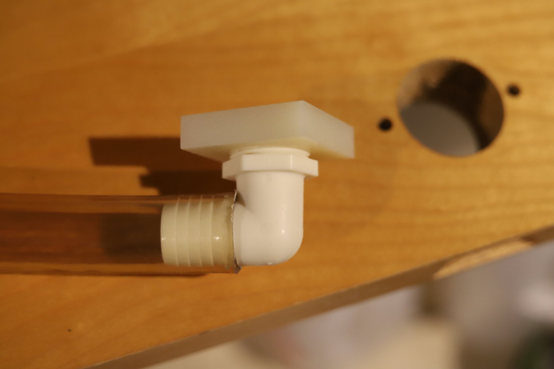

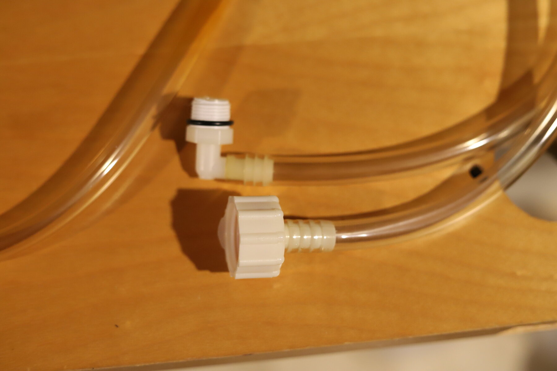

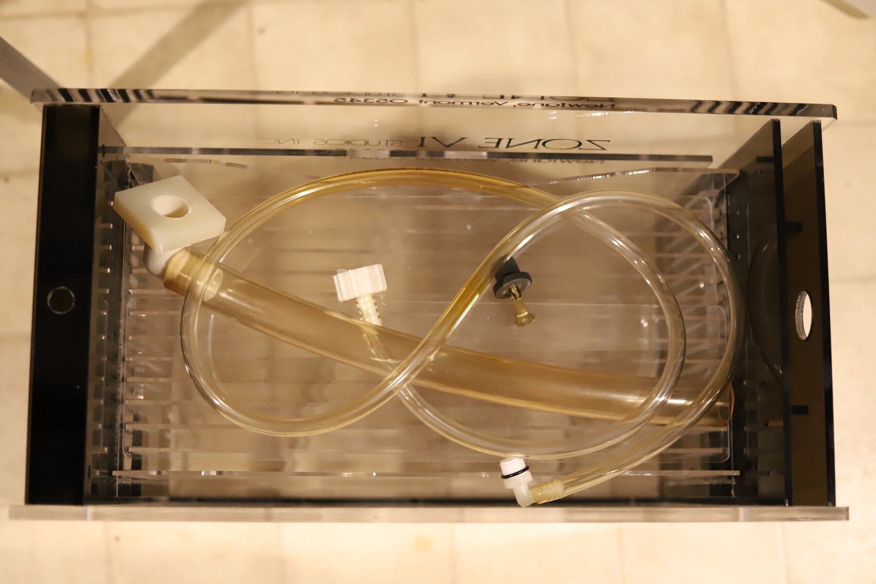

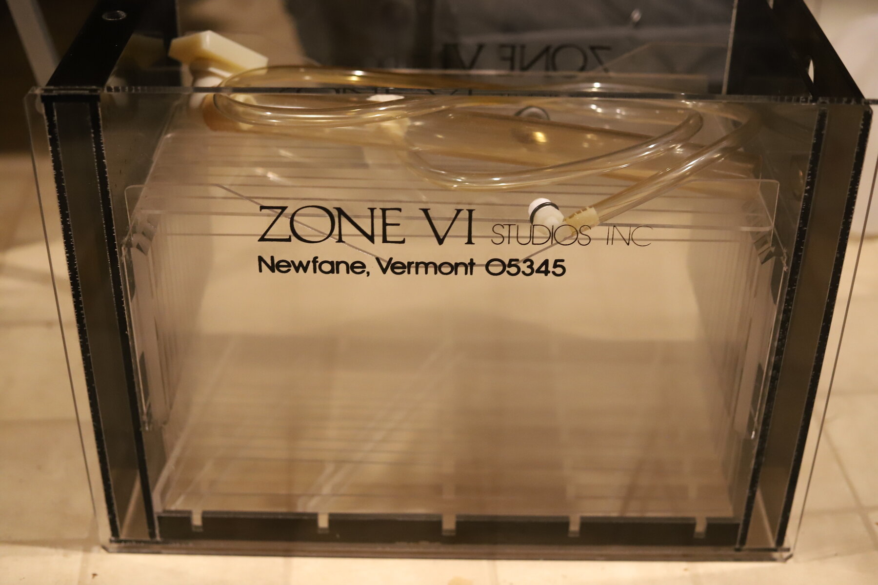

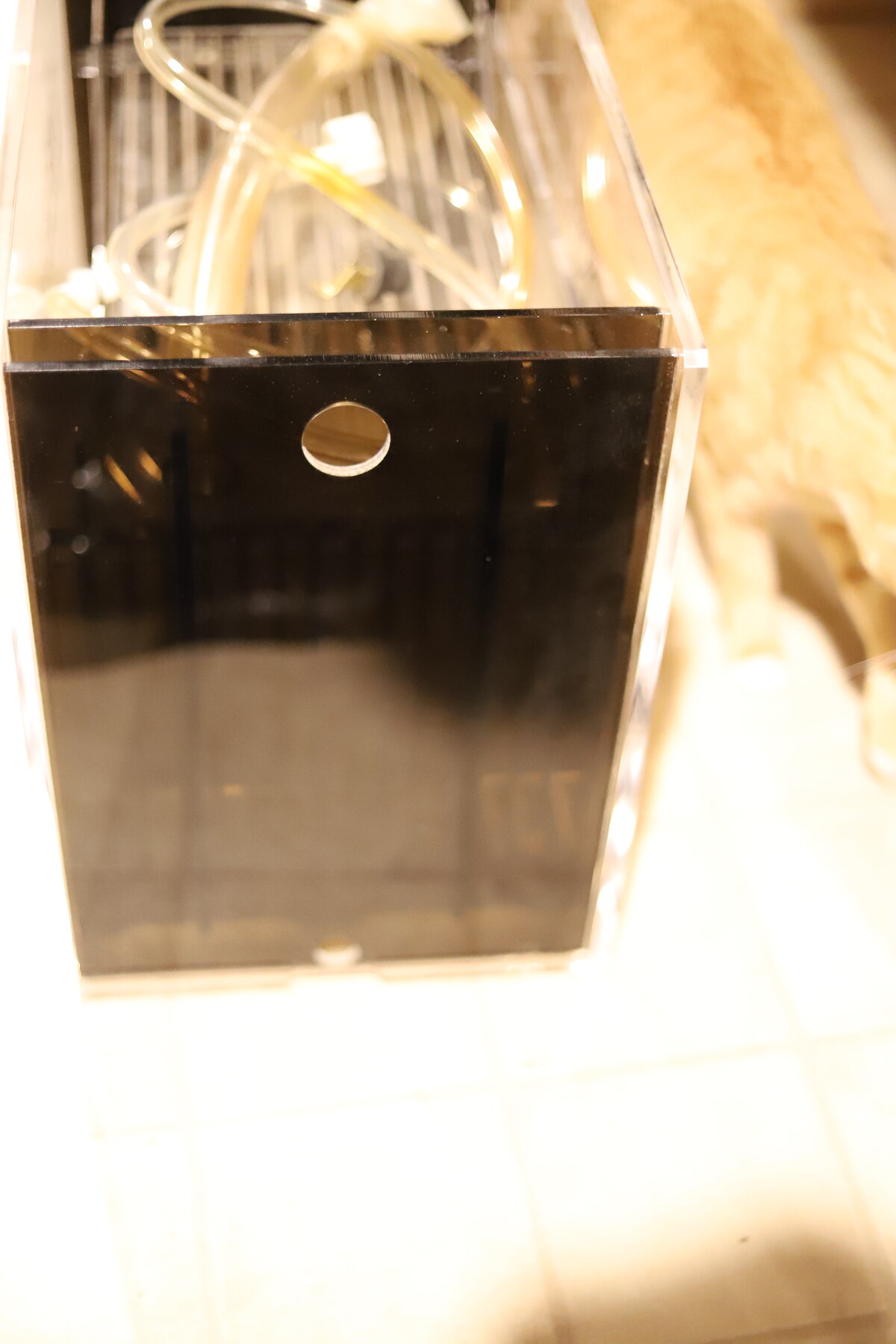

It turns out that mine is an 11x14. I highly doubt the design changed a lot as the size scaled up. You are correct in that water enters the top right and fills the narrow chamber first. The water then gets into the main wash chamber through a bunch of holes. On my sample it seems like there is one small hole per print space and a couple of larger holes to simply help with flow.
Most of these are designed so that the overall water flow is slow and gentle and simply overflows the print area and exits into the left chamber. I don't have the Fred Picker details for this device, he may have had ideas regarding the proper flow rate. At the schools and workshops I have attended they erred on the side of just enough flow to function properly.
