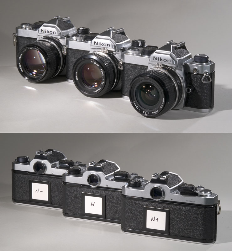

I have posted this before, but to support David's proposal, here it is again:
I bought these bodies two years ago (excluding lenses) for less than $300.
