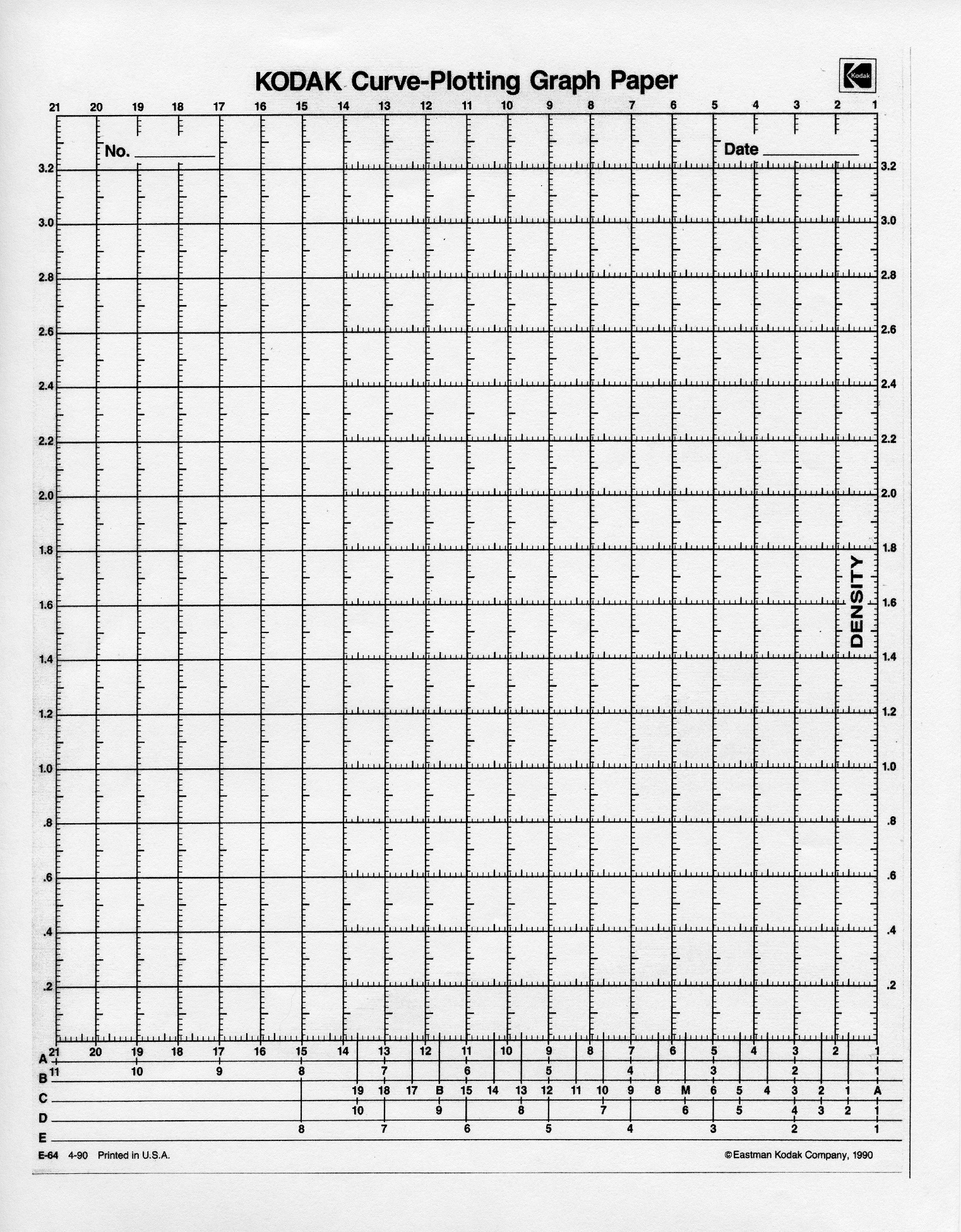

BTW, I have good a good quality scan of the (blank) "Kodak Curve-Plotting Graph Paper" form if anyone wants a copy...

No, here it is in reduced resolution:
Oh, yes please to ******** or post it here.
{Moderator edit: please don't post personal email addresses in public posts. The Private Conversation system is ideal for that.}
Oh, yespease to rlambrec@ymail.com or post it here.
Will what I posted do or do you need a larger file?
I made an absurdly large scan of it but reduced it 75% for the above posting.
EDIT: OK. Let me know if it's too low in resolution and I will email a better copy.
I'll be looking forward to your email.
