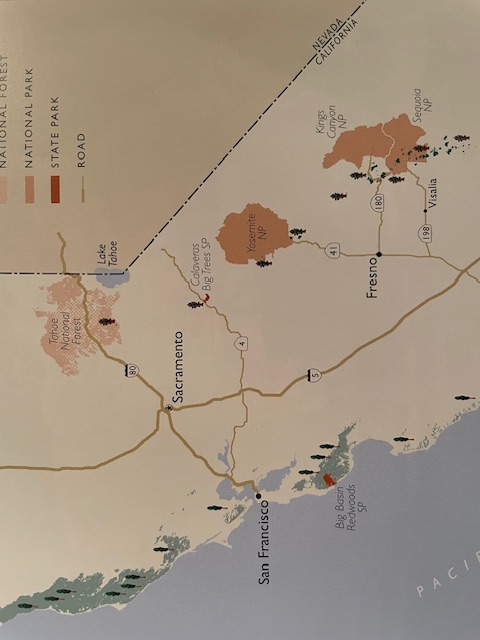

If you take a map of California and turn it sideways with LA on the right.
And imagine the plot of individual Giant Sequoia trees as individual Time-CI plots.
The tone reproduction theory based exposures will be in Tahoe, Ansel Adams would be in Yosemite (where he rightly belongs) and William Mortensen would be in Sequoia-Kings Canyon (where I lived and met the author of the book this picture comes from, Mike Law “To Find The Biggest Tree”).

No. I grew up right in between Yosemite and Kings Canyon. William Mortician-sen belongs in smoggy LA making B horror movies, not in our mountains. And the "biggest tree" depends on whose measuring convention takes precedence - that of the Forest Service (diameter of the trunk eight feet up), or that of the Natl Park Service (cumulative board footage). By FS rules, the biggest tree is in a seldom visited grove not in any NP; and the reason for measuring 8 ft up is so trees like the Bay Fig, which greatly spread out their root system slightly above ground, don't get factored.
A better analogy would be to stand at Yucca Point and take a gander at the greatest canyon drop in North America, with North Palisade and its glaciers comprising Zone VIII over 14,000 ft high, and the depths of the canyon clear down around 1000 ft approximating Zone II. Then try placing a sticky segmented gray scale on a ridge all the way up to the top of Spanish Mountain directly across the River from Yucca Point. Yeah, above timberline it does get lighter gray, and lower down, where forest fires have done their thing, it's distinctly blacker. Where black bears fit into the tonality scale is harder to say; they keep moving, so it's hard to meter them.
Be nice Drew. Mortensen isn’t the only photographer to reside in by LA. Weston and Adams passed through. Curtis stayed. I visit with him and his family on a regular basis. 😂

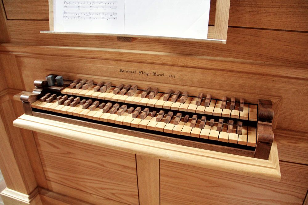

A good analogy would be with the piano. It's divided into twelve equal steps—semitones—, but it could have been more (there have been keyboards with 19 tones, 31 tones, and more), or, as in Indian ragas, much less. And the twelve steps have not always been equal; only in J. S. Bach's time was the equal temperament developed. And it was so for practical, not natural reasons: it made it possible to modulate from any key to any other key.
Now that the equal temperament exists does not mean that every instruments follows it exactly. For a violinist, for example, an F sharp is not exactly the same as a G flat, even though they are the same key on the keyboard. Same goes with the zone system : it's not because you have ten zones on the film or on the print is limited to ten zones.
A good analogy would be with the piano. It's divided into twelve equal steps—half-tones—, but it could have been more (there have been keyboards with 19 tones, 31 tones, and more), or, as in Indian ragas, much less. And the twelve steps have not always been equal; only in J. S. Bach's time was the equal temperament developed. And it was so for practical, not natural reasons: it made it possible to modulate from any key to any other key.
Follow-up to this, here's a modern recontruction of a 16th-century keyboard that had 36 keys per octave.
