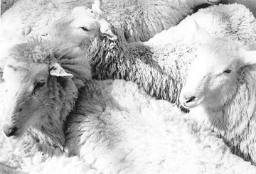

I'm at home at APUG, being technologically incompetent, as shown with the following mediocre scans. I don't do Photoshop, as a rule.
The rocks and water show good low value separation in the dark rocks (which may not come through on a screen), and high value separation in the white water (ditto whether it shows). This was a straight print - no burning or dodging. What you see in the final print is what the negative contained. Disgustingly easy to print, thank the Lord. Right ISO, right development time, close enough exposure in the field. I probably adjusted the print exposure down to 1-second increments to get the whites right. Ilford Multigrade, grade 2, 10 percent dry down factored in for final prints.
The sheep is from a 35mm negative exposed using the averaging meter in the camera. The whites are blown out - playing with Photoshop I can get no texture in them at all, which could demonstrate either oversxposure (wrong ISO), or overdevelopment (wrong development time). Or both.
Well, that's about the best I can do for examples, particularly lousy ones. Hope this helps a little

Bruce,
Thank you for providing these scans. I hope that you will permit my observations here. I would comment that in your rock and stream image, the one that you say is easy to print, that the local contrast is lacking in large measure. The overall contrast is almost there. Deep values to high values approximate the paper grade chosen.
But the image has no "life". The internal tonal separation in the low values is muted. It seems on my monitor that this condition also exists on the other end of the tonal spectrum The highlights seem to be blown out too. Is this a work print in progress?
How do you propose to get local contrast...the elusive glow to an image like this?
