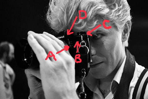

Nerd time - I reckon OM2 SP or OM4ti because hot shoe looks integral.

I know that in the article M-88 linked Denis O'Regan said that "For the entire tour I used my favourite ever film camera, the Olympus OM-3, two or three camera bodies and 135mm & 24mm f2.8 lenses" but in the picture (copied below for ease of reference) David Bowie is holding either an OM1 or OM2.
The give aways are (compare with photos below):
A - only the OM1 & OM2 had a flash synch socket (selectable between FP and X) high up on the side of the lens mount/mirror box, on the OM2SP, OM3 and OM 4 there was a PC sync socket at the bottom of the lens mount/mirror box and a 5 pin socket for use with the Olympus T-series flash on the vertical front face below the rewind knob.
B - there is no 5 pin socket on the vertical front face below the rewind knob (in the pictures below of the OM2SP & OM3 the 5 pin socket has the socket cover in place)
C - there is little in the way of a gap between the bottom of the rewind knob and the top plate; on the OM2SP the rewind knob sits a little higher due to the presence of the mode selector switch and on the OM3 and 4 the rewind knob is higher still due to the ISO selector and exposure compensation dial
D - the 'OLYMPUS' name is vertical and close to the top of the lens mount; on the OM2SP that section of the pentaprism housing slopes backwards, on the OM3 and OM4 there is a bigger gap between the top of the lens mount and the vertical face of the pentaprism housing, also there is no sign in the picture of the finder light window which sits above the 'OLYMPUS' name on the OM3 and OM4.

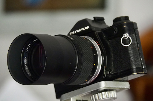

Olympus OM1N with 135mm f2.8 lens

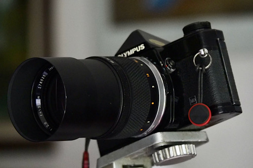

Olympus OM2SP with same lens

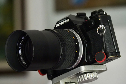

Olympus OM3 with same lens
Excellent OM nerdism!
I tried to do a little bit of that, but you were able to pull way more from the original image than I was.
Thanks Matt. 🙂
