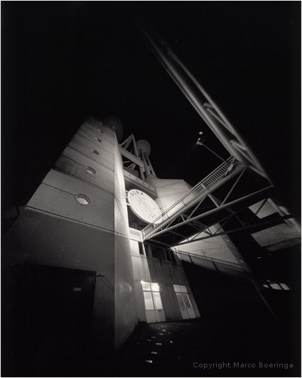

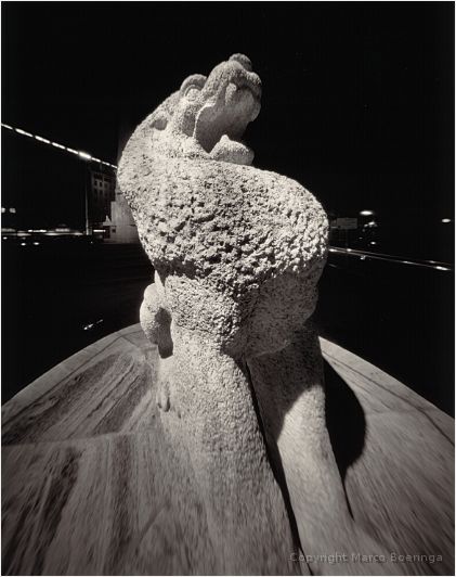

The 25 mm version can be a challenge, but like any focal length, you have to learn to use it and the results can be quite spectular... Here are a few photo's made with the 25 mm section alone. The nightshots took me up to 45 min exposure time, depending on the light situation, and that was using the low reciprocity failure TMax400! :surprised:.
WWII monument on Dam Square in Amsterdam:
AJAX soccer stadium in Amsterdam:
And here's a daytime shot: Rijksmuseum Amsterdam, where they house Rembrandt's "Nightwatch":
More photos here, all taken with just the 25 mm section:
